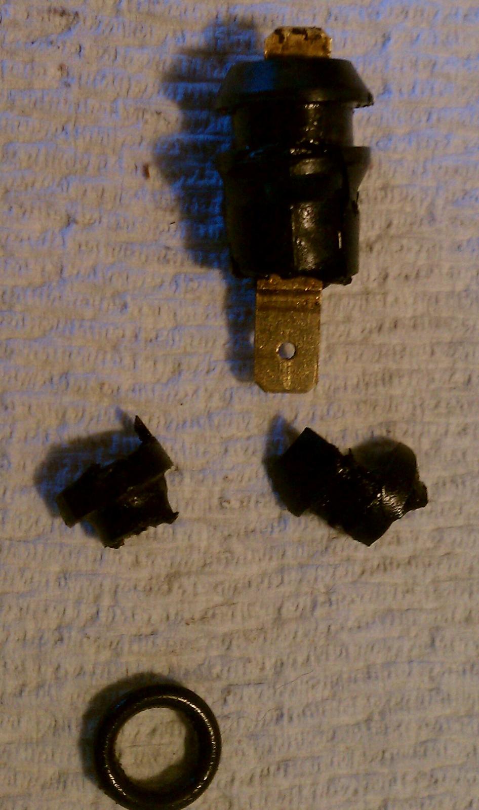

Ok, I've done some searching but only found one reference to this part. It has several different names on parts lists, but it's basically just a dual male spade connector to unhook the power to the kick down solenoid on a FI Automatic. Connector with O-Ring, and coupling element on later VW/Audi. Discontinued in 1994. I need to find another one to replace it as you can see in picture. Not sure if I can rig a ferrule or something but I came to the experts for assistance.

well pls tell me more about this part where it goes and function of why the o ring fitting. I'm somewhat about to delve into that area myself.

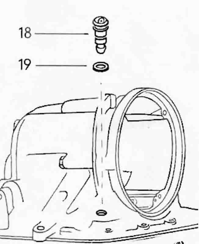

Looks like it's #18 on page 28/29 in this part book excerpt. Right click on "Group 3 - Transmission" on the page below and select "Save As..." to save to your local PC storage:
http://www.thesamba.com/vw/archives/manuals/type3_parts_book/
Then open it in Adobe and check out the two pages.
003 927 113
Connecting piece
I think it's the connection external to the case, connecting to the pigtail of the kickdown solenoid inside the case. The o-ring keep fluid from leaking out, since this is either immersed in ATF or will get ATF sloshed on it.

Options:
I'm not sure of the length, but the OEM "T-1" connectors (male-to-male connector housed in clear plastic) might make a good starting point. If you molded the body in silicone it might work.
The T1 connectors are this type with one male spade on each end. You can usually find them in the classifieds:
(Some of these are "empty" with no connectors, just the plastic. You want the metal parts inside, and would throw away the plastic sheath.)
Another thought is to make a 6-inch long pigtail with male spades on each end, and pot it into the case hole with silicone. Not removable but you can still disconnect it from either inside or outside.
In either case, it must be a type of silicone that will resist ATF, and you will want to provide a blob to act as a flange on both sides to keep it in place.
Or if you can make up a plaster mold from your old part, maybe you can make one of a stiffer plastic material you melt and add to the mold.
Keep in mind there are connectors on both ends merely as an aid to R&R. The function is just to connect the solenoid to the wire outside the case. Anything that can seal a pass-through wire will work in that place.

Yes, all it is, is an insulated electrical splice. There is no ATF pressure at that location, so the two concerns are that it doesn't ground to the trans case, and it doesn't allow the ATF fluid to leak out. Another option would be to thoroughly clean both the trans hosing and the connector body it self so that there is no oily residual. Then take the pieces that you do have and use JB quick weld to glue the old part into place. I would use either brake clean or electrical contact cleaner (plastic safe) to clean the area, then glue it into place. As long as the old piece does not have any bare metal where it fits into the trans housing, you should be good to go.

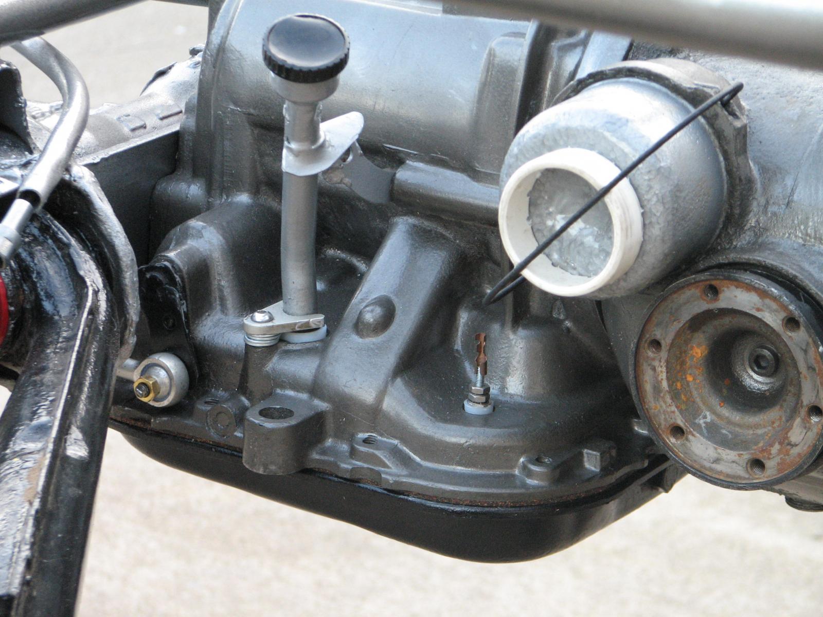

I built one last summer. I machined it out of nylon that it was a force fit.
Drilled a hole through it and threaded it #10 with a nut on top. It stem of the machine screw will take a tube style push-on terminal

I like your machined Kick down insulator, I also like your PVC governor spacer Very Happy . Did the bale lose its tension? Also are you running this trans in a rail? The cut down fill tube makes me suspect so.

Yea the governor bracket rotted off and I tried to find a new cover. Was as bad as trying to find the insulator
The dipstick is a Tecumseh lawnmower dipstick, but only to find out the rear seat is right over top of it. Design flaw on that idea.
