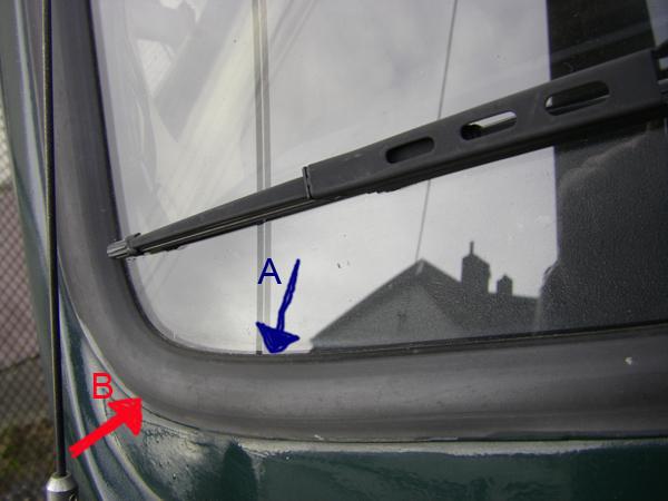

ONE QUESTION: (see foto)
First I lift back the seal and inspect the metal underneath for rust and moisture --- do I lift the seal back from SIDE A or SIDE B?
Second, if I find that there is no rust and/or anything to be too concerned about under the seal, then I should go ahead and apply a bead of urathane sealant under the seal from SIDE A or SIDE B?

You are concerned with with side "B". Water cannot pass from A to B as the seal is solid. You would apply sealant under the lip on Side B.

I just checked out my windshield seal up-close... and SIDE "B" (the outer side of the seal) seems to be totally glued down tightly almost all the way around - so tightly that I really don't think I should mess with it (or should I rip it open??)
However there are a couple of spots in the upper corners that look slightly slightly opened (see fotos)... and slightly along the top seam might not be so sealed up --- perhaps this might be where the problem lies?

There are several places on the nose where water can enter, the windshield and the antenna being the most common.
If the the windshield seal is already bonded down I would not disturb it. I would suggest confirming a good bond all the way around, if you find any gaps a dab of sealant should be an easy fix.
I have never seen water moving in from side "A" around the window glass. But it might be possible with a loose fitting seal. Any water ingress here should be visible on the inside of the van above the dashboard.
As a test some non permanent rubber cement (used for bonding photos etc) could be used to cover any suspected leak locations. Then just apply water.
Edit: If the repaint was done with the windshield instsalled, it is possible that the paint is holding the seal edges down. This is not going to stop water ingress. I would recommend freeing the seal edge and applying sealant if this is the case.
