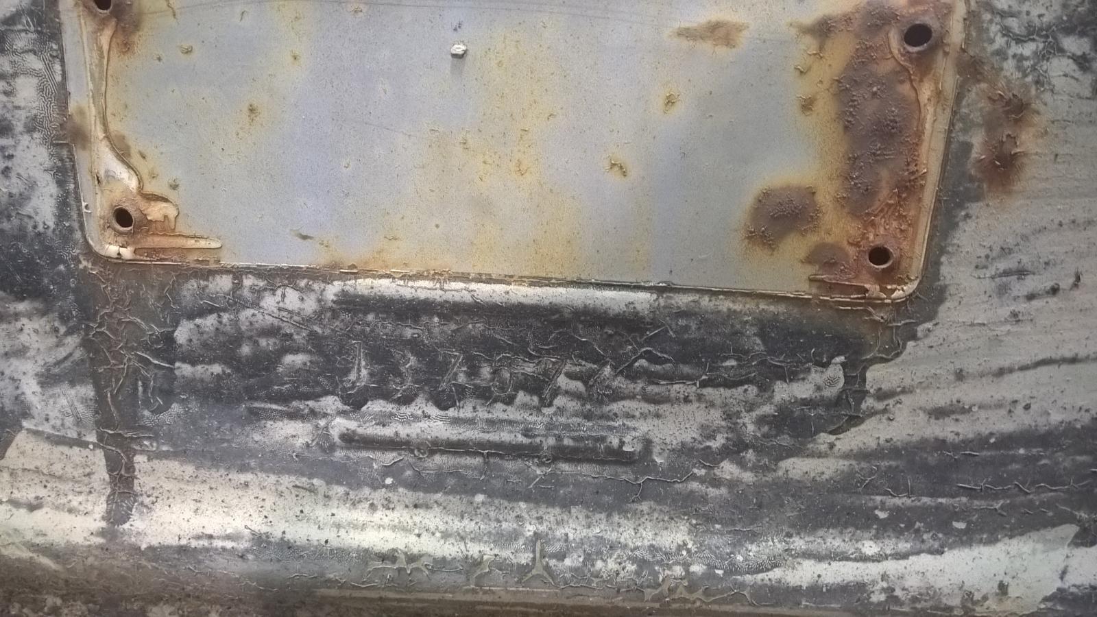

At the moment I am having difficulty reading the VIN number on the tunnel, since it is very faded on some numbers. Depending on how you intrepet it, it is either a December 1949 or August 1950 beetle. Does anyone have any suggestions for making that clearer to read before I pay for a birth certificate?

The vin is stamped, so it shouldn't fade. But a trick I've used is to make an etching of the stamped vin with pencil and paper. Cleaning with wire wheel or brush is usually a good starting point also

I was worried that the wire wheel would be aggressive on the vin. Would Vinegar or Lemon juice work also the clean it up?

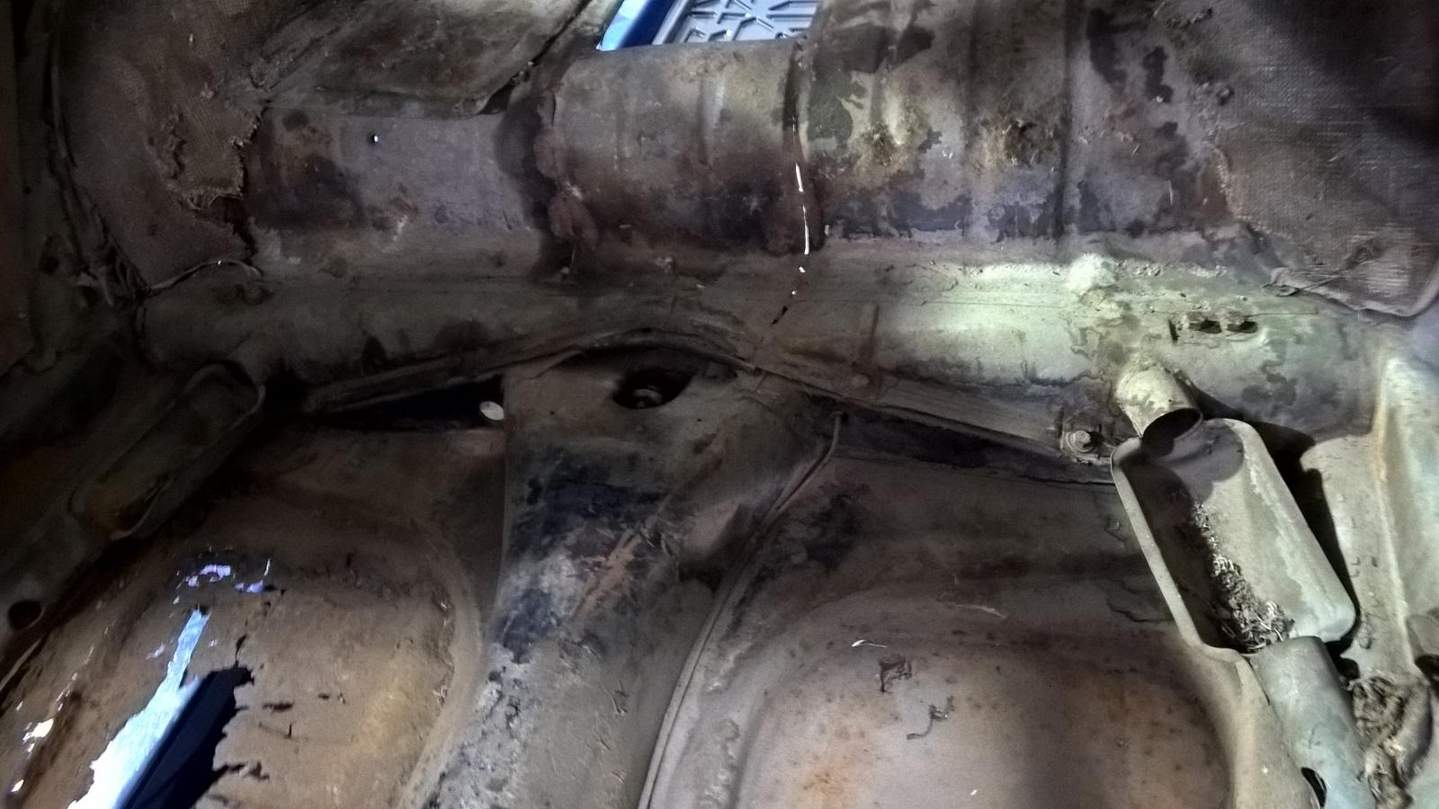

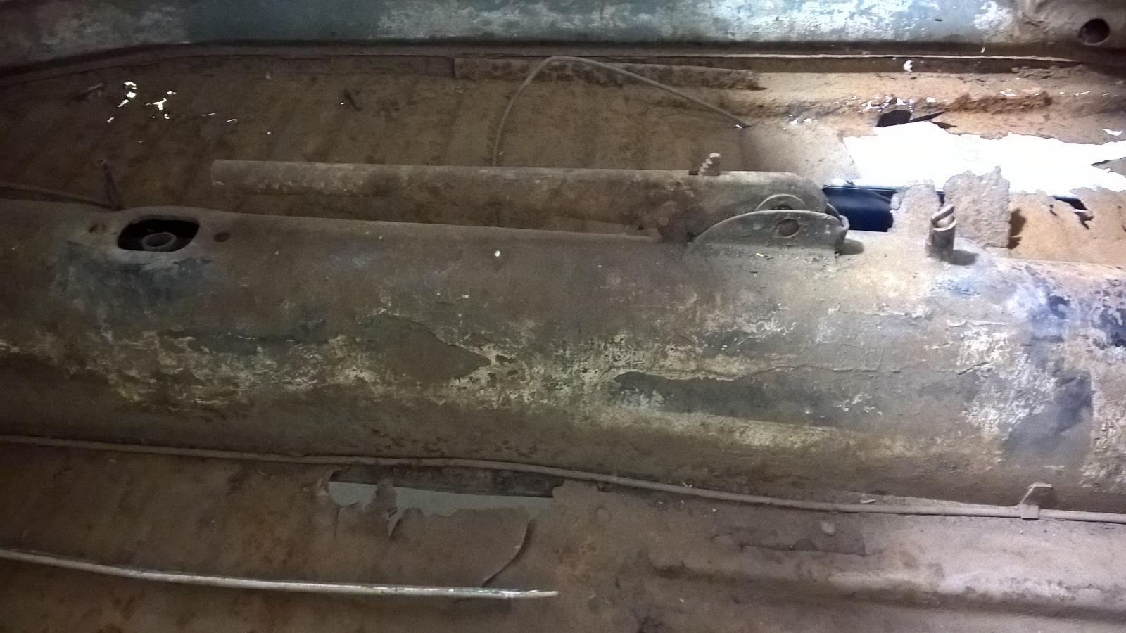

Let's see a picture or two of the tunnel around the ebrake/ shifter/heater/choke area. There are differences that could determine which it is.
Also the body number if it's a split body,
Also the frame number if you can see that.
The raised plate has the VIN and the other number is the frame number.

well the body is august of 50.
so assuming they match (which they probably do) then august of 50 sounds about right.
pretty uncommon for a split to be swapped onto another split pan, obviously a very long time ago.
pan looks like 0189xxx? Both very late august of 50
drive your split.

Agree, August 1950 for the pan and body. Definitely not a later 49

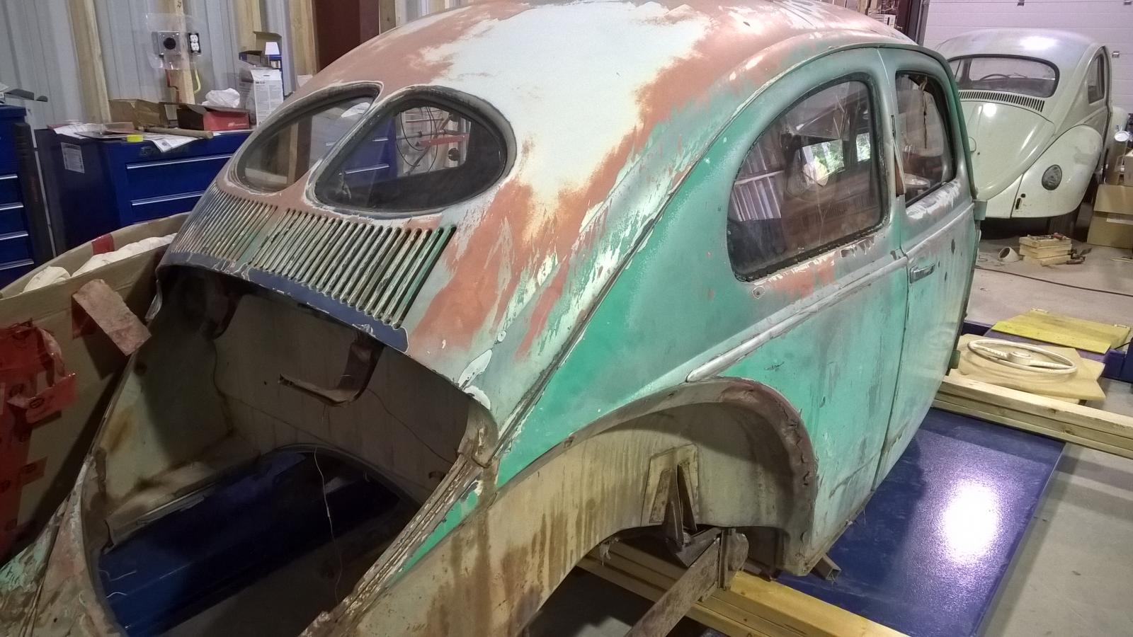

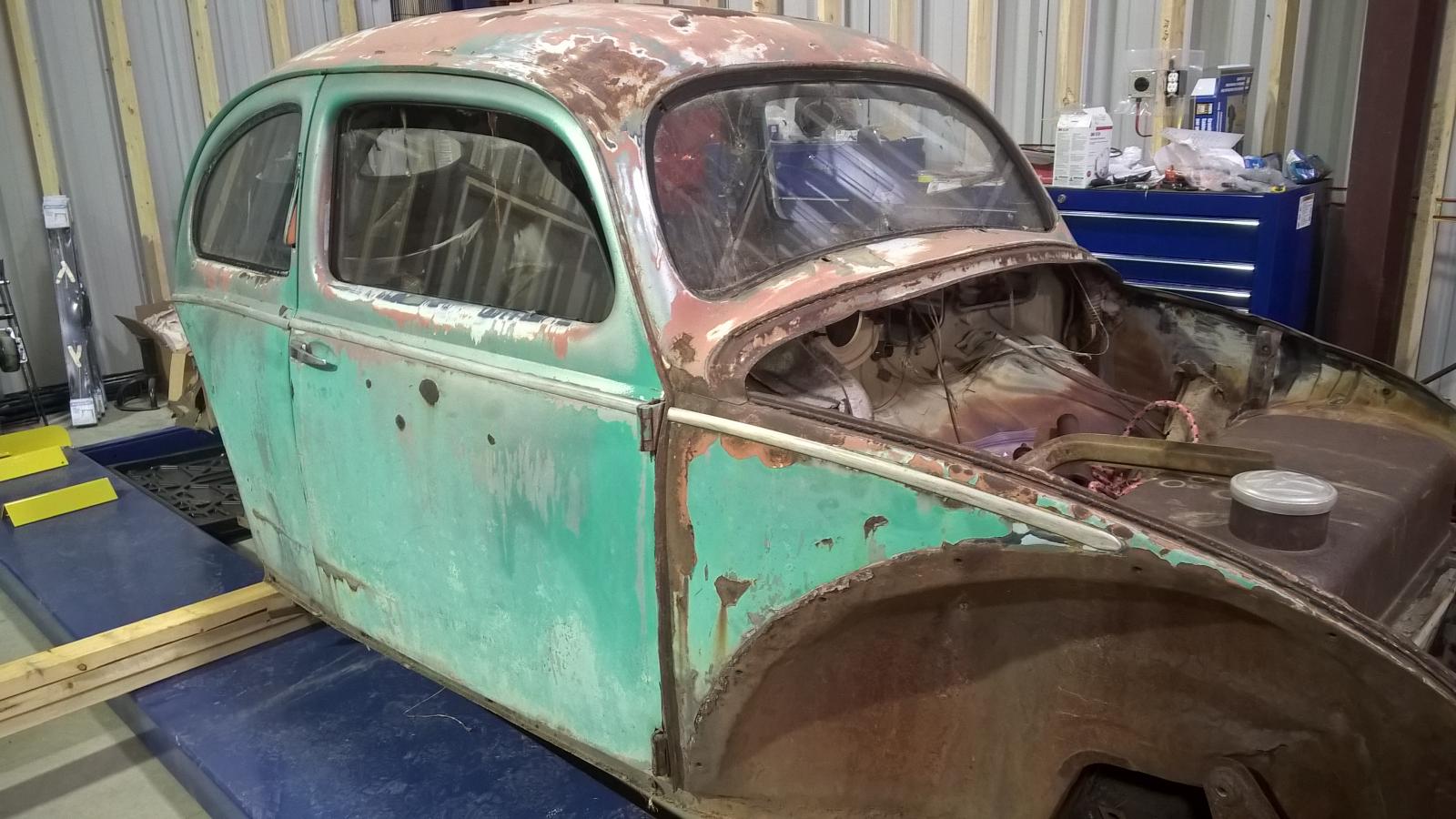

Can we see some pics of this car?
CommodoreCollector
Joined: August 07, 2013
Posts: 74
Location: Duncan
CommodoreCollector is offline
PostPosted: Mon Jul 18, 2016 5:09 pm    Post subject: Re: Canadian Found 1950 Beetle Build Reply with quote
How about two
