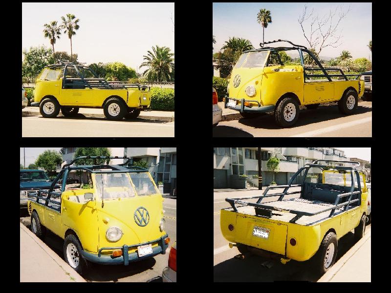

Baja single cab I saw in San Diego.
This guy goes EVERYWHERE!

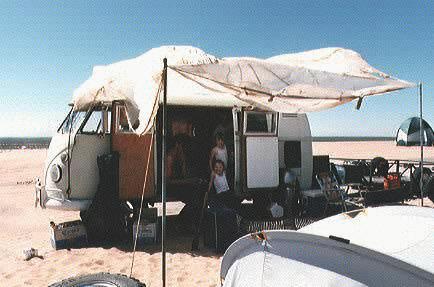

Here's an old picture of my Baja Bus. I use to go out to the desert (Glamis) all the time. She did great in the sand (flat and mild mound/hills, not the dunes) as long as I let the rear tires down to about 5 lbs and didn't stop. Flat sand I could stop and go. Always carried a jack, large piece of carpet or plywood and passengers to help push if I got stuck. Which I did a few times. She has a cut and turned front end and cut wheel wells for more clearance on the bigger tires. Once I put on huge 18" wide paddles tires and she did even better in the sand. I had to replace the rear shocks with straight pieces of angle steel so my wheel wells wouldn't cut the tires. I didn't drive fast. I just cruzed all the sand roads at Glamis. I've had her on many logging roads and in other same type of areas with out ever any problems. The ultra low first gear in the split works wonders on hard ground steep hills. You don't have to hit them as fast as you would in a Baja Bug to make the top. Just watch out when you get off camber as you are more likely to tip over than in a bug.
