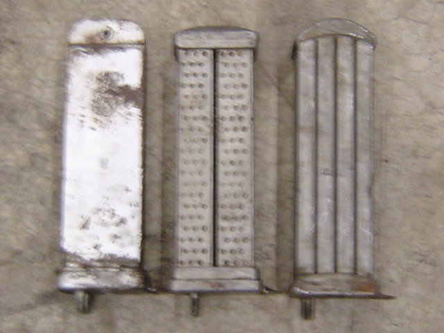

The alum cooler has 8mm studs , the 356 and 36hp have 6mm studs , but all the holes line up . There is enough material to drill the case for the bigger studs . Both the Porsche coolers have a larger opening , not sure if the standard cooler gasket would work (I didn't have any to check) the holes are about 1.5 - 2mm bigger . Here are some pics . TROY

PostPosted: Mon Nov 07, 2005 3:24 am    Post subject: Re: 356 oil cooler Reply with quote
Okay thanks alot!
What is the diffrents between the one in the middle and the left one?
I would say that the left one is best because of all those little finns/ribs
(I dont know what it is called in english sorry Smile )
http://vw-bluehats.blogspot.com/

PostPosted: Mon Nov 07, 2005 9:54 am    Post subject: 356 oil cooler Reply with quote
The one in the middle is steel , like the VW cooler . TROY

PostPosted: Thu Nov 10, 2005 4:30 am    Post subject: Reply with quote
Hello all.
The 356 alloy oil cooler will hit the top directional vane inside the fan shroud. I think Porsche designed the 3 piece case to work with the "tall" oil cooler and the VW shrouds(modified) it robbed from the OEM.
It will leave about a 1/8" gap over the cooler side of the shroud.
Troy please double check me on this. It's hard to tell, the case ribbing makes it look like it fits, but the shroud doesn't seat on the "roof" of the case. The shroud will rock back and forth.
You can do what want you want; I'm not saying it will not work. Compare the pic's and you will notice how the tops of the coolers differ.
I had to use a "Behr" cooler on my 1958 VW 36hp case with early (1956)
Porsche fan shroud.
Good luck with your project.

PostPosted: Thu Nov 10, 2005 12:26 pm    Post subject: 356 oil cooler Reply with quote
Al , went out to the shop , the alum cooler fit as far in the shroud I have as the steel cooler and a later 36hp, the dome top with brace bracket did not though . I don't have a case drilled for the larger mounting studs , to see if things change when cooler is bolted to block . TROY

Peter_Plade
Joined: January 09, 2005
Posts: 553
Location: Denmark
Peter_Plade is offline
PostPosted: Thu Nov 10, 2005 11:11 pm    Post subject: Reply with quote
Okay is it any taller than the original 36hp one?
Is it 36 hp fan shroud that tried to put the coolers in?
Teeroy Premium Member
Joined: April 20, 2003
Posts: 3864
Location: Eastern WA
Teeroy is offline
PostPosted: Fri Nov 11, 2005 11:35 am    Post subject: 356 oil cooler Reply with quote
It's shorter than the 36hp dometop with the brace bracket , yes testing with a 36hp VW shroud. TROY

perello is offline
PostPosted: Fri Jan 07, 2011 6:12 am    Post subject: Reply with quote
for the sake of contributing with more material I post the choices I have on my desk
IMHO, the left one aluminum behr oil cooler is getting hard to find on good conditions. Instead the center 356B/C oil coller can be found at an affordable price if you look thoroughly.
If I finally use the 356 one, I doubt between keeping the 8 mm studs an machine the holes on the case or substitute those studs....
