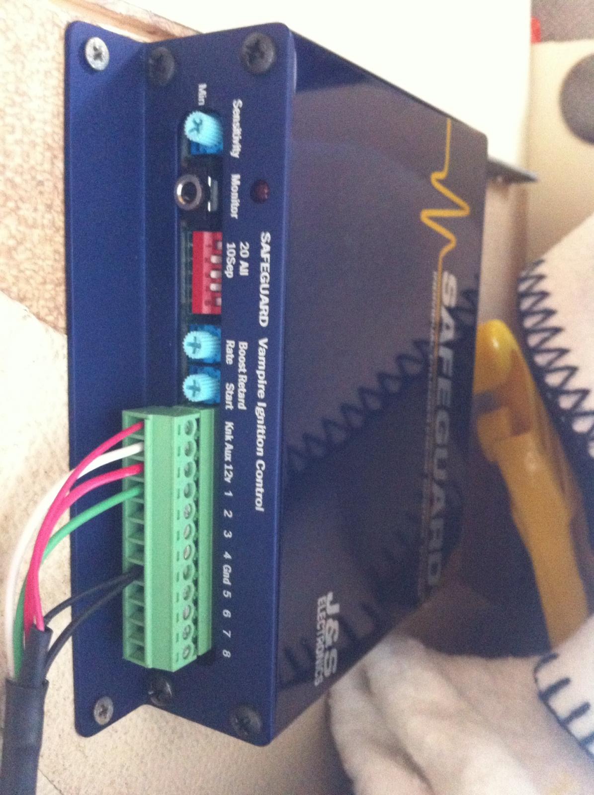

r39o wrote:
Pictures or it ain't real!
Ha, Nice... not much to see really. The box is about the size of a USB external hard drive, I was surprised how small. I mounted it in my Westy closet cabinet. I can take a pic when I'm home with the van.

This is the unit mounted in westy closet
