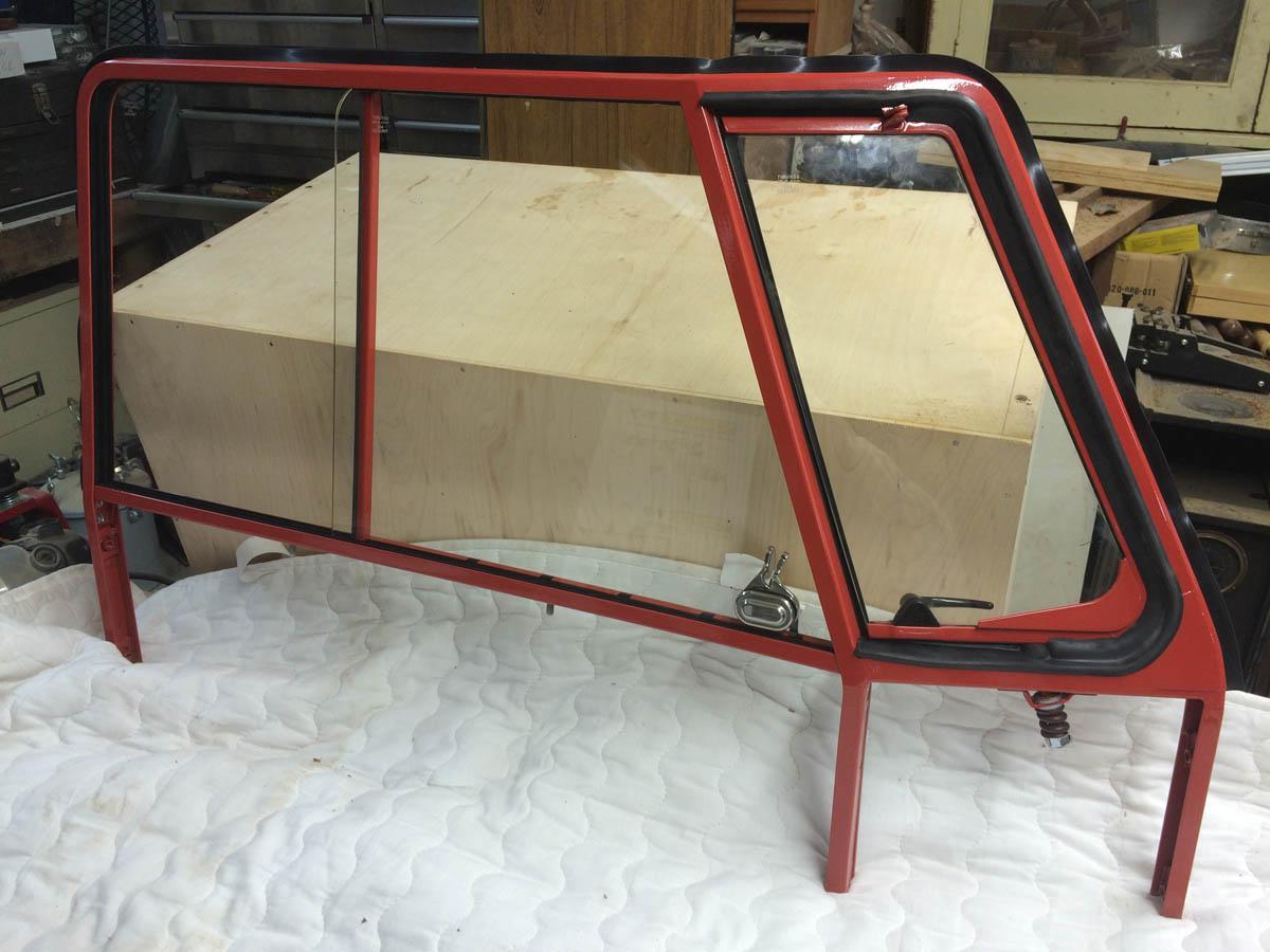

PostPosted: Sun Apr 03, 2016 12:24 am    Post subject: Door window Reply with quote
They do take some time to assemble don't they. One down one to go.

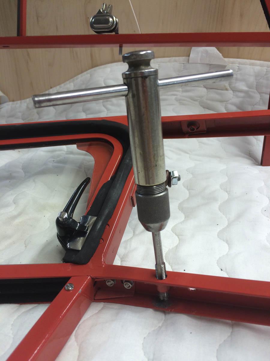

PostPosted: Mon Apr 04, 2016 8:43 am    Post subject: Door windows installed Reply with quote
I cleaned the paint out of the threads with a tap
and put them in the doors. You guys still welding and grinding keep at it. This part is really fun.

PostPosted: Mon Apr 04, 2016 9:55 am    Post subject: Re: 1959 Single Cab Restoration Thread "Funky Truck" Reply with quote
Freakin' beautiful work on that SC !
I was dreading the assembly of the vent glass to the frames and then the cab window assembly and mounting them to the cab door, but when it came down to doing it all on my '59 DC build, all went surprisingly well. I used a borrowed old version of the wood vent frame jig that you built and it worked awesome also! Nice work on the chiseled dental pick tool, you should crank out a couple more of those for sale! I'd buy one for sure for my next window job! Awesome detail! What skills!
It's exciting to see how close to finished you are! I'll see you and Funky Truck in two weekends!
