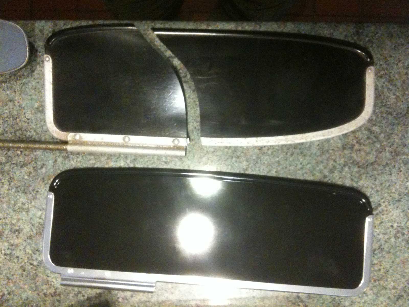

Right, back from the barn. This is the same as what is in my '54. I feel a lucky boy.
Secondly, I took off the old rv mirror from my '56 to see if the '57 & up would fit. The holes match up but it doesnt lay flat against the screw holes so if this is, from the information i have so far, a '57 & up, '57 ovals must be a different shape slightly behind the rear view mirror. Either that or my info is incorrect and it is simply not an oval rvm.
So like derluft said. Time to sell for sure.

Just to complete this thread, here is what I got in the post today. Happy bunnies!!
SO! since this was a showing of pure Bug love I will continue the flow and offer my '57..ish and up double sun vizor / rear view mirror to the first guy who asks for it, for the cost of P&P. One of the vizors is snapped: ------>

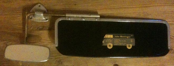

This is out of my 57. I need to clean it up. Any suggestions on how to clean up the chrome??
Try some 0000 steel wool.
