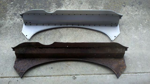

PostPosted: Mon Apr 30, 2012 7:40 pm    Post subject: My New Rear Apron?valance From Autocraft Reply with quote
Hi,
So, I have been accumulating several metal panels for my bus and will start some of the metal work over the summer. It has been a while since I have posted anything on my bus.
One of the replacement pieces I was in need of was a new rear apron. I could of repaired mine, although it was rusted in several spots. After looking at buying the bottom section from a Samba member and then fabricating the inside piece that was rusted out on mine, I just decided to buy a reproduction apron.
I had thought about WW apron, but I had heard it was thin, based on previous posts, so I never contacted them to see if it had changed. I know one Samba member had a repop in the classified section from Brazil, I think. And, I know that Klassic Fab was making them at one time and that KF version was probably really nice.
That said, I did some research on Autocraft and decided to give them a try. The guy I dealt with at Autocraft was super helpful and the order arrived safely and quickly.
The apron/valance is made of the same gauge metal as the original. I placed it next to my original and I could not see any difference at all. It actually is heavier because of the cancerous rust that had taken over on my original. All details and construction is spot on identical. The craftsmanship is in line with a German VW original.
I also ordered two lower side window frame replacement sections that look great.
I will check the fit of the apron tomorrow just to make sure all is good, but I am confident that it will fit perfectly as did the original.
Below are a few pictures comparing the original to the replacement from Autocraft.
Spitty

PostPosted: Tue May 01, 2012 6:48 pm    Post subject: Reply with quote
I like that. Good to know. Kinda hard to get paint inside but dooable.
DiggerD
Joined: August 11, 2006
Posts: 278
Location: North Georgia
DiggerD is offline
PostPosted: Tue May 01, 2012 7:11 pm    Post subject: Reply with quote
Looks pretty damn identical!!

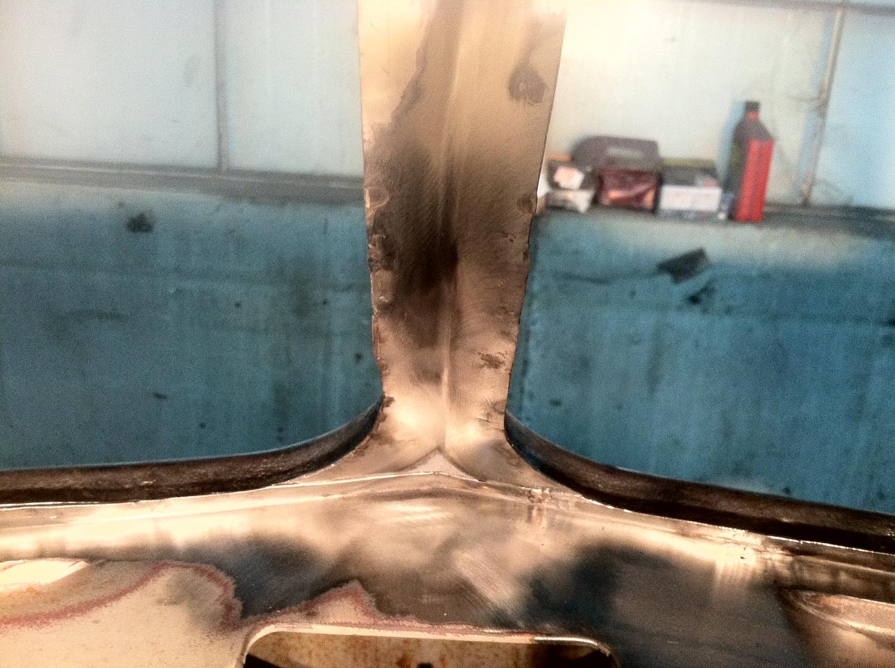

PostPosted: Wed May 08, 2013 4:05 pm    Post subject: The Correct Way To Fix a Front Windsheild Reply with quote
For those of you who have kept up with my thread you know I had some major trouble with my front windshield. It was in bad shape when I bought the bus and it needed to be fixed. There are pictures of the window area on the first page of this thread when I bought the bus.
Anyway, some of you may have remembered a poll thread that was started by a metal fabricator/sunroof mechanism business owner down in Huntington Beach, California that did some work to my bus. One of the things I hired him to do was to repair my front windshield and dash. If you read and saw the pictures you know that the work was way sub-par and didn't match the guys ability or talent. The thread ended up being a disaster for him, (which by the way, he started the thread not me.) In the end, he settled with me, but I was left with a huge mess. The funny thing is, I had hired him to do the repair because he normally does good work and I wanted the area on the bus to be fixed properly. And, I just don't have those metal skills and I did not want to mess up my bus because I tried to tackle a job left for an expert.

Thanks to member M113, the pictures below clearly illustrate how to repair a window properly. I can not thank M113 enough for helping me out with this very complicated fix. Mr. Happy down south really jacked it up, for lack of a better description. The work below was done properly and well. Mr. Happy made me out to be some pain in the ass customer here on Samba........Just for the record, I'm not. I'm 100% happy and thrilled with the repair that M113 completed. He does amazing work and was extremely professional.
Yay!!! My window repair done well by M113
This is how a windshield wiper holes should look.
Here is the other wiper section....Look, the holes line up.
Here you can see the proper fit of the panel to the nose in the center. M113 executed it perfectly. I will have to load up a picture and show you how large the gap was when Mr. Happy in Huntington Beach welded the piece up. The gap was huge. Thank you M113 for taking the time to do the repair correctly.
Wow, look how nicely the middle inner section was done.
Here is a shot of the inner lip on the driver's side.. Look how great it is, the two pieces of metal meet up and the spot welds are actually holding metal together.
Here is a shot of the passenger's side done well.
Here is a shot of the dash area that had to be repaired....Wow, look at the clean metal....I don't see any cancer rust, it was removed and replaced in a way that didn't leave anything left to cause problems down the road. Thanks M113 for taking the time to repair that section of dash correctly.
Well there we have it folks. All of the pictures that illustrate a shitty repair by Mr. happy in Huntington Beach.....And, all of the pictures that show the excellent work done by M113.......Thanks again M113 for getting me out of this terrible situation.

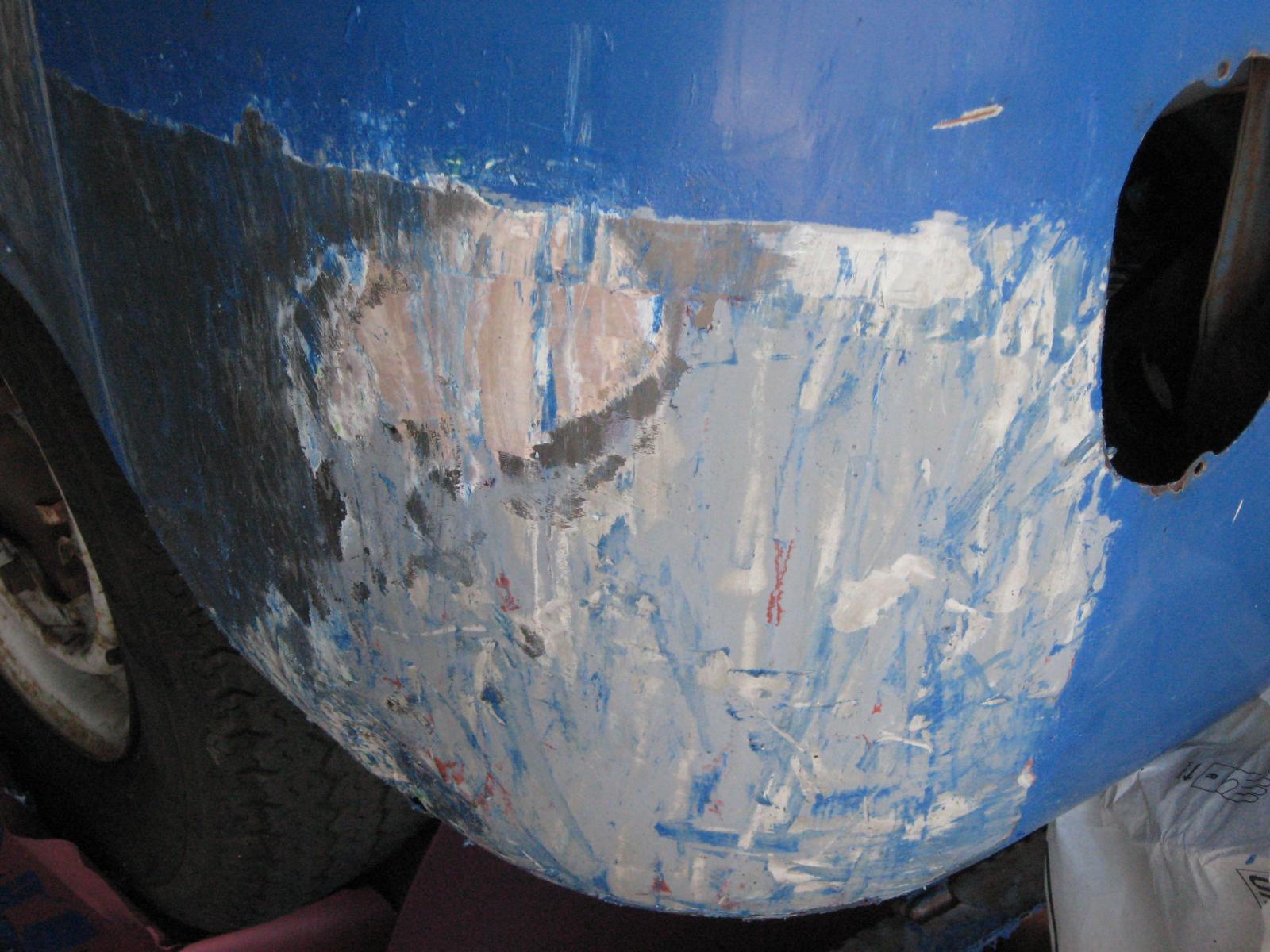

PostPosted: Mon May 20, 2013 11:09 pm    Post subject: Removed More Paint and Bondo Reply with quote
So, I took the rest of the paint off the driver's long panel, well except for the vent area. I still need to go back and sand off some of the left over primer.
I then started to remove the paint from the driver's rear corner.....Much to my dismay, I found a bunch of Bondo.....Someone at Earl Scheib back when the bus was repainted blue or wherever the cheap blue paint was done went trigger happy with the drill and also applied a ton of body filler.
I am hoping to work the metal out some and not have to use so much filler.........As I have yet to spring for an air compressor, I have been doing all of the paint removal by hand, it is slow going but works. Then, I have been doing a light wet sanding to clean the panels up for now.
On a side note, I found that paint stripper seems to break down old Bondo. I apply a coat of stripper, wait a bit, and then scrape it off layer by layer, it works well.....No dust at all.
Here are a few progress pictures that show what I mentioned above.

The corner when I just started to remove the paint and find the massive amount of Bondo.
A closer look at the Bondo in the corner.
A shot with about half of the Bondo gone.
Getting closer to being free of all the filler.
Here is a shot of the side closest to the engine compartment. Here is where you see some of the handy holes that were made right along the edge that bends in for the rubber seal......Someone went crazy with the drill back in the day.
Here you can see all of the filler is almost gone...I think you can see a few holes....There are also holes on the outside as well...I guess I will have to learn how to weld those holes up eventually.
The last shot of the day. I almost had all of the filler out, but it was getting late and I already had told my wife I would be done 30 minutes prior to taking the photo.....Look at that pile of filler!
