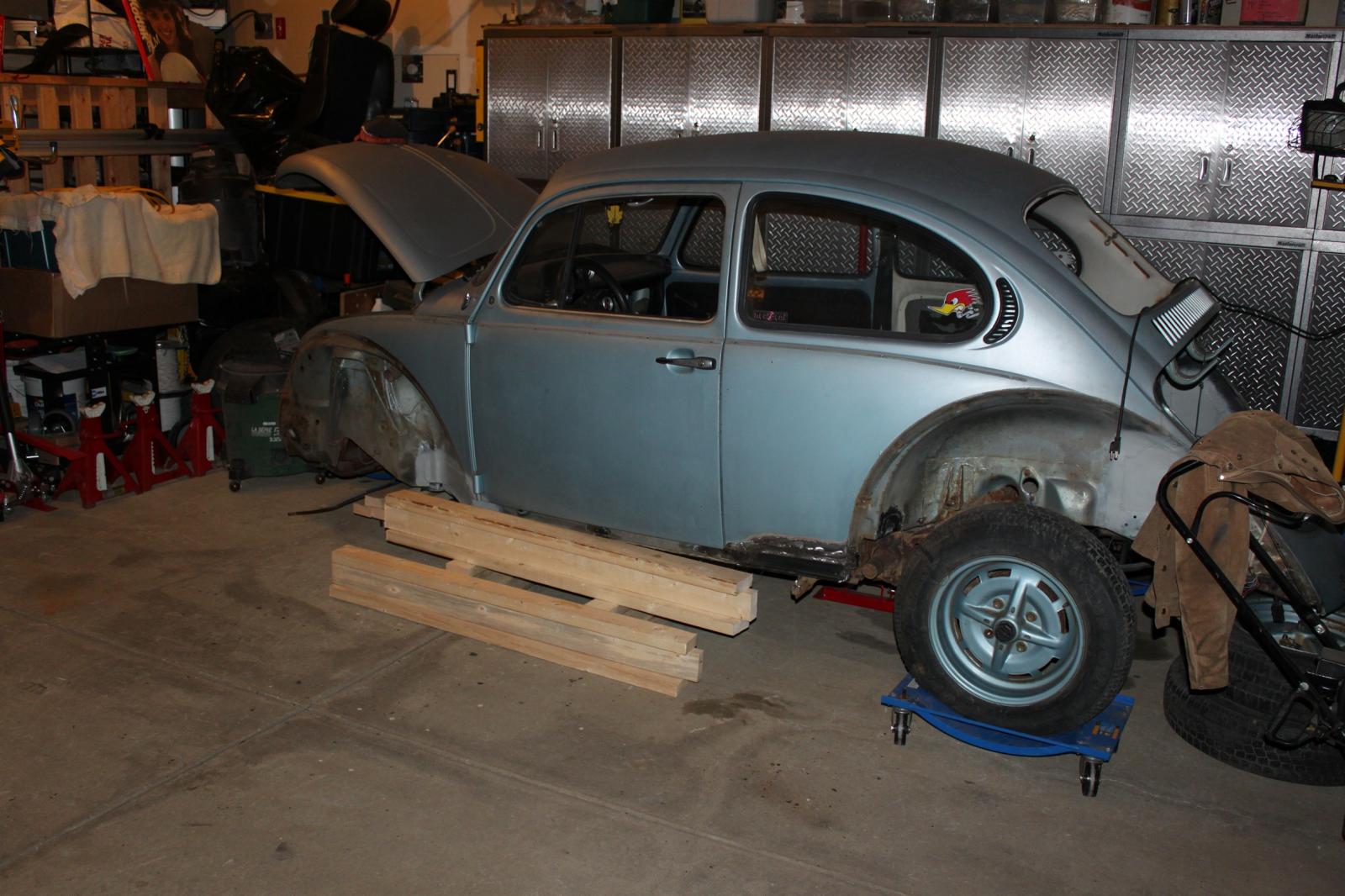

Whew... that was a bit of work. The body is now officially separated from the pan. I think the height of the stand is going to be great for working on the underside of the body and cleaning up the fenderwells... but for paint, I think I'm going to drop it right down to about 16" off the ground.
Here's the stand that I built. And you'll see in later photos, I also built it so I can store the pan (for the time being) under the body. Next Friday I plan on putting the pan in my trailer in storage. That'll give me better all around access to the car if it's not here. Once the body is at the body shop, then I'll bring the pan home and get to work on that. Then I'll only bring the body back once the pan is done and ready to go.
As for lifting the car onto the stand, it actually was pretty easy. Rather than using jacks, a buddy of mine came over and we just lifted the car onto it. I'd imagine once I get more of the stuff out of the car and (dash, glass etc etc), it should get even lighter.
Here it is at the end of the work day today. Might not look like a lot, but this took me all day!!!

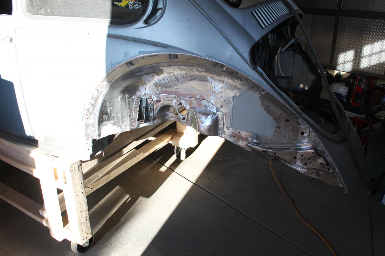

First thing that was done since the last update was that I've moved the pan into an enclosed trailer, so it's now residing in storage until I'm finished with the body and it's off to the body shop.

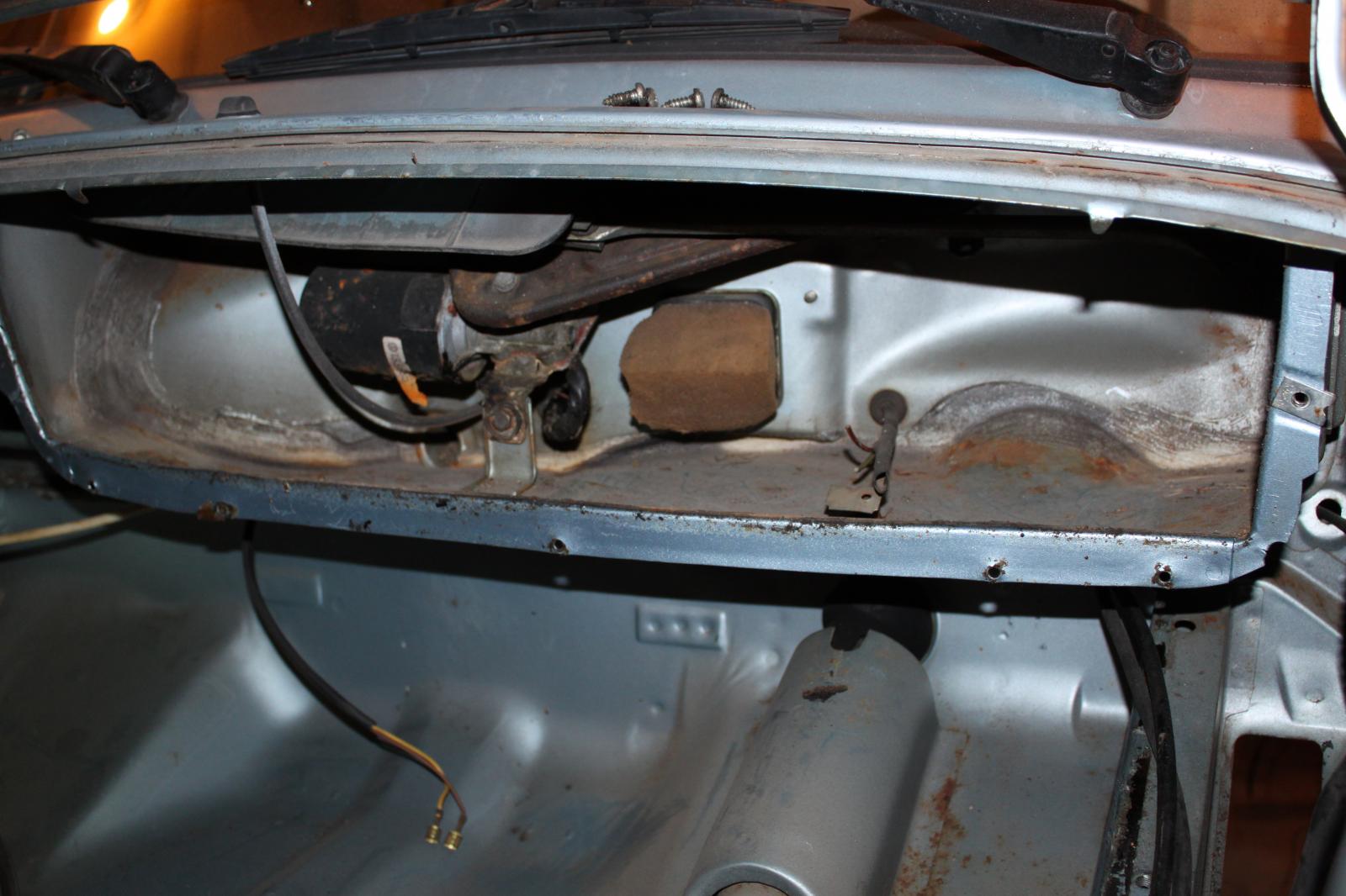

Today I wanted to start working on cleaning up the wheel wells. Starting on the driver side front, I wanted to get the steering box bolts out... That started a half day journey removing the gas heater, gas tank, and eventually the steering box. No real surprises except that I'm continued to be surprised at how nice this car is in for it's age. Did discover that the car was in a bit of a fender bender at some time in the past, as there's some repair work on the passenger side fender well. Nothing too bad, but will need to remove a few remaining wrinkles.
I was however surprised at my success in separating the exhaust elbow on the gas heater exhaust pipe. I wanted to preserve it so I ended up spending more than an hour working to separate it from the pipe without damaging anything. I was successful.
Here's a shot with the fuel tank and gas heater removed.
Kinda crazy, but it seems the previous owner had completely disabled the circulation system. The fan box had foam jammed into the duct leading into the car. Looking behind the dash, there seems to be quite a bit of ducting missing too. Guess I'll have a bit of work to do in there to figure out what's missing and what will go where when I re-assemble.
So, once I got through all this, I cleaned up the one wheel well, ground down all of the rusty areas, de-greased it and gave it a quick shot of primer.
I did discover a bit of perforation in the sheetmetal around the bumper bracket, so that's an area that's going to need a little metal replacement. Actually three spots in around there that I'll be repairing. Didn't get to it today... Another day.
