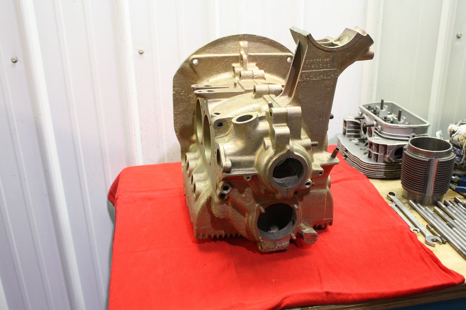

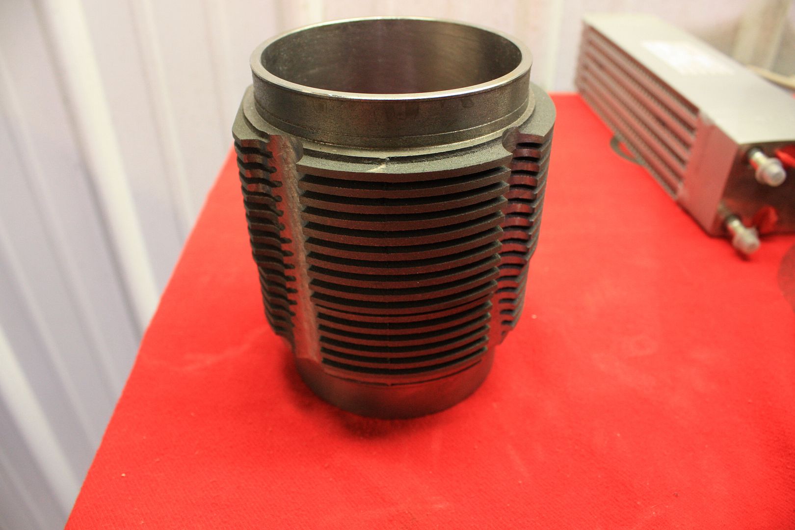

Started on the motor this week. I've decided on a vintage speed 36hp, based of a 20- case, 69mm crank and 83mm pistons. I'm a little worried about the power, if it will be enough for the bus, especially on those long road trips. I had Rimco machine down the fins of a 40hp big bore kit to fit under the 36hp tin, and there is not much left for fins. Which is making me worry if there will be any issues with it running hot. I guess I'll know in the spring...
The case, machined by Rimco. Claranced for a stroker crank, opened up for the 83mm cylinders, oil galleries tapped, and spot faced. I alodine coated it. Don't ask me where I got the alodine from...

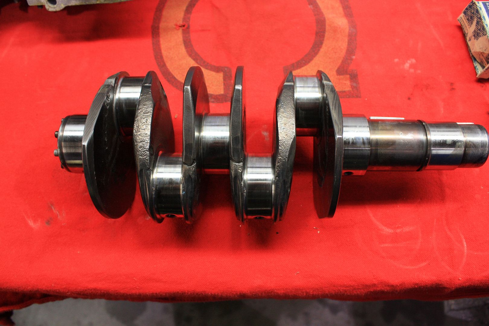

DPR 69.5 mm crank

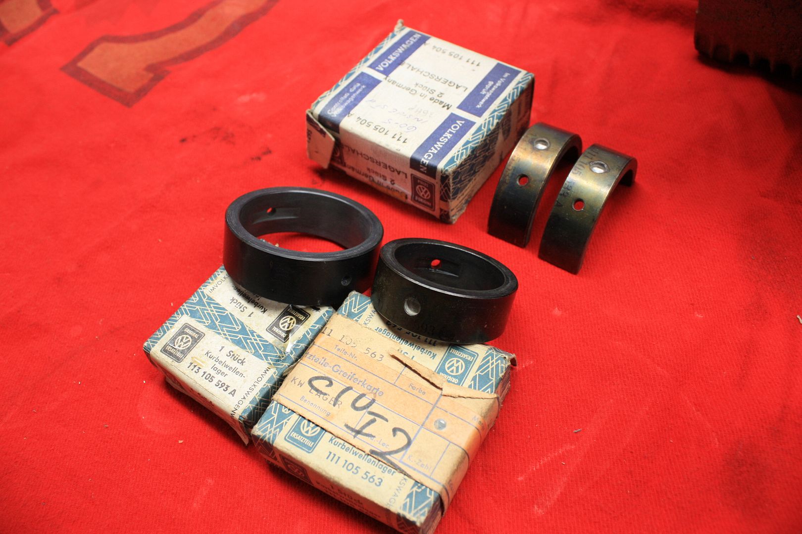

NOS main bearings.

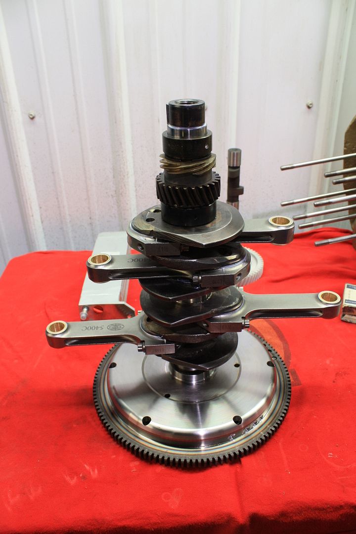

And the crank assembled. Empi 5.4 rods, Narrowed to fit the crank and re-bushed pin ends for the big-bore 83mm pistons.

PostPosted: Tue Feb 07, 2012 5:50 pm    Post subject: Reply with quote
Those cylinders don't have much fin left. Not too worried about overheating?

I am worried.
Rimco turned the barrels down for me, as I had heard they have clearance issues not only between them, but also for the cylinder tins to fit. It seems to me like they took a fair amount off.
In the meantime... Motor building has come to a complete halt while I'm waiting for JE to make a set of custom poisons for me. I had a little bit of poke, out the top of the Cylinder...
