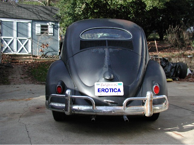

PostPosted: Tue Dec 01, 2009 10:05 am    Post subject: Reply with quote
Nice to have another black oval in our Maryland community!
Here's mine;
As for your cylinders, I wouldn't break out the air tools just yet. Thats a bit harsh! And those pistons might be reusable!
Keep at it with the penetrating oil. Maybe even roll the engine up on one side and put a half inch of penetrating oil on top of the cylinder and let it soak for a while.
Try the breaker bar on the crank pully. If you work in small steps, they will come loose! you just have to be patient.
