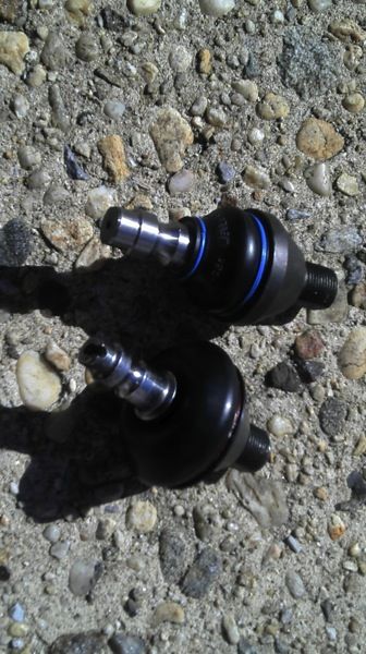

Thought we'd take another baby step towards completion today and install the lower ball joints that arrived yesterday...But whaddaya think of the size difference between the old (bottom) and new( top)?
The post on the new one is a tad too big to slide right into the spindle, even with the bolt removed. I thought banging it in with a mallet might encourage it, but D/A/N thinks it won't help because he believes it's just too big for the hole. I've searched the forum to see if anyone else has had this issue, but no one seems to mention trouble with the fit (unless they have the wrong parts but we have the right parts). Any ideas?

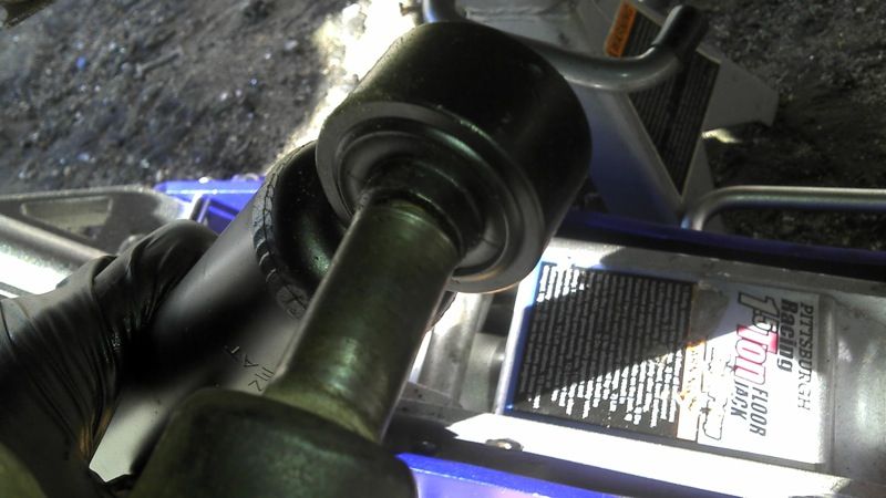

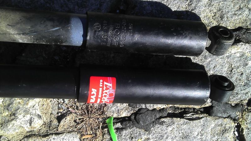

Then, we thought we'd also put on some new front shocks, but they also won't go into place because of a raised/protruding piece coming out of the mounting holes that you can see here (old one on top; new on bottom):
and how it prevents the shock from being seated here....it goes over the bolt on the lower mount but not even close to going over the metal "sleeve" because it just buts up against it. No picture of the top, but similar story there.

On the front shock, it almost looks like you have the sleeve that should have been part of the shock bushing frozen to the fastener. The part number on those shocks I sent you crosses directly to the Bilstein number that I installed on a front end about six weeks ago.
As to the lower balls, I just installed a set into a drum brake beam about a month ago- car is still here so let me go look at both shocks and ball joints.
EDIT: Wait a minute... your old ball joint next to the new one... old one sure looks like an upper and not a lower to me. Confused

OK, just surveyed two different beams and parts of beams- the "lower" ball joint you had is definitely an upper from what I can see. This would explain why it pushed the boot off. IIRC the upper shafts are just a hair smaller than the lowers, so you may need to spread the "clamp" the shaft slides into slightly with a big flat head screw driver.
But first- Question: could you have inadvertently switched your upper and lower ball joints when you installed them? Look and see if your uppers have a "shoulder" like your new lowers. If so, put your boot back on, switch the ball joints, and send me the ones I sent you back- you don't need 'em. And don't feel bad; it's an easy mistake to make.
NOW- Shocks. I just went out and looked at the pair of KYB shocks I pulled off a car to install Bilsteins, and they look exactly like yours. Try sanding or wire brushing all the corrosion off your beam mounts and try getting your shock on lubing up the shaft with oil or grease. It's a tight fit, and any little bit of build up will prevent the sleeve sliding onto the fastener. In fact, it looks like there's actually a ridge on the edge of the shaft in your picture.
Post the KYB number stamped on the shock itself and let me compare if you can't get 'em to fit. It should be 343144

Those ball joints were definitely sold to us as lowers by ISP West - p/n 311-405-371C. And this is what we have for uppers, hope they're okay: http://www.amazon.com/dp/B001QV6E52/ref=pe_175190_21431760_M2T1_SC_dp_1
I'll get a shock number later tonight (not near the car right now) because the shock fitting problem doesn't seem to be a matter of corrosion on the beam. The sleeve on the beam and the bushing on the the shock perfectly butt up against one another...like they're the exact same size. The old shock definitely had a tight fit. It was a bitch to get off and D/A/N had to lube the bushing with silicone to get it back on when we packed up for the day. It seemed like we'd have to take all the plastic out of the bushing for it to fit like the old one did. But one of us will post the p/n later today.

Plastic in the bushing? Do you mean there's a plastic insert in the metal sleeve? If so, then yes- take it out. They're making these shocks for multiple applications now to cut down on the number of different parts they have to stock.
Those Raybestos joints from Amazon are uppers, yes. Spendy!!
The "C" part number should be lowers. Wonder if they were misboxed?
Actually, I don't mean plastic at all, so I shouldn't have replied so soon after waking up from a nap! The protruding sleeve is in fact entirely metal. Part number matches the one you posted, 343144. Bolt fits through the top mounting hole just fine, but the protrusion on the shock butts up against the protrusion on the beam, preventing the shock from being seated properly. On the bottom, it's not like it's hard to get over the sleeve, it's that the protrusion seems to be exactly the same diameter as the sleeve so it'll never go over it.
Speaking of being spendy, I wonder if at this point we should just shell out for the Bilsteins...we got spendy with Amazon because we were desperate and wanted the parts quick!

Will the shock slip on the mount with the sleeve facing the other way, and is the other side doing the same thing? 343144 is the same part number I just test fitted to a beam with no issues, but the sleeve on yours looks thicker.
Probably not because both sides are identical, but we'll give it another go tomorrow when we do the ball joints (again) Sad
