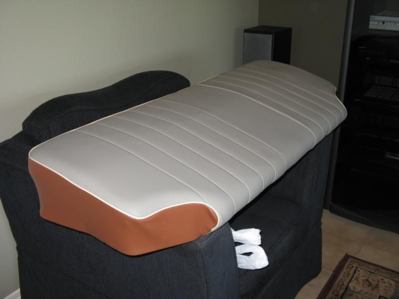

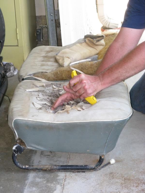

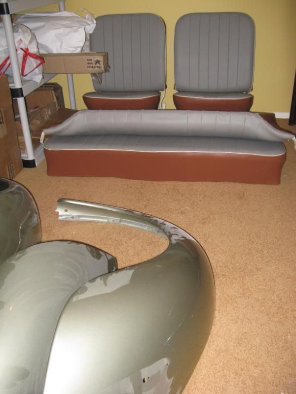

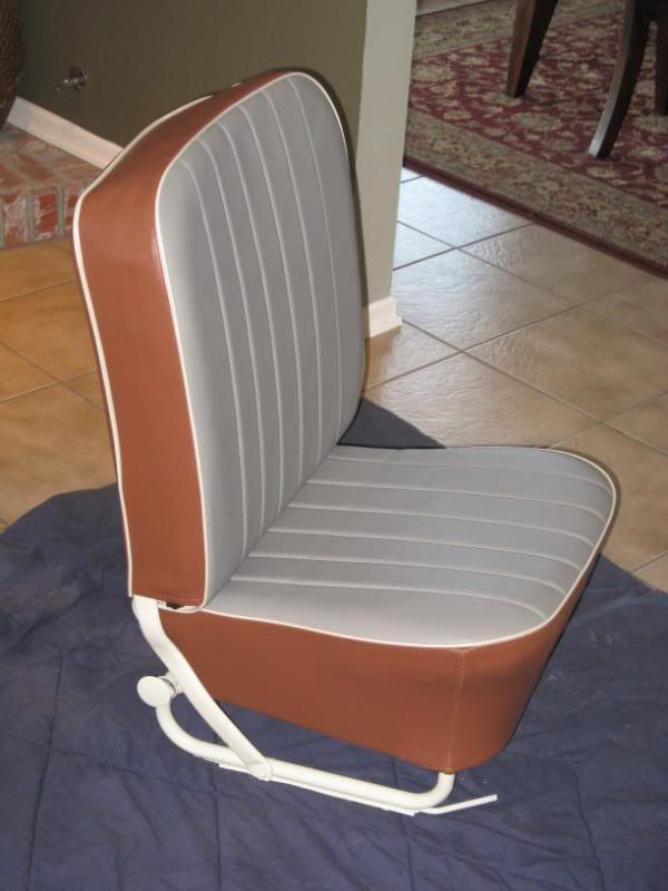

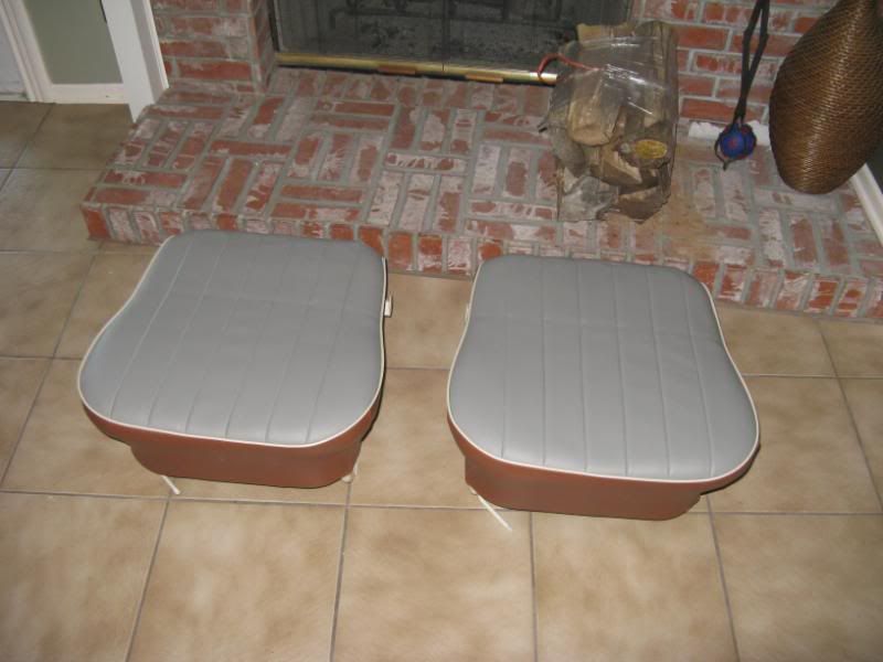

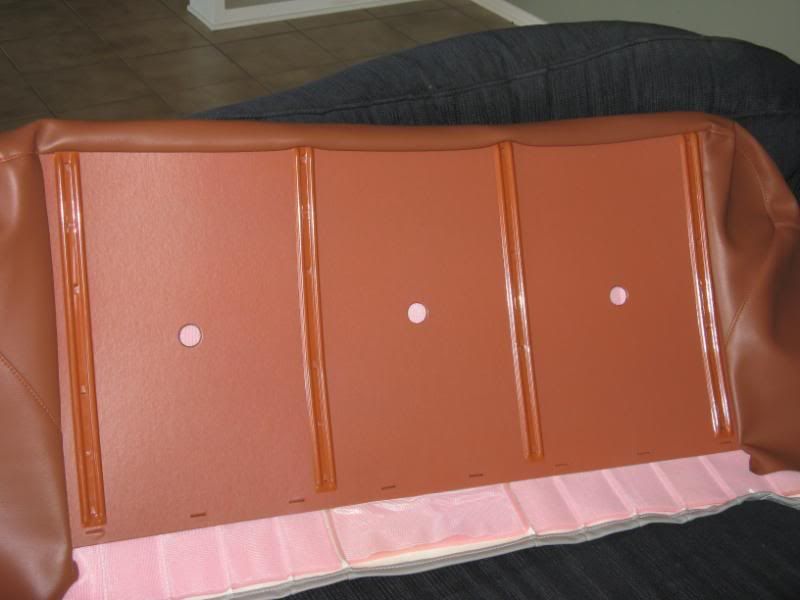

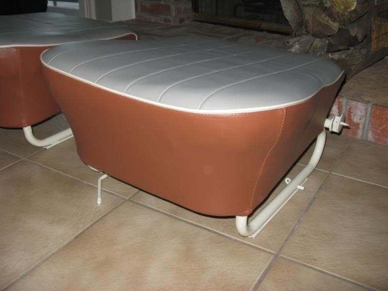

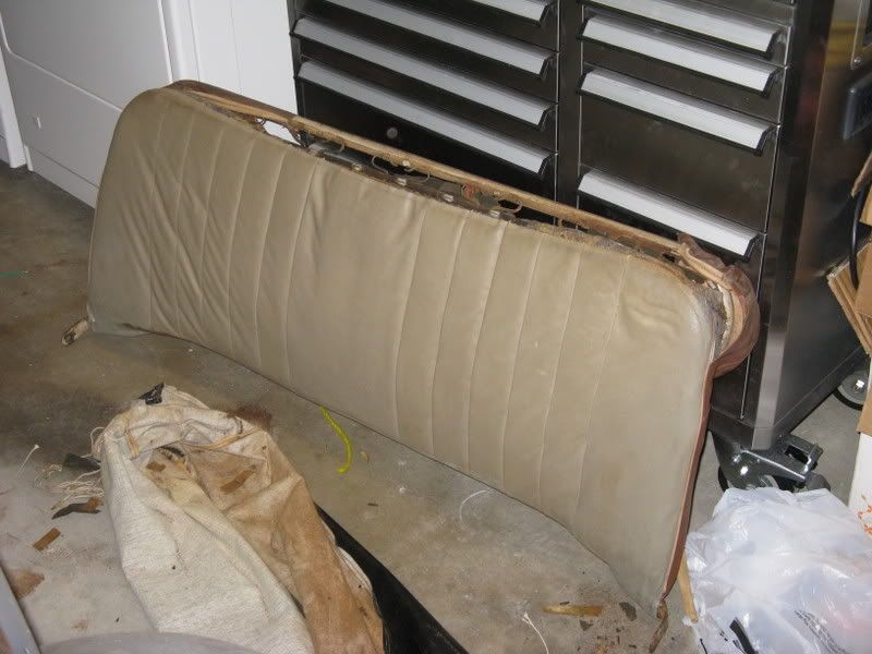

Ok so I finally have some pics of shit put together. Not the car, that's coming soon, but the seats are together and ready to go in the car once the car is ready for them. I also picked up the speedo from North Hollywood Speedometer. Those guys are good for anyone looking to have something done. This thing is starting to feel like its really gonna be at classic. No longer is it me just saying and wishing for it to be done... Anyways... Pictures:

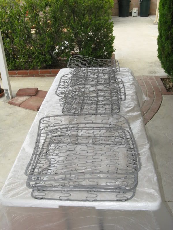

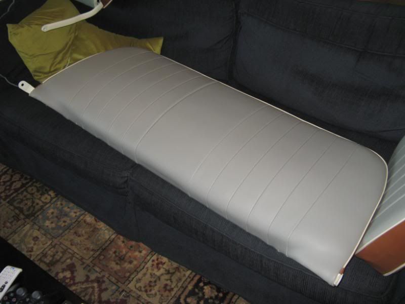

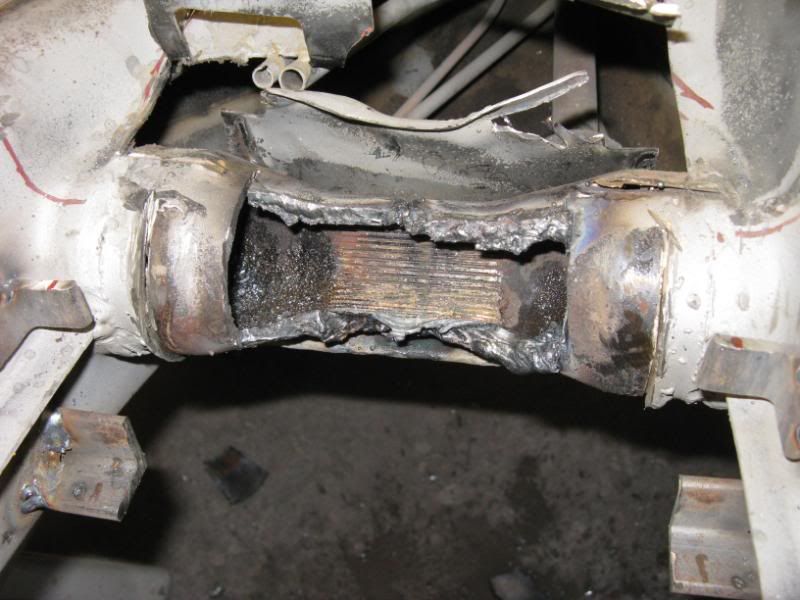

How the seats started...
during teardown.
broken down
back seat I started with
bottom of back seat.

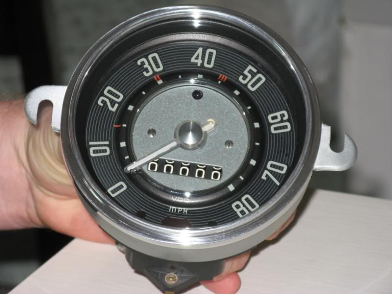

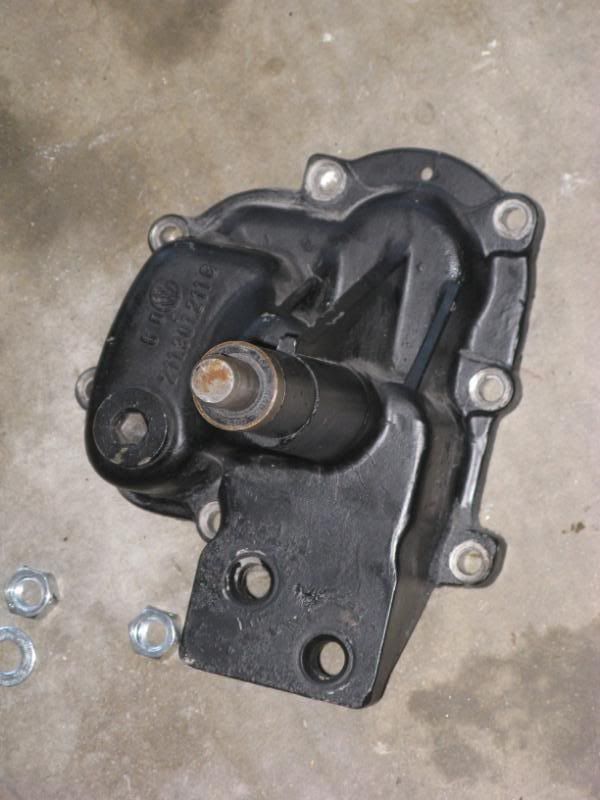

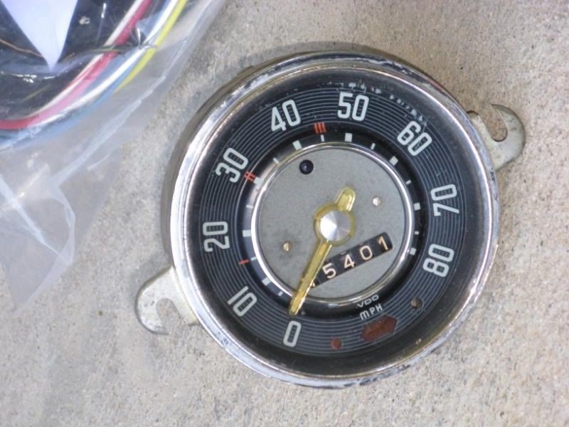

how the speedo started, when I got it.
Fully restored speedo

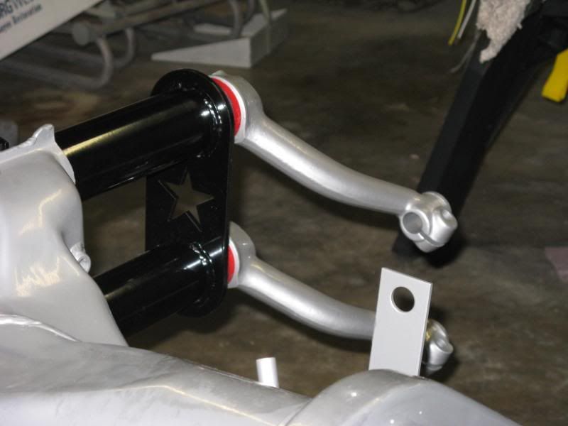

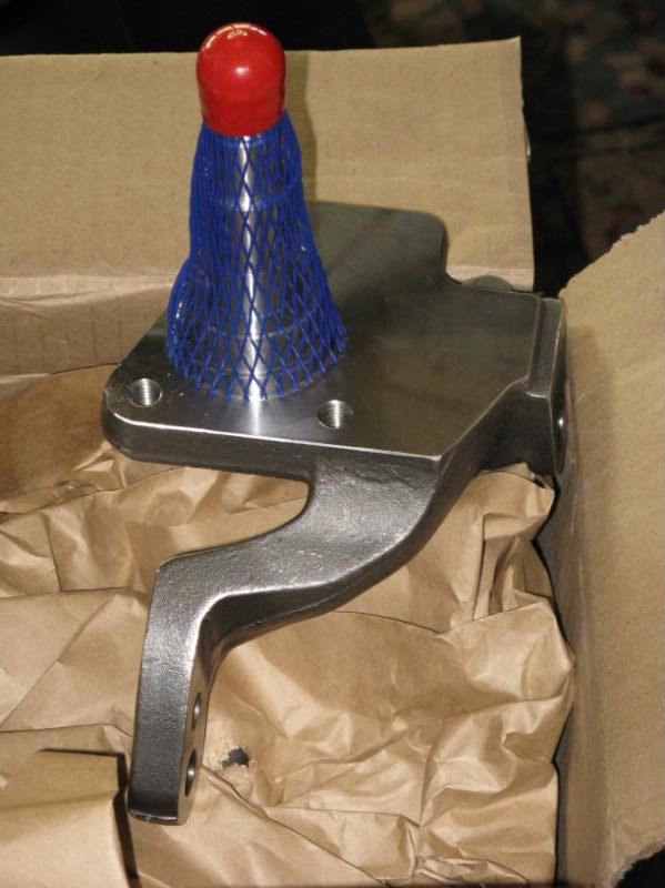

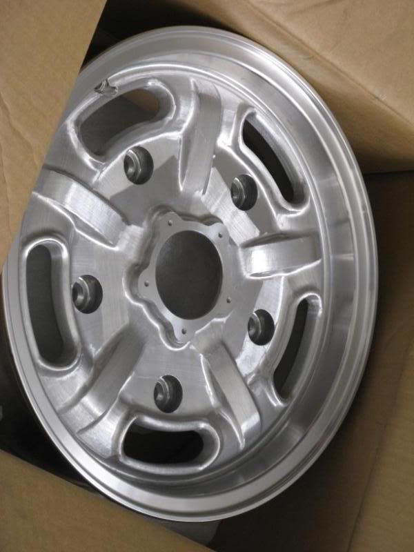

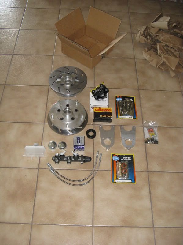

Oh yeah here are my front brakes and spindles.
Airkewld 0 offset front discs
Airkewld drop spindles.

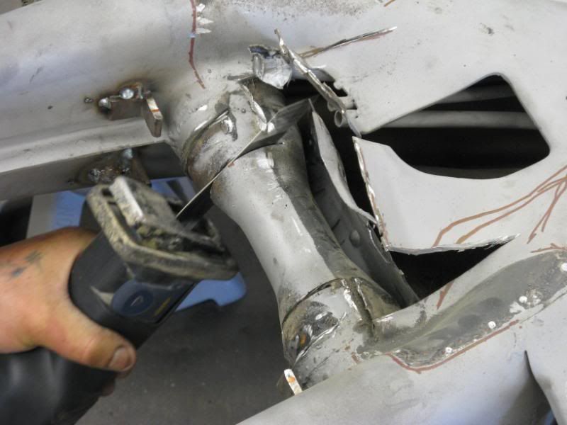

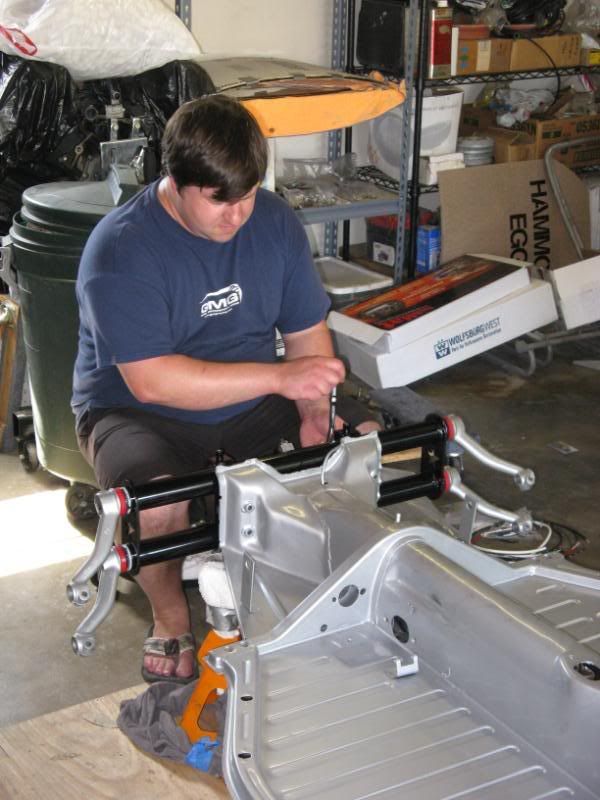

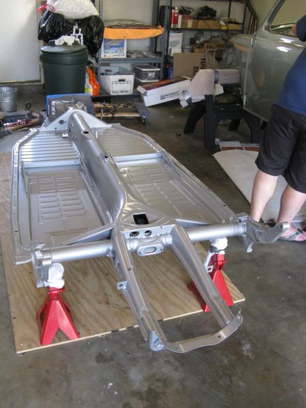

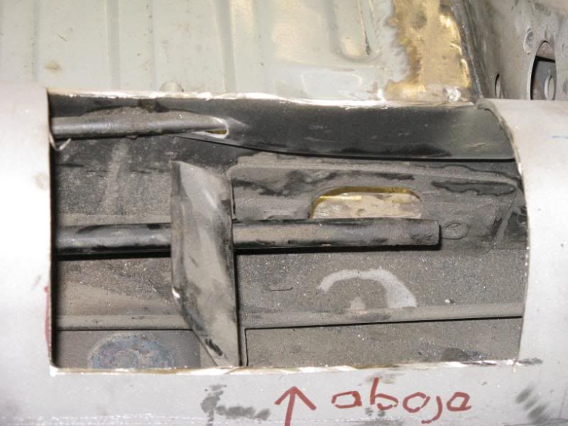

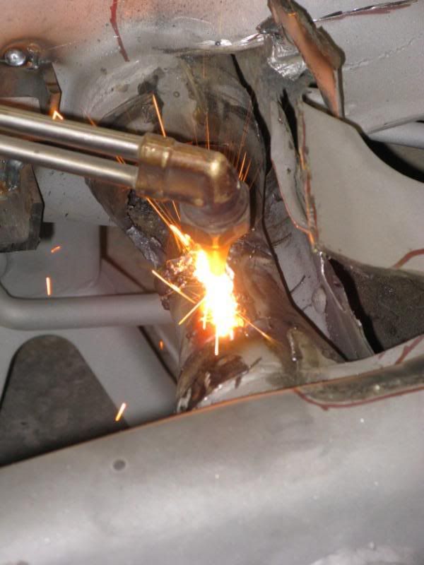

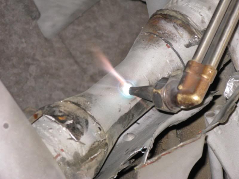

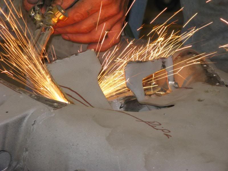

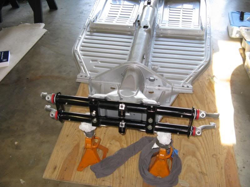

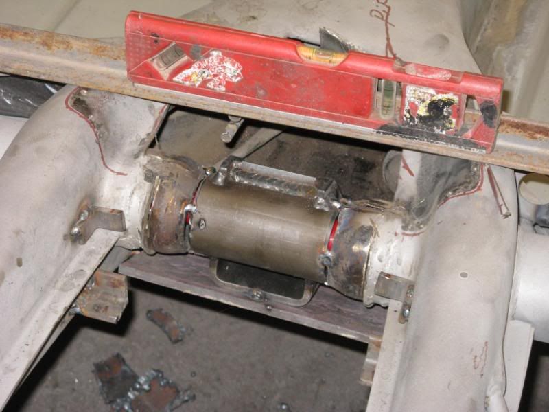

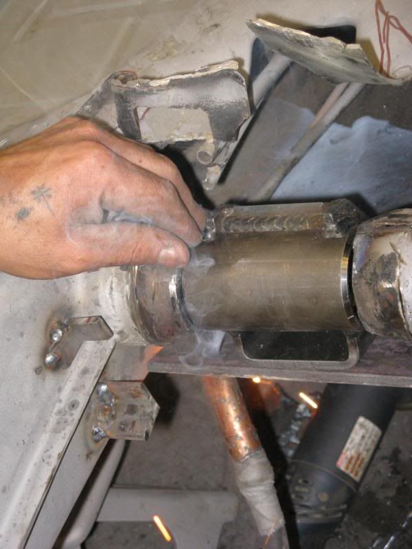

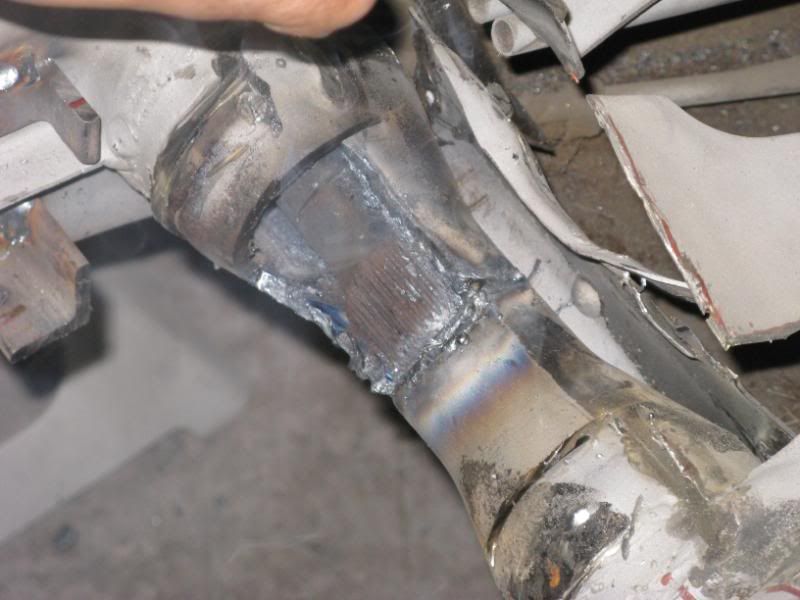

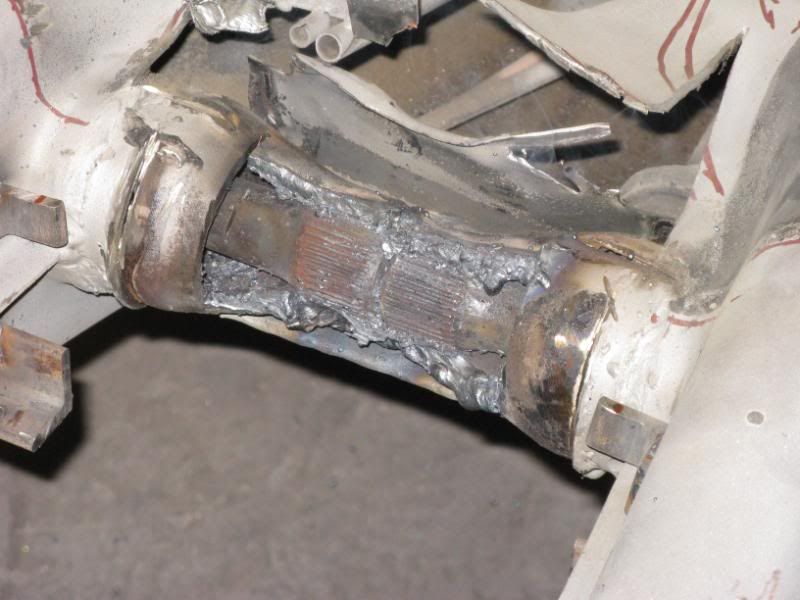

some updates... I finished the rear torsion adjuster with my buddy Jose and he powdercoated the pan. I got it back last Saturday and worked on it a bit. This weekend I should finish the pan up and probably have a bunch of the body finished too. My wheels should be back Friday and I'm hoping to throw the tires on Saturday morning so I can make it a rolling pan. Then over the course of next week I can build the motor and get it ready to go in. Once that's done I just have to mate the body up, get the headliner done and assemble the outside. I still think I can make classic...
Pics...
Jason
My 64 1500 S Notchback project here
My 58 sedan project here
My 63 Ghia here
lawn ninja
Joined: January 02, 2006
Posts: 1021
Location: Round Rock, TX
lawn ninja is offline
PostPosted: Thu May 21, 2009 6:30 pm    Post subject: Reply with quote

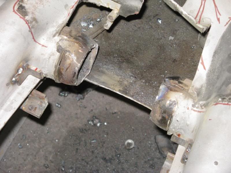

The guy in the pics is my buddy Dan who is helping to make sure we get it done by The Classic. He's a good motherfucker and helped me both days last weekend. I included a picture of the seals because it took a long time to get the channels ready to accept them and a while to get them in, so they deserve their own pics.

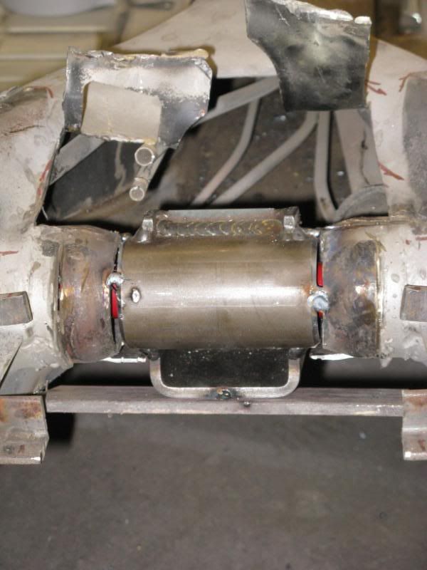

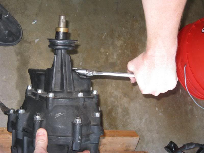

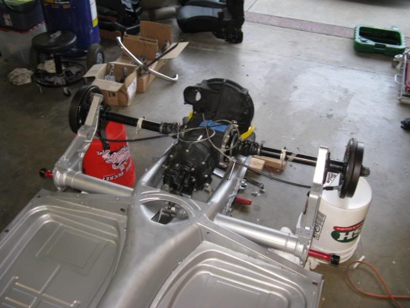

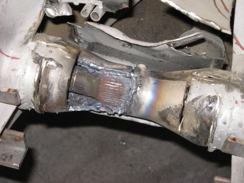

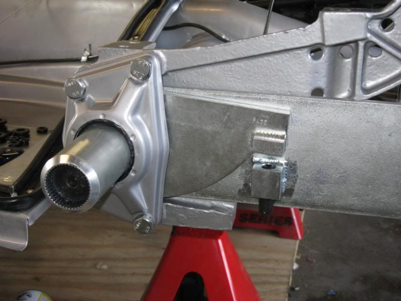

So in order to fit the tranny into the 58 pan we had to swap the nose cone. The nose cone is from a 67 bus in case you were wondering. It's the only way the late synchro transaxles will work with the early pans.
bus nose cone
Transaxle in place and ready to be hooked up on the spring plates

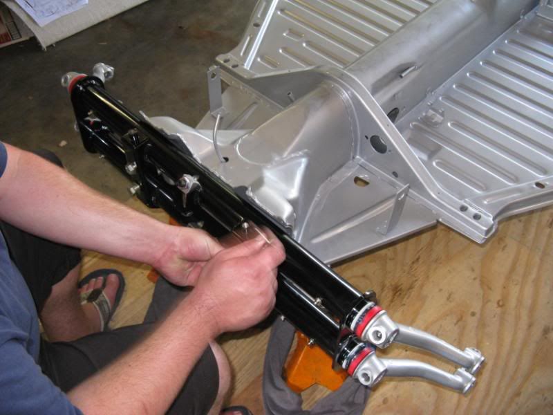

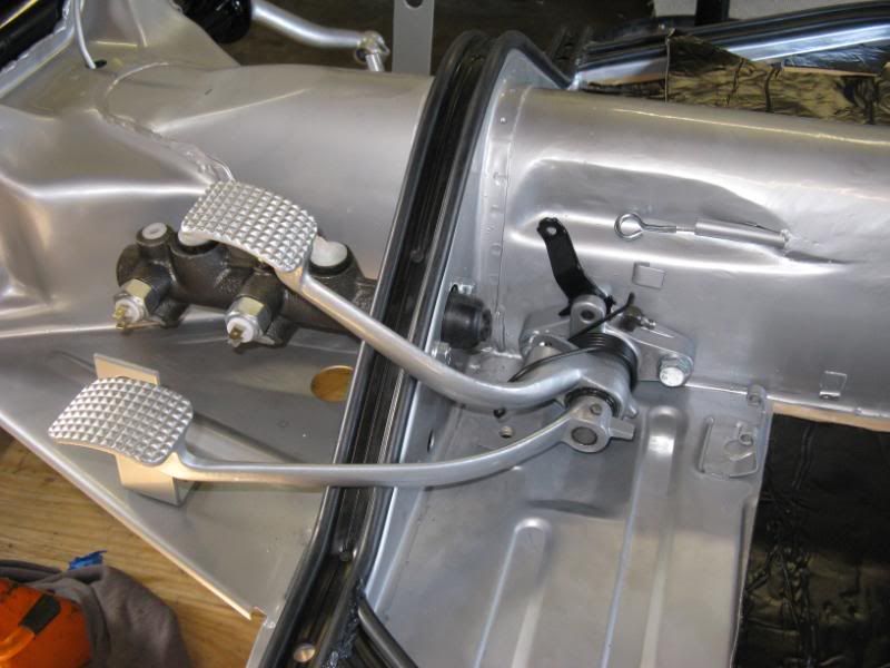

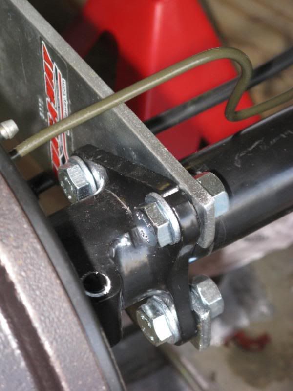

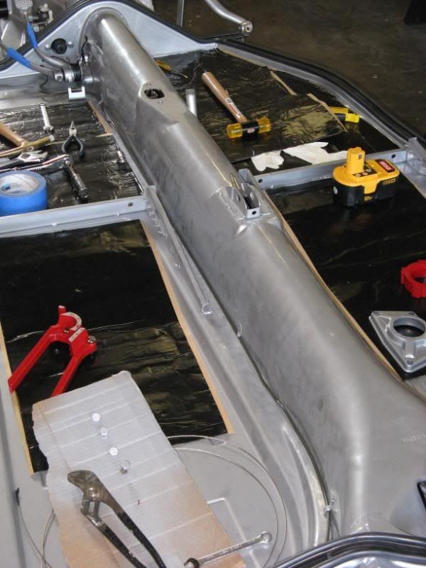

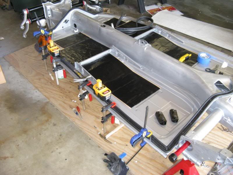

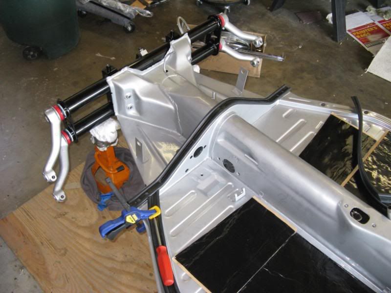

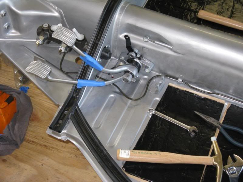

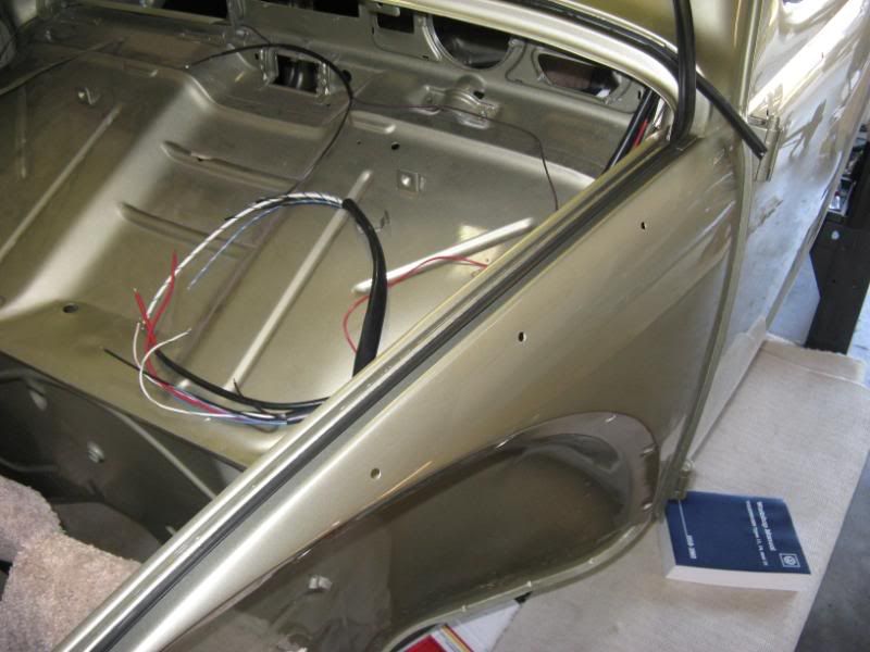

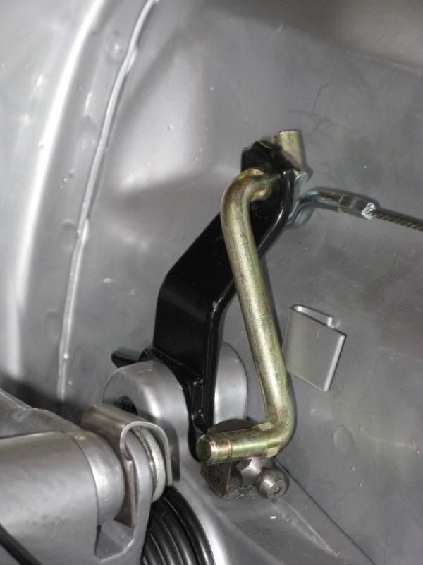

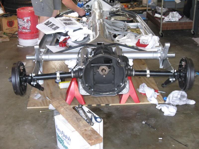

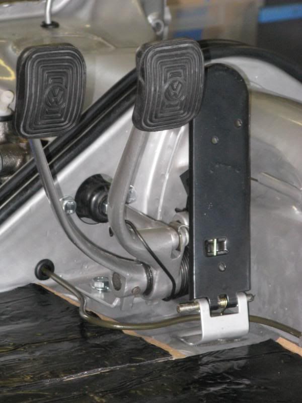

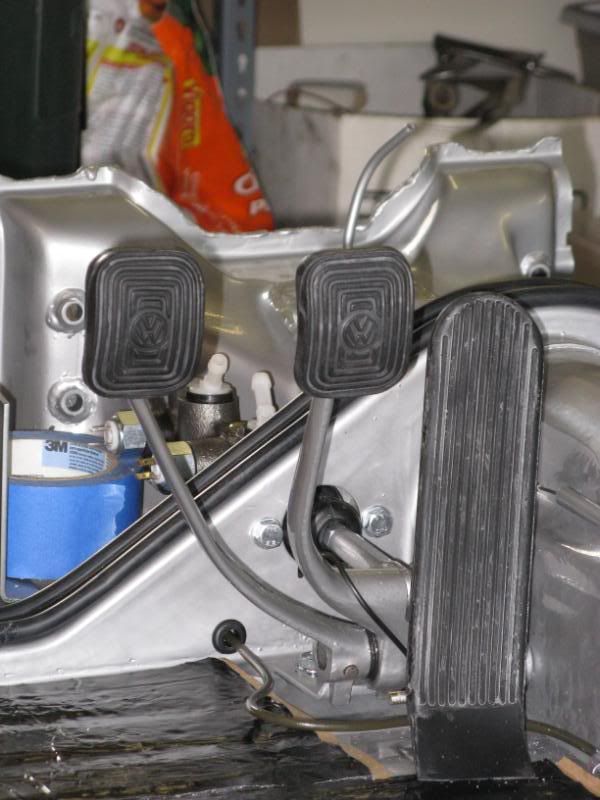

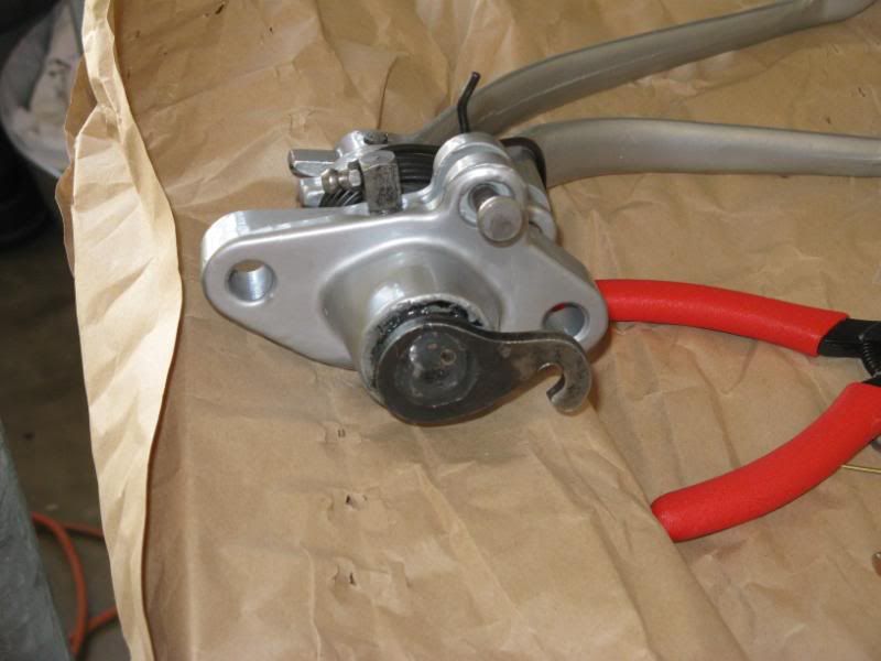

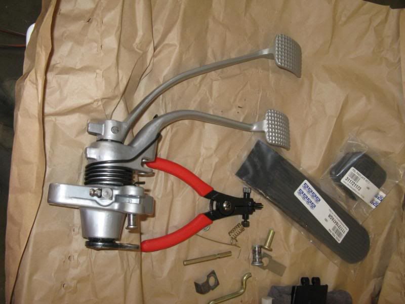

The pedal assembly fully rebuilt

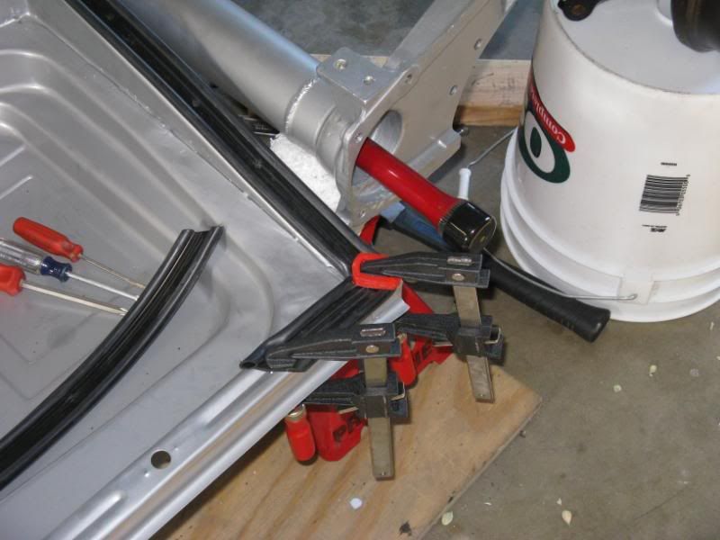

putting the pan seal on.

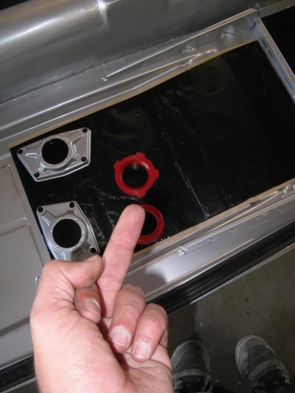

Fuck Rhino mounts.
more pan seal installation...

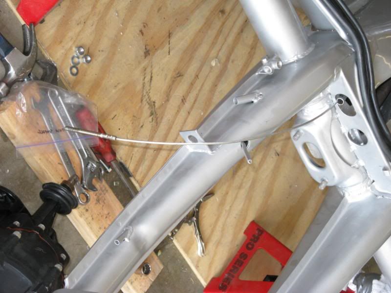

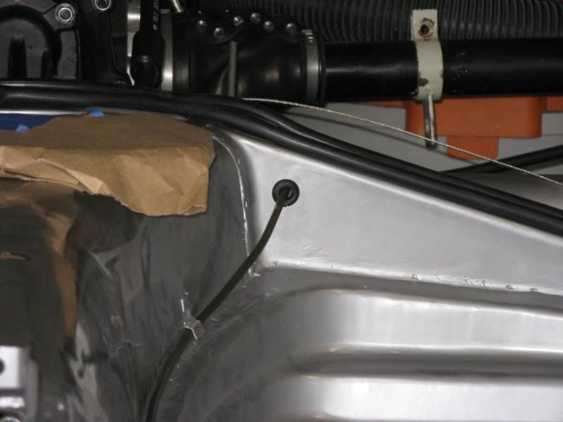

running the accelerator and clutch cables...
more gratuitous pan seal shots.
fuck poly spring plate bushings I went back to the stock rubber stuff.
fitting the pedal assembly.
semi progress shot
grommets.

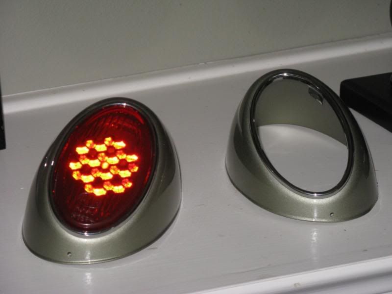

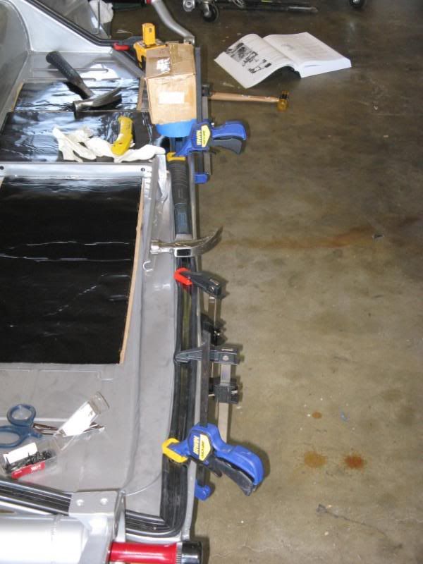

assembling the tailights. I pulled the filters out of them and polished the Hassia glass lenses up. They cleaned up real nice and the rings are repros from Wolfsburg West.

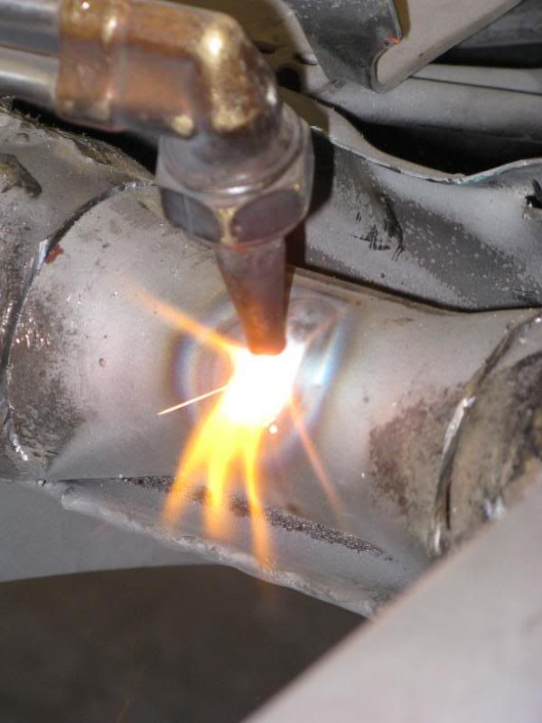

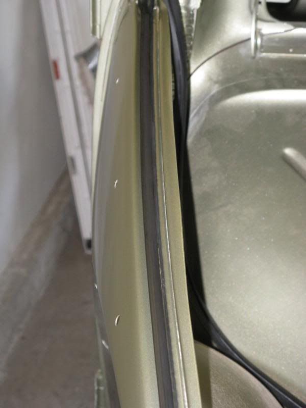

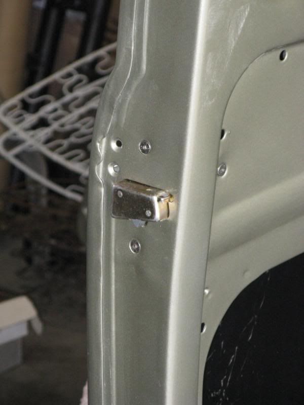

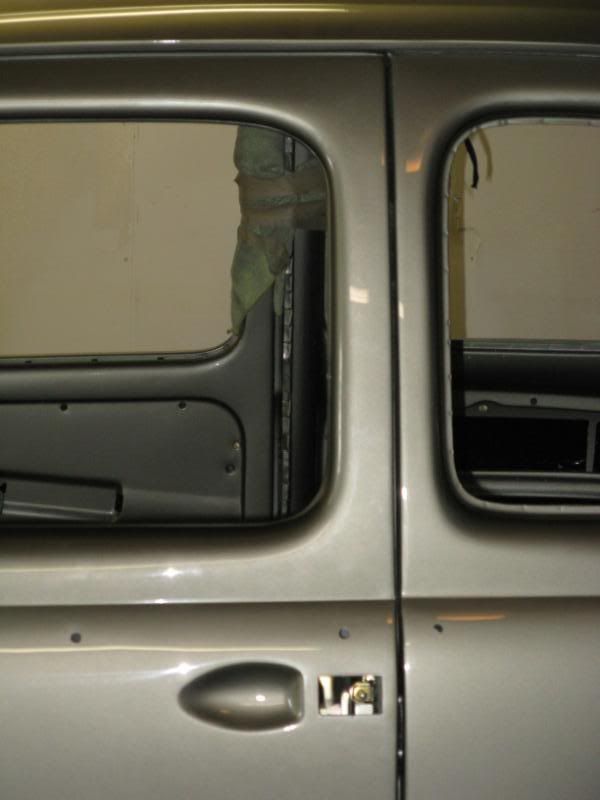

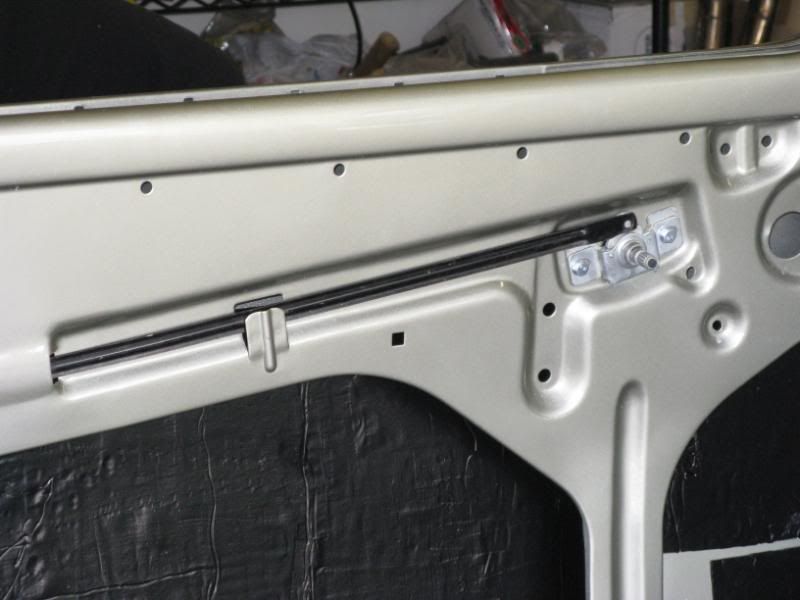

Putting the door latch system together. And having it stay shut all on its own.
our box breaker-downer showing his mad box breaking skillz.

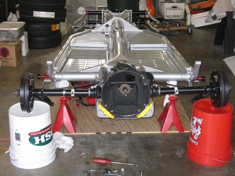

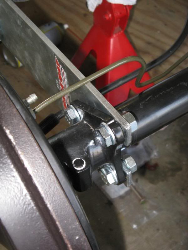

Assembling the adjustable spring plates and getting the axles bolted up. Notice all the new hardware. Almost the entire car has new hardware on it. If it doesn't have brand new its been chromed, powdercoated or painted. That's how far down this build has gone now. Evil or Very Mad The car now has different brake lines on it. It has stainless out back

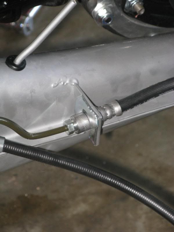

brake lines and new clips.
transaxle all bolted up and in its final position.
Accelerator pedal assembly getting built and fully completed.

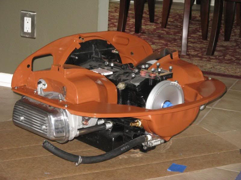

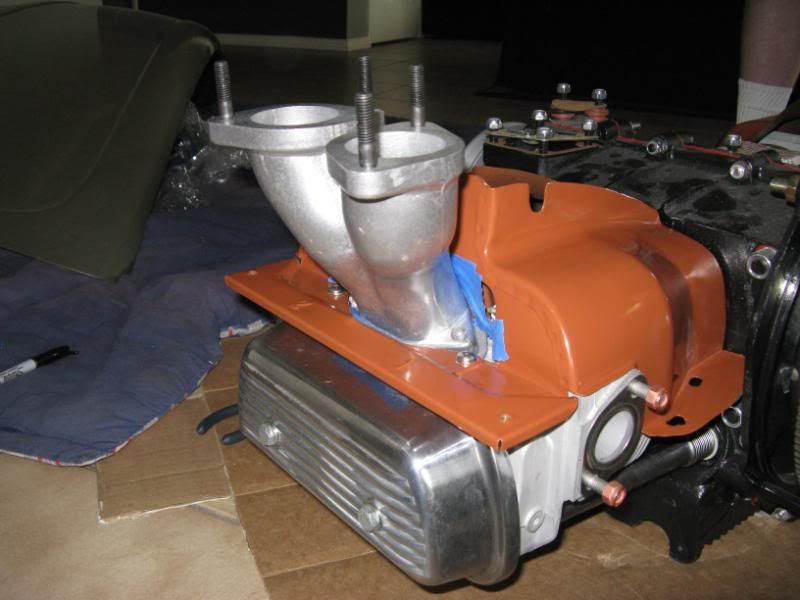

Putting them on and getting an idea what I had to trim to fit.

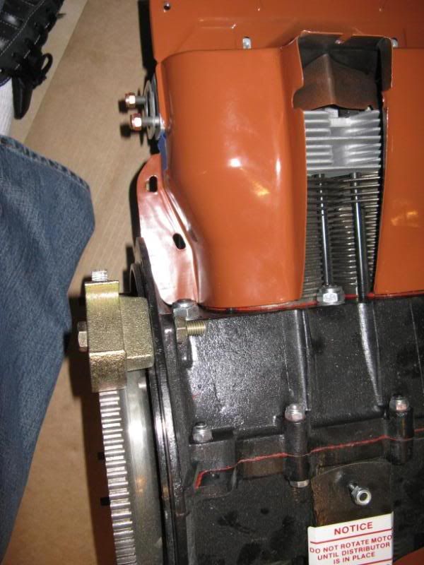

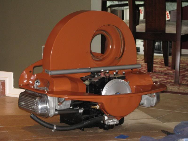

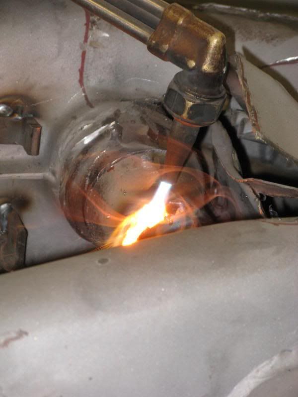

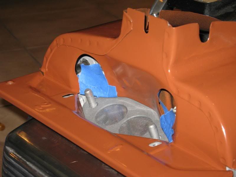

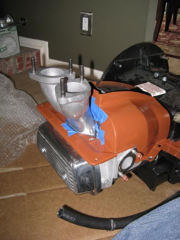

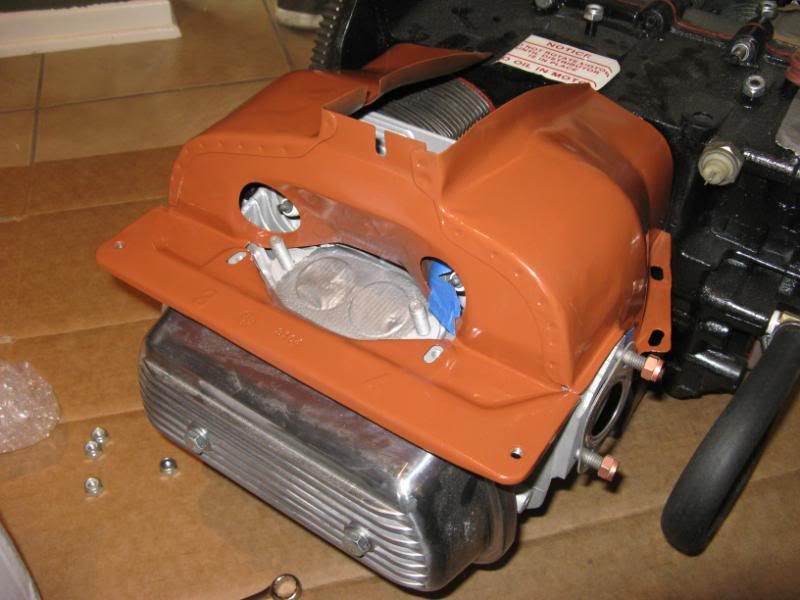

This is the test fit against the block and to make sure the airvanes were against the cylinder head. As you can see more adjustments were needed
Test fitting so tehy sat all the way back and getting them ready for the CB manifolds

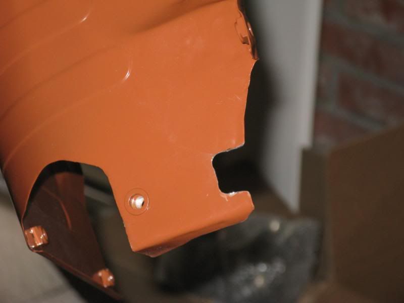

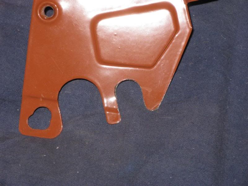

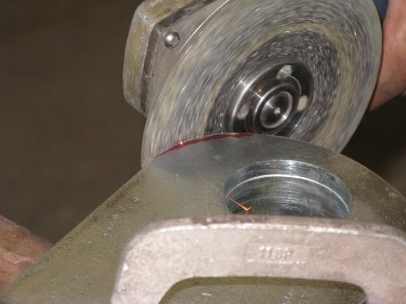

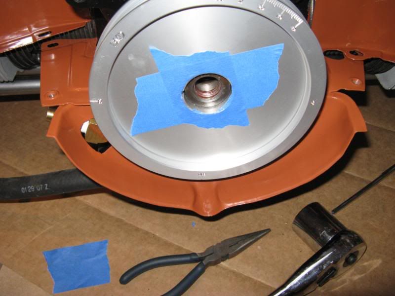

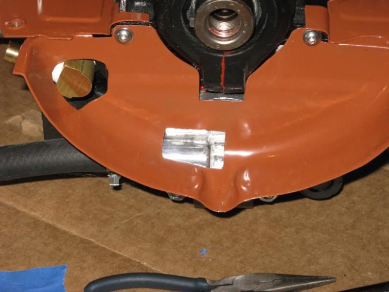

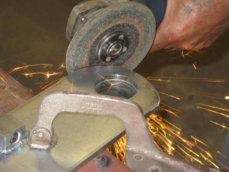

This is the piece that goes behind the crank pulley. In order to get it to fit right I had to trim the area around where the dipstick goes through it and cut it shorter so it went far enough back against the block.
The crank pulley still didn't fit without rubbing after all the trimming of it so I had to cut a hole out for the full flow so it would sit back all the way.
pulley tin clearanced for the full flow system.
Intake manifolds in place after the trimming of the cylinder tins.
This is the sled for the right side of the motor after I notched it.
This is all the upper tin fit on to make sure the fan shroud would mount tightly.
Shroud and plug wire tube fitted.
