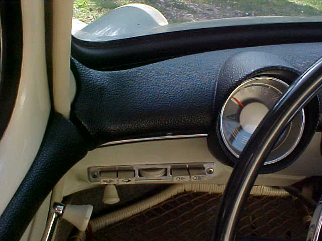

Finally got hold of a perfect pré '65 wrap around dash !
Got a collection of all generation dashes now.
First one in the world to take a photo of them all lined up ?
Want to share some knowledge.
Some education:
1
- Pre '65 wrap around dash - only type with closed ends to align with door top trim
- No vertical bar at the speaker grille
- Grille at the back
- alu collarred holes for the grab handle
- tabs across the back for mounting
2
- '66 - '67 only dash - type with open ends
3
- '69 - '69 only dash - type with open ends
- Vertical bar at the speaker grille
- No grille at the back
- Open holes for the grab handle
4
- '70 to '73 dash - type with open ends
- Plastic cover at the speaker grille
- No tabs across the back for mounting
I'll let the photos speak for themselfs ! Close up photos of them all there too !

Wouldn't #2 also be correct for 1964/1965 "N" models that didn't use the wrap around design?

I know there are at least 2 different types of wrap around. Early and late. But they are small differances and still fit.
Think so too - anyone can confirm ?
What? None in red?? or Teak.
Never ever seen one in real life over here in Europe !
Didn't know that. Anyone knows exactly what's different ?

Just so you know, #4 doesn't fit a 70, it's for a 71 to 73. A 70 uses the 69 style dash pad, due to still using an air box without a fan motor and torsion bars for the hood springs. I've got a 70 Fastback here (the wife's car) and I should know some of the little idiosychrocies (sp?) about them. Rolling Eyes

the differences between the early and later are the foam filled insides right? the earlier cars have the more solid dashes and wrap pieces while the later 64/65 are hollow?

EVERY '66- '67 I've EVER seen had the vertical bar in the speaker grille, like #3.

#3 is for 1970's also

You could probably make it work. The dash pad will fit, but a wraparound pad, the pieces that go throughout the car to match, doorpanels, and armrests will probably cost you more than you paid for your '68.

Wraparounds have a pair of "horns" at the ends that mate up with the other wraparound pieces that are at the top of each inner panel from front to rear on early cars and "S" models. It gives the impression that the dash "wraps around" the entire interior of the car, hence the name. It's hard to see from Berts picture what the difference is. Go look at some "S" models or '62- 63 cars in the Gallery and you'll get the idea. Wink
