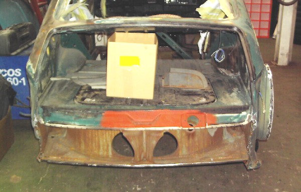

PostPosted: Wed Aug 16, 2006 2:27 am    Post subject: Reply with quote
http://www.thesamba.com/vw/forum/album_page.php?pic_id=296585
http://www.thesamba.com/vw/forum/album_page.php?pic_id=296586
http://www.thesamba.com/vw/forum/album_page.php?pic_id=296587
Oh yes, these are for real !
Cutting out the parts parts and replacing them with NOS panels !

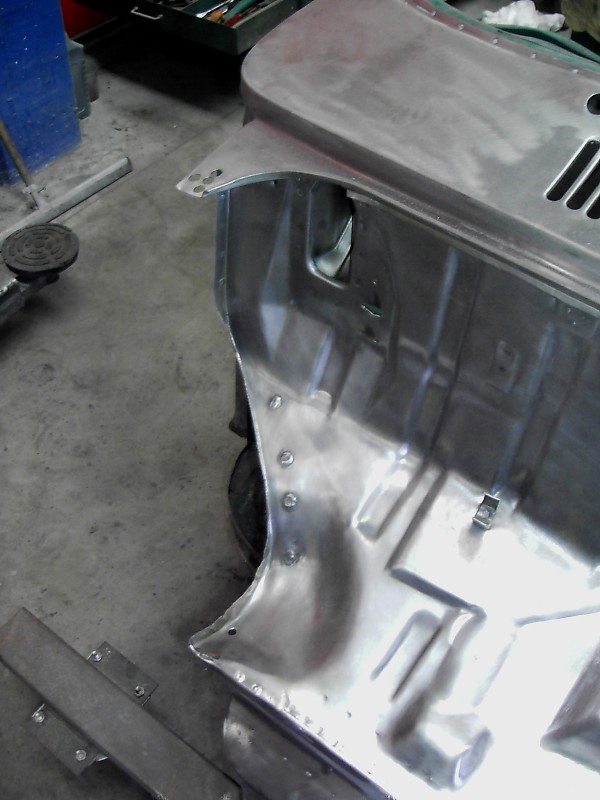

PostPosted: Sat Sep 02, 2006 11:49 am    Post subject: Reply with quote
Some progress today !
Overall vieuw with some NOS parts lying around
https://www.thesamba.com/vw/gallery/pix/299778.jpg
Close up vieuw of the fender whell edge - yes, that's a low mileage Euro car to you Smile
https://www.thesamba.com/vw/gallery/pix/299779.jpg
Removed the air box + water darin flap area
https://www.thesamba.com/vw/gallery/pix/299780.jpg
Removed the rear apron
https://www.thesamba.com/vw/gallery/pix/299781.jpg
Some better photos soon !
Next are the front fuel tank carriers and heater channnels !
BerT3

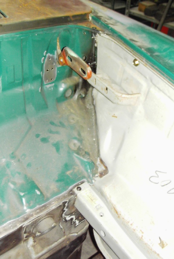

PostPosted: Mon Sep 11, 2006 9:30 am    Post subject: Reply with quote
https://www.thesamba.com/vw/gallery/pix/301622.jpg
https://www.thesamba.com/vw/gallery/pix/301623.jpg
https://www.thesamba.com/vw/gallery/pix/301624.jpg
https://www.thesamba.com/vw/gallery/pix/301625.jpg
https://www.thesamba.com/vw/gallery/pix/301626.jpg
Some progress - made me a new trolley which will stay until the body is finished and painted !
Where it's bolted to I already prepped it with a zinc coating after bare metalling
Welded in a square to prevent flexing while removing the heater channels
Everything was measured before welding !

PostPosted: Mon Sep 11, 2006 12:54 pm    Post subject: Reply with quote
Thread Hijack Warning!
Can somebody tell me the purpose of that rod that's welded to the left side of fasty bodies? The one above the wheel well in this pic:
Sorry BerT3, but inquiring minds have to know.
Tony
'70 Fastback AT/FI (daily driver (exept when the starter won't work, or it's out of gas, or I don't go anywhere, ...))
"...it is a well known fact, that those people who most want to rule people are, ipso facto, those least suited to it."
Help Improve TheSamba
blankmange
Type 3 Darksider
Joined: July 17, 2004
Posts: 11497
Location: Bloßer Stahl-preapocalyptic MidCoast
blankmange is offline
PostPosted: Mon Sep 11, 2006 12:58 pm    Post subject: Reply with quote
isn't that the cable release for the rear trunk/engine cover?

PostPosted: Mon Sep 11, 2006 1:08 pm    Post subject: Reply with quote
It is !

PostPosted: Mon Sep 11, 2006 2:27 pm    Post subject: Reply with quote
OH, duh!
That makes sense. I kept thinking it must be some strange stiffener that they only needed on the left side. What a doofus. d'oh!

The bodyworker removed the fuel tank brackets - did some work on the inner wing etc...
Currently the pieces are screwed together to get everything aligned - awesome job
BTW in relation with the previous update this progress was done in 3 hours !

Bare metalled the entire remaining front after cutting out the rot and removing remaining pieces
Note the 4 large spot weld and some hole for what I think would be a hole for wax oiling - this was kitted closed from the factory though
Roof + top sides will be bare metalled too - don't trust it to be sanded - and the etched primered
