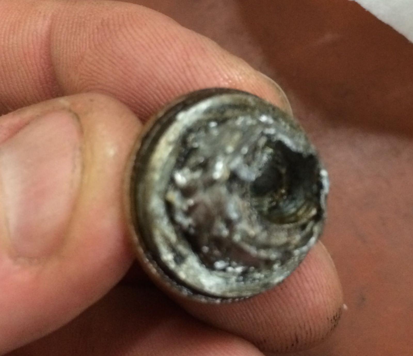

PostPosted: Fri Oct 03, 2014 5:39 am    Post subject: Irwin extractors from Amazon worked for me Reply with quote
I had a very rounded/mangled drain plug that would not budge. Even tried drilling is out with reverse drill bit but gave up cause drill wasn't centered.
I ordered this extractor set, tapped one on with a hammer and voila, drain plug out in 2 minutes. (probably the same set that Sears sells)
http://amzn.com/B0000CCXVZ
Well worth the $20
And make sure you order a new drain plug with new crush washer then only tighten to 10 ft pounds.
