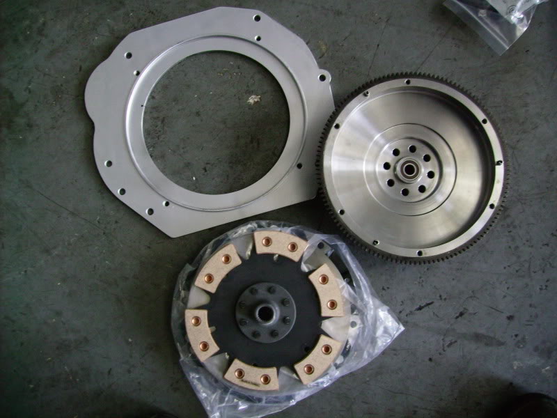

These are the parts I have on hand or enroute:
H6 engine, wiring harness, computer, ignition key transponder, RJES bellhousing, fuel pump, engine mounts, throttle cable, VSS, filters, clutch shaft, starter, flywheel, clutch disk, pressure plate, SmallCar header, and assorted bolts. _________________ 1990 Feldjäger Syncro AAZ

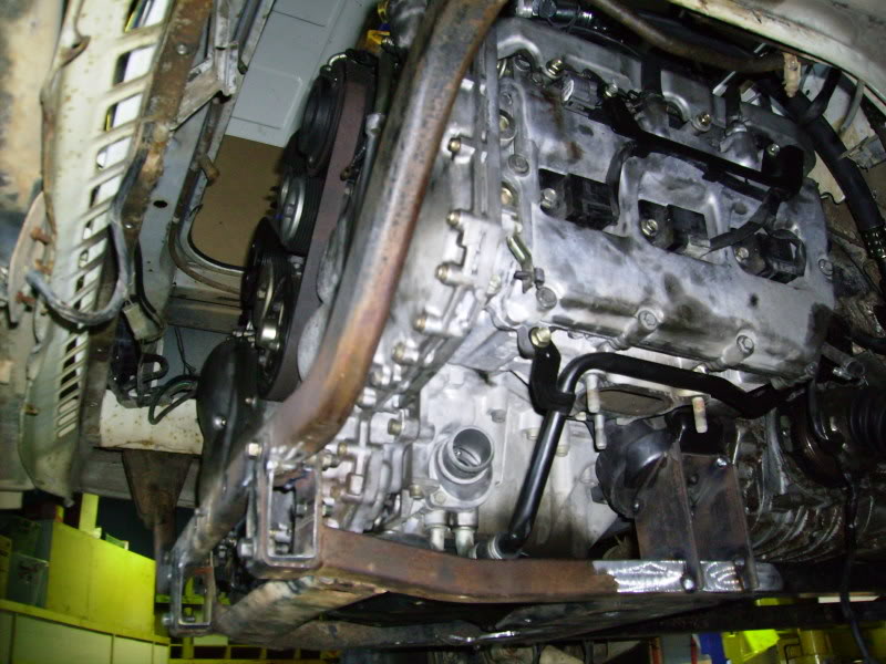

different project I was admiring a year ago in australia--
someone said they wanted related photos-so here
I thought these might help--not trying to steal the thread |

Yeah, um, NOT stealing it... more like helping me to see what it will look like. Thank you. What is this black box? I don't have that one. The starter I have is a reman from my shop. Who did the engine carrier, and where can I get the schematics for it? I think I could find a German guy here to fabricate it for me....

oh, I wish I did. I'll look out there for it. I found this last january while researching my second project. the vintage is
2001 to 2004 from an LL Bean outback. very difficult to find. this was a synchro conversion with the obvious conversion
bell housing plate and flywheel. It will lay aft that much further than yours. this guy welded a bunch of steel under it for
protection too. kind of heavy. He left the cat off too. strange, because this was the cleanest engine subaru
had built to date [emissions]
the black box is the vanagon ecu and shield...is that what you are referring to? I'll look..... |

No, I didn't get one from him. But he did tell me which one to get. A starter from a manual xmsn Impreza, NOT the automatic.
The clutch is for the turbo Impreza, the clutch disk is a 228mm from CB Performance, and the pressure plate is for the same turbo'd Impreza. _________________ 1990 Feldjäger Syncro AAZ

I would factor in a gearbox rebuild in your budjet, I have seen the gearbox from the above syncro conversion and it is not pretty what a H6 can do to gearbox. It smashed the pinion bearing nut, destroyed the crownwheel and pinion and pushed the pinion shaft into the gearbox.
Syncro boxes are very hard and expensive to come by here in Australia.
Vanagon boxes are probably cheap and more plentiful in Germany, but an overhaul and some heavy duty internal would be a good choice. |
