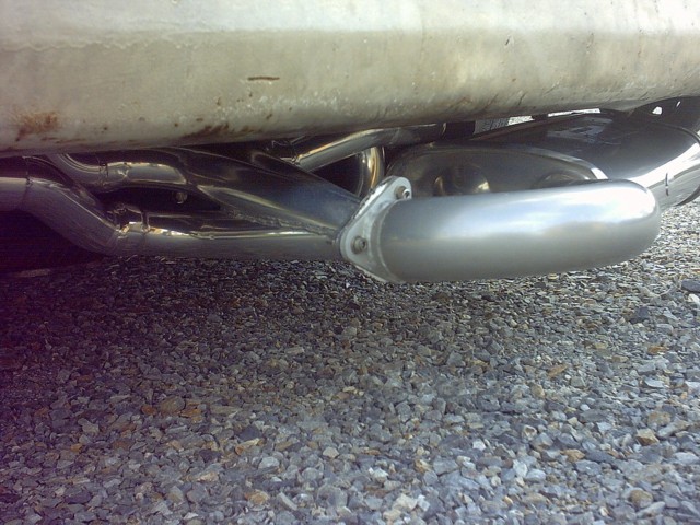

| OK I gotta ask, what exhaust do you have on that thing? It sounds like an 8 cylinder from the inside of the bus. |

| Back to top |
