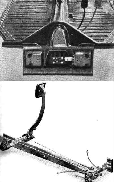

Does anyone have an exploded view/picture of the handbrake adjustment mechanism for a pre 55 Oval.
My chassis came in bits and I have a bag of parts I have now cleaned up and want to fit as soon as I can.

THese are the only pics and diagrams I've seen of the early long-pushrod style emergency brake setup:

Cheers Andy, that's a good start as I have all these bits to fit Laughing

You're in luck as it looks that almost everything is present. Finding some of those little pieces can easily drive you mad.
I said almost because you don't have the tiny split pin that goes on the very end of the push rod. But those can be bought at a hardware store for pennies.

I hope you have the threaded pin still in the brake shaft, that's another piece not in the pic Cool

yep, got the handbrake rod and the threaded adjuster in the end, all cleaned up and smooth Smile

Why exactly would they set it up like that? A rod goes all the way forward to pull the rear brakes?

It was up there because it was where the cable-operated brakes on Standard models were adjusted. It took them a few years on Deluxes before they changed the design. From the KdF Wagen manual archived on TheSamba, this is a pic of the cable-operated layout.

So is the handbrake pushrod the reason the 53/54 models had the heater knob behind the the handbrake?

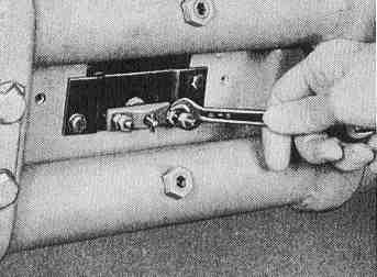

Sorry to bring this post up again, but I have a metal plate that is bent on the upper and lower side as well as having a square hole in the middle. Where does this go?
Does this plate have a small round hole on each side? If so than this is the plate that holds the ebrake pushrod spring in place and under tension.

Here is a pick of the two plates I am talking about. I have the plate that screws in to the framehead and these two in addition.

The bottom piece goes on the e brake rod followed by the top piece. The e brake cable threads come thru the holes on each side and 2 nuts are threaded on each cable. Also a pin is driven thru the shift rod tip.

That was basically what I thought, but I was unsure wether there should be something between the plates. Thanks a lot for the help.
