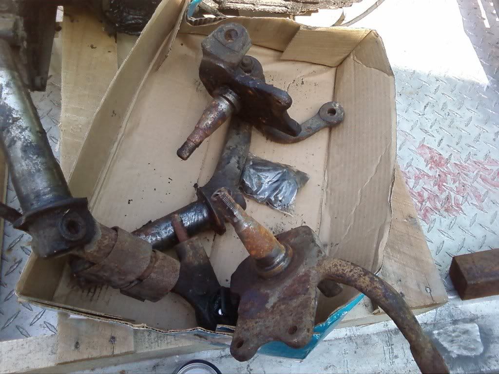

Ok I have this extra front beam and am thinking of rebuilding it for the bug. I figure I can use 2in square tuming to replace the lower shock towers and bracing/gusseting the uppers and patching the holes. I am also converting to ghia spindles and discs and cutting and turning the beam 1/8 in. Will it work or be a waste of time?

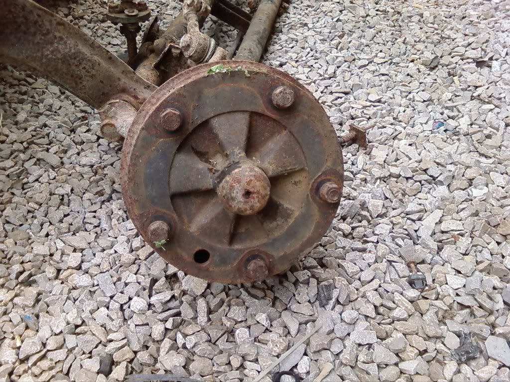

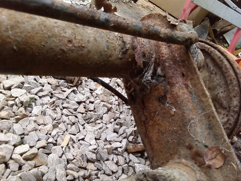

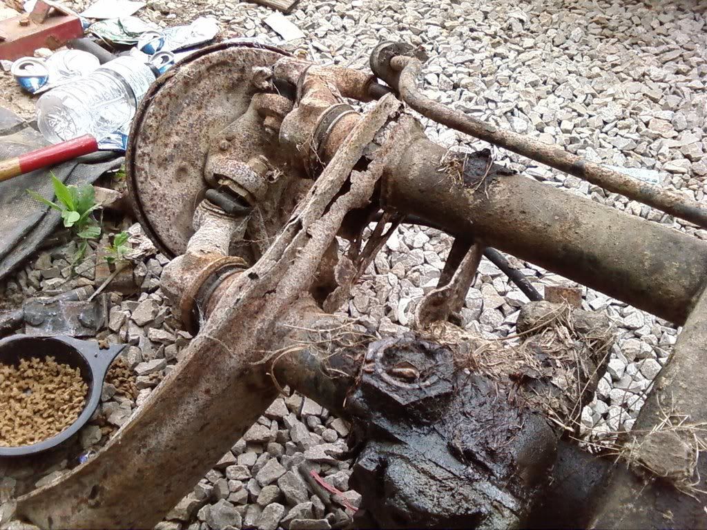

The swaybar looks good enough to cut up and put into your tie rods... The rest looks pretty bad. You sure you wanna spend all the time on that one?

Dunno, thought that 2in tubing could be cut with a hole saw to replace the lowwer parts of shock tower, upper parts arnt THAT bad, have a new bushing kit, and will get new ball joints, so the shock towers are my bigest concern. I would like to get one ready to bolt in cause I am driving the bug every day and dont want it down long so looking for opinions I guess.

I'd look for a better beam. I see them for $50 bucks all the time. Then again, I'm not in BFE Ohio.

before ever beginning a beam rebuild, it's also a very good idea to see if it's actually straight or not.

Just use a straight edge to check?

yup. straight edge along the back of a beam tube.

I wouldn't spend much time at all on that beam friend.... ball joint beams are not so hard to find....
If your spending time fabricating on somthing like that, sticking a Link Pin frame head on your car would make more sense. MAN UP!
You can do all the work on your "go-fast, turn left car"....you can buzz a link pin head on....
(just don't go building any camber into whatever beam you choose......this car has to do more than left turns...)

I would throw beams into nearest dumpster..... Other parts "may" be salvageable.....
http://aircooled.net/new-bin/viewproductdetail.php?keyword2=SSB0002&cartid=0617200856260315
Check pricing here..... Stock BJ beams...$155....
Complete Spindle to Spindle about $400 (w/lowering adjusters)..
I mean its the front suspension of your daily driver.....
