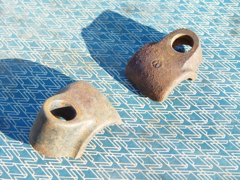

PostPosted: Mon Dec 14, 2009 7:35 am    Post subject: Reply with quote
what are these for? i just found them in a stash of parts I uncovered.
Posts: 71865
PostPosted: Mon Dec 14, 2009 9:27 am    Post subject: Reply with quote
They are Kombi seat mounts.
The tall C-clamp would be for a middle seat.
Both C-clamps have nubs so they are '67-up.
