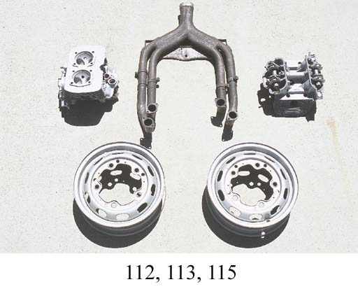

Does anyone have pictures of the inside of a sebring exhaust? I have searched the net with no luck
But here is a pic of the outside from Mr Okrassa
https://www.thesamba.com/vw/archives/lit/56ghia/cover.jpg

PostPosted: Fri Mar 06, 2009 12:07 am    Post subject: Reply with quote
Cool vintage exhaust! That one is for the 550 spyder isn't it?

well, it might be for the 550, but here are some more pics to consider:
