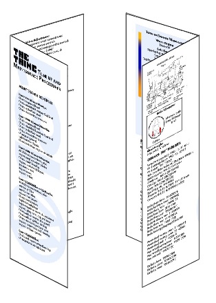

Hi again everyone.
In addition to the BN-4 Heater diagrams that were added recently, there is also a tune-up cheat sheet which I cooked up several months ago and submitted, but it occurs to me that I never made any sort of announcement. Look for it in the Samba Technical section (Technical>Manuals>Owner's Manuals:Thing>Tune-up Cheat Sheet). It prints out on a single letter-size page, and then folds to make a booklet that will fit easily into a toolbox or tool roll.
Cheers,
Spalding
Features:
Maintenance schedule
Tune-up/maintenance workflow
Procedure notes including parts, tools, and specifications required for
- Oil change
- Compression test
- Spark plug check/gap
- Valve adjustment
- Distributor cap and rotor check
- Condenser test
- Ignition timing
Notes on brake, carburetor, and clutch cable adjustment
Common maintenance part numbers
Here's a low-rez .jpg from the gallery. Rather than downloading it, I suggest you get the .pdf file from the technical section. It will look much better when printed.
