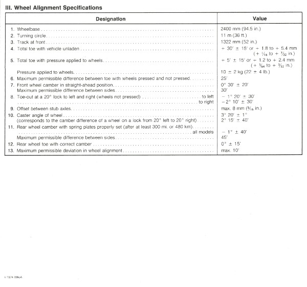

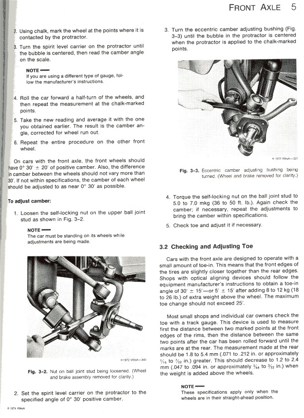

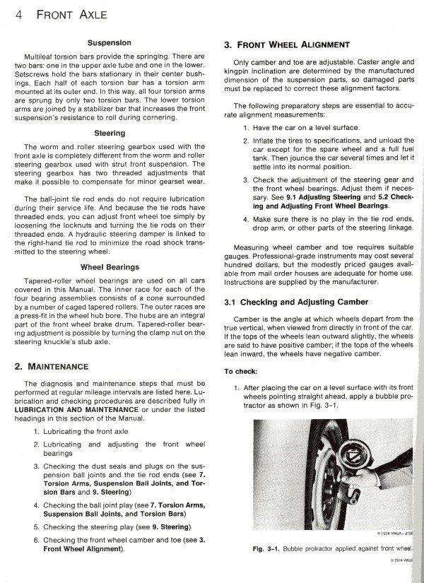

A few more helpful pages of Info.
If you want higher resolution copies, email me.

The measurement is not taken at the wheel for that on the King and Link. It is done at the trailing arms with the spindles off. Grab the trusty Bently and it will show you. You don't have to have the VW measuring tool (helps). You can use a straight edge (metal). get the measurment and place the shims as per the book and you'll be there. Very Happy
Current:74 Ghia Coupe w/ 2276
71 Ghia Vert w/ 1835
07 GMC Truck
12 Jeep Wrangler
73 Harley FLH 93 cid
89 Harley 883 Sportster (1200)
Owned before: 58, 69 Ghia Coupes, 64 Canvas Sunroof, 68, 72, 73, & 74 Bugs, 63 Single Cab, 65 Bus, 66 & 70 Camper
" Duct tape can't fix stupid, but it'll muffle the sound".
tb03830
Joined: December 02, 2009
Posts: 1045
Location: Leavenworth, KS
tb03830 is offline
PostPosted: Sat May 15, 2010 10:34 pm    Post subject: Reply with quote
I was using the tire as an example of how bad it is. I understand wear to measure the gap, but thanks for the info. I was unsure of other tools that can be used.
"Sic Vic Pacem, Para bellum - Pray for peace, prepare for war."
1964 Convertible Bug - 1600cc SP engine with a stock H30/31 Carb and SVDA Distributor - Swing Arm Highway Flyer Tranny, Gene Berg's Temperature Dipstick, 2.5" drop spindles, 2" narrowed adjustable front end. Chromed OEM fan tower.
tb03830
Posts: 1045
tb03830 is offline
PostPosted: Thu May 20, 2010 1:07 am    Post subject: Reply with quote
Ok, I took the entire front right wheel assembly apart and found 4 extra shims and the numbers used were not even close what they were suppose to be. WTF...previous owners Rolling Eyes The parts were in good condition. I am bleeding the brakes now and will let you know what happens but I think the shims were the problem with my negaive camber issue. Just for future referance; my 1964 Vert had an "Offset of 6.5mm". I do not know if that will help anyone else but that's what mine had.
Thanks guys for the help, I learned alot about camber and toe issues. Very Happy
