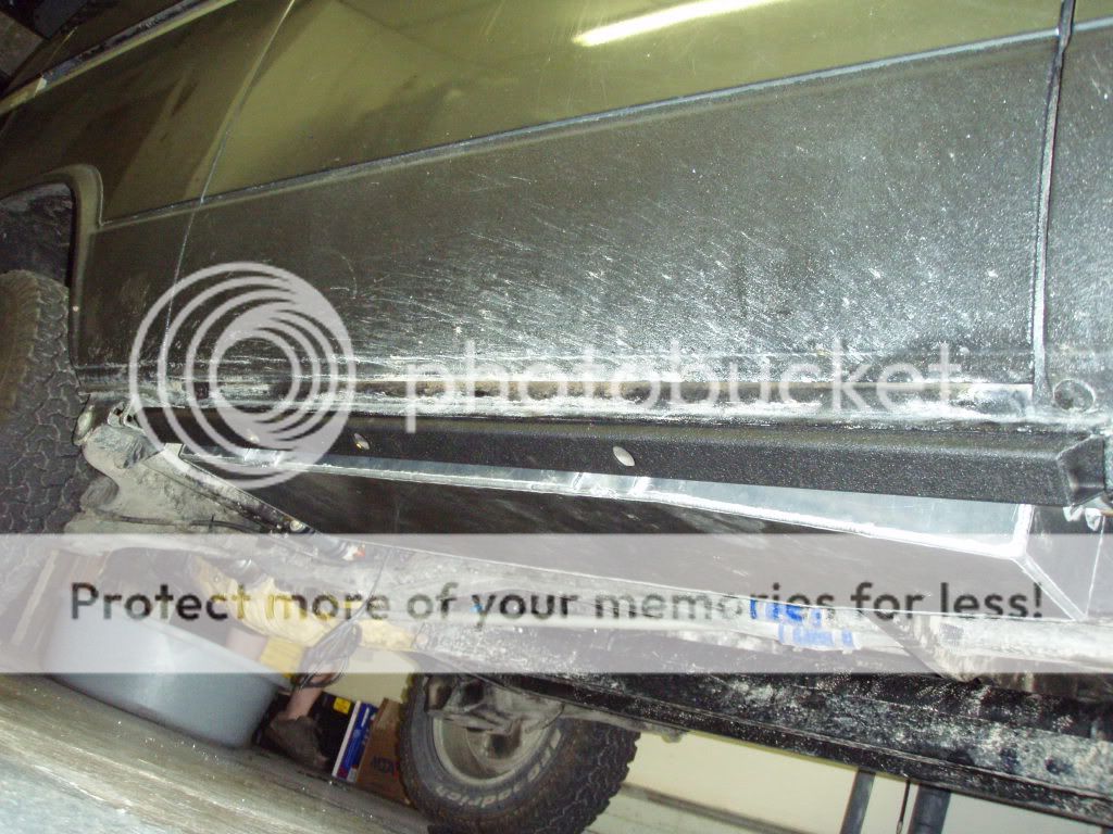

howdy,
Up in Anchorage at the moment and finally have some time to do some posting.
Here are some pictures and info about a 10 gallon auxillary tank that you add to your Syncro.
I got the tank form Alaric H.
It is all aluminum can be mounted several different ways.
We chose to weld on aluminum 90 degree mounts (4)
PARTS USED:
2wd filler neck and vent line
2nd fuel pump (I got a high flow one from Summit for $80)
Ran a wire up front for my switch
Brass T to tap into the Syncro vent line
I used coolant line for the filler neck up front, but will be changing it with something custom soon.
I have to load more pics of the filler neck set up, but you get the point
I fills in about 15 minutes and I can hear the pump change sounds when the tanks is empty. Very nice when gas was 5.50 gallon in the Yukon

Here is my aux tank installed.
