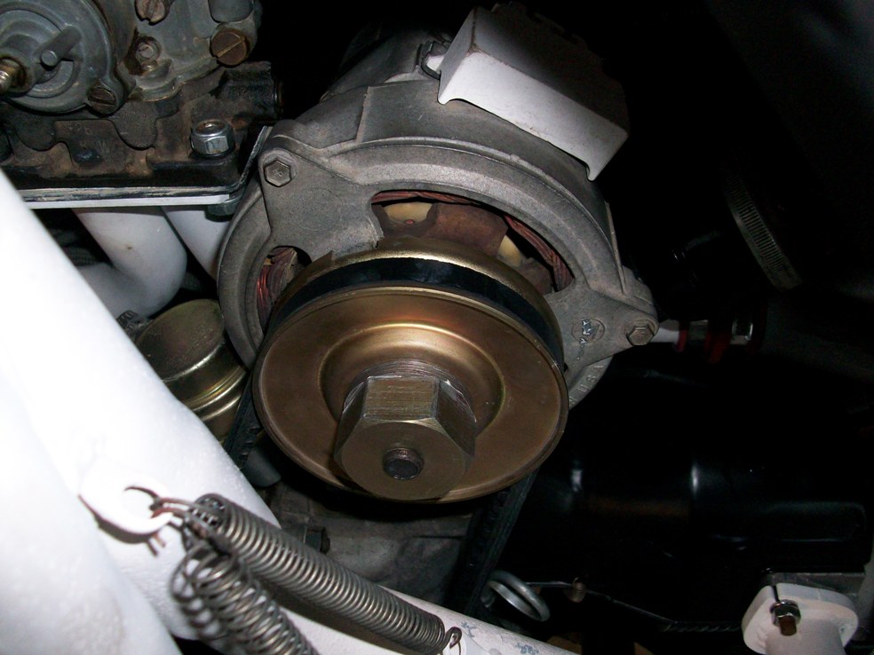

PostPosted: Mon Sep 13, 2010 8:38 pm    Post subject: Reply with quote
I run a Porsche generator pulley on my alternator, but I also run a Saco power pulley. I estimate the fan spins pretty close to stock speed with this combo. If I want to spin the fan slower in the winter or for more horsepower, I can just switch to a stock VW generator pulley. Very simple.
Thanks for posting your Porsche Pulley photo. What it's size to do some math?, also what is the belt size with using T1-D Pulley.

PostPosted: Tue Sep 14, 2010 7:42 am    Post subject: Reply with quote
pharos, the stock pulley is app. 4 1/4" and the Porsche is 3 3/4". The belt I use is a Conti 10X888. A bought my pulley from Bernie Bergmann about 9 yrs ago. I don't know if he still sells them.
Hope that helps.
FYI, the ratio between my alt & crank pulley is 2.2 to 1.
