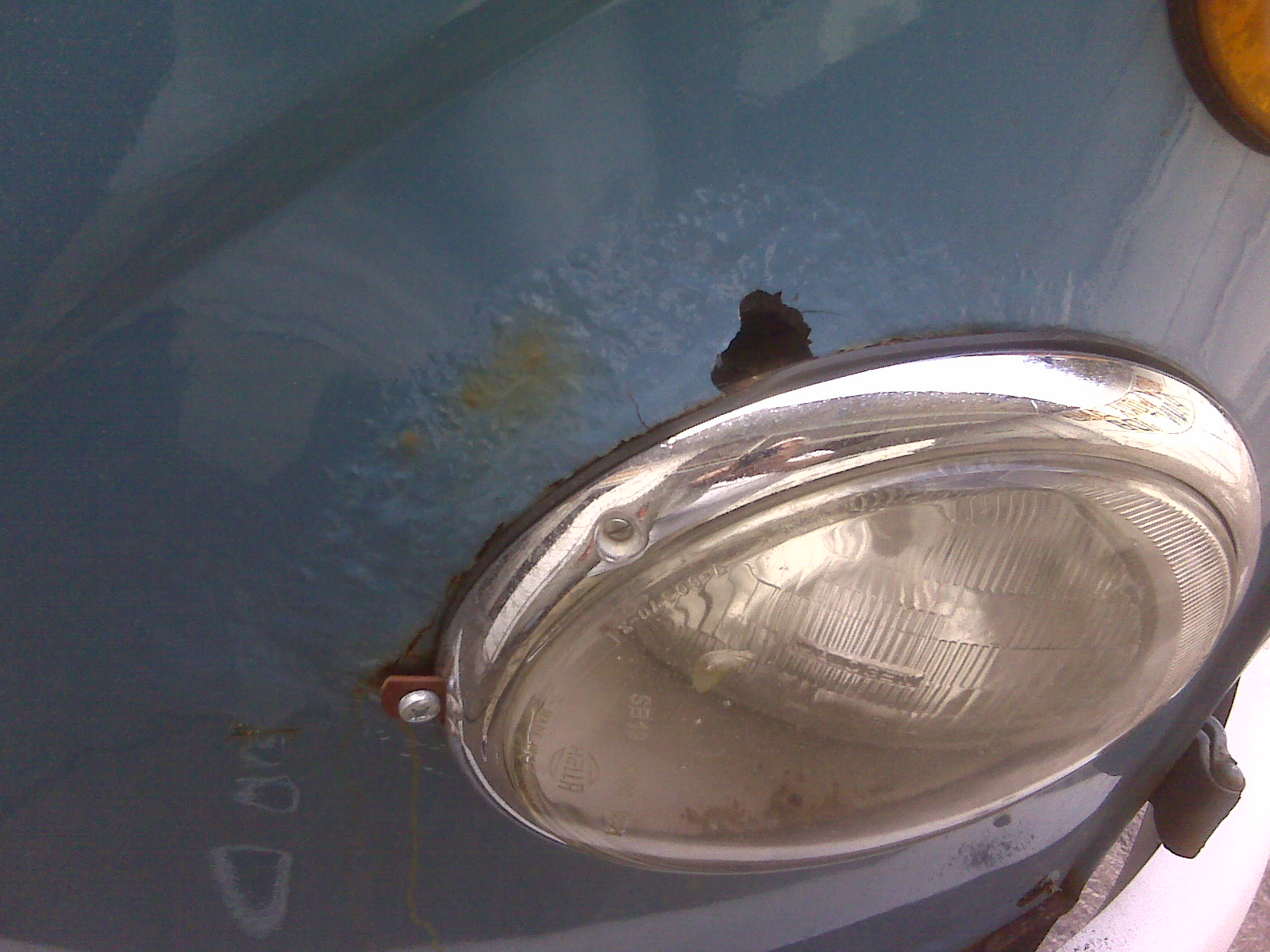

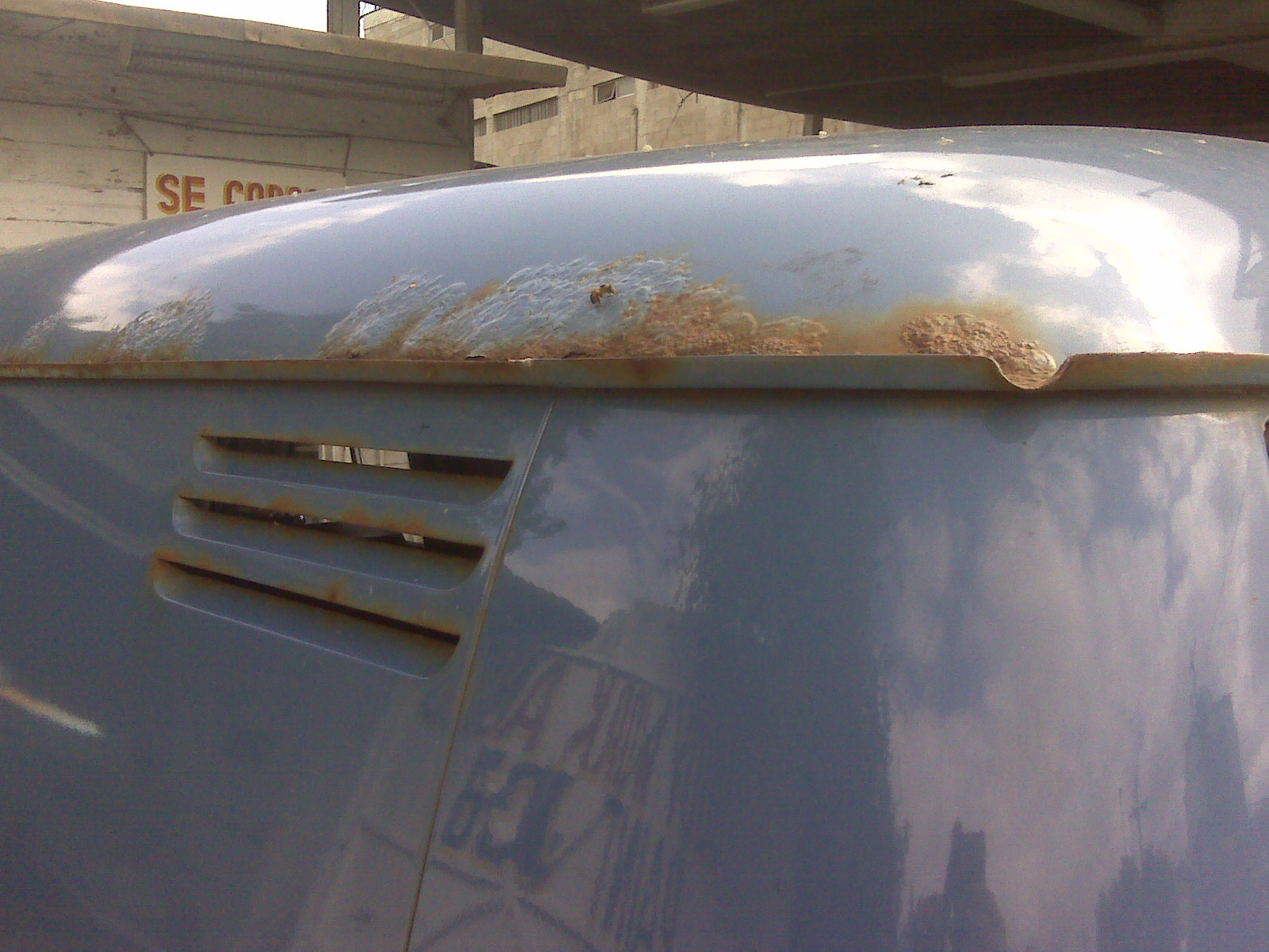

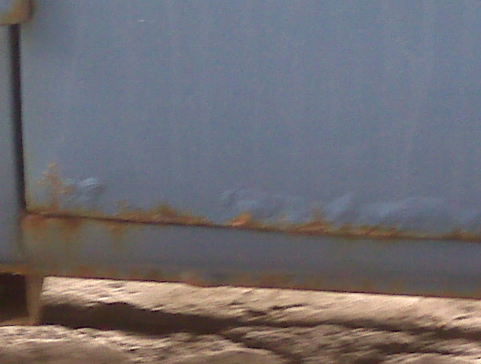

I am starting a new thread because after searching this topic I found no one who actually documented anything. I will do the best I can to document the work being done on my 64 transporter panel in dove blue.
My spanish is pretty good making things a bit easier than most gringos. I also live half time in Mexico but much further south, not in Tijuana. But I do have friends in Tijuana and nearby so that helps with logistics.
The bus starts out with a second paint job that after the bus sitting for several years near the beach and under trees had a LOT of rust. I managed to find a donor roof from a 58 panel that had most of the drip rail and also had both upper side vents - the roof was cut from on top of the beltline. This I took down to them and it had to be entered into Mexico by way of the Otay commercial gate. Paid $25 in customs duty for a roof clip I paid $10 for.
I bought and took a supply of Rustoleum brown primer, Rustoleum black, and grey. Entire outside will be sprayed with the primer as will the interior of cargo compartment, not cockpit. The cargo compartment will be finish painted with grey. The undercarriage chassis will be sprayed with Rust Mort and Rust Mort will be used on other places in prep of the body. I brought a supply of foam brushes for this purpose. The undercarriage will be painted with primer then finish painted in Rustoleum black. I brought mineral spirits for the Rustoleum. I provided them with the PPG and DuPont paint codes.
Included in the work will be replacing the stock rear window with a Wolfgang safari rear window bought from Pimppride in Carson (great guys!) I am also having a different configuration fabricated with the side vents in the cargo compartment. Since the donor roof will provide vents that are 'outies', inside I will have the old 'innie' vents welded and sealed inside to minimize water coming in. Also will be painting the bumpers and wheels. Bumpers in white, wheels in black. All door handles, trim, etc will be removed for painting.
The engine compartment will not be painted but the inside of the compartment door and muffler skirt will be. The compartment and gas tank will be painted when the motor comes out some time in the future.

Here are links to photos in gallery of the day I delivered the van:

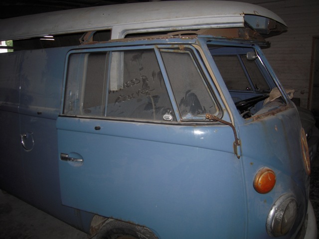

I just got these photos from a friend who check the bus last Saturday. It looks like they have done a nice clean job of cutting the old roof and the donor roof. They got all of the mis-matches like the tail gate and side doors taken care of. I imagine this week will continue cutting the donor roof and then marry the two. The front glass is out so this might be a good forced decision to put in safaris. I will be visiting the bus this coming Monday next week. More photos and body shop report to follow.

I work with three Mexicans from Vera Cruz, they started laughing when they saw this and indicated that now is the point where the stupid gringo shows up, they show you the roof cut off of the donor, your roof cut off of your car and they say that it will now cost you twice the original estimate to put it all back together......cash up front!
Notice they aren't working on it, it is a storage rack for newer cars bumpers?
My guys don't ever speak highly of the business ethics of their countrymen!

doesnt look like a mid December finish or even a bit later. good luck. will be staying tuned for the outcome of this project.

small hatch white top and big hatch blue bus.
is Mexico an extension of columbia previous owners club????
looks like it is a storage shed right now.

Notice in my photos how they have done the cutting and preserved the big hatch mechanicals and roof arch rib/frame. The fresh air vent is a bigger issue and I hope when I am there next to see how they worked that out. They planned to preserve the '58 vent saying to cut and reweld the '64 into the '58 donor roof would have bad results on the roof skin. I think the ID plate will have to be moved then, too, and we have discussed this. I'd welcome any helpful info or ideas on this vent matter since I have searched the Samba without any luck finding anything.
