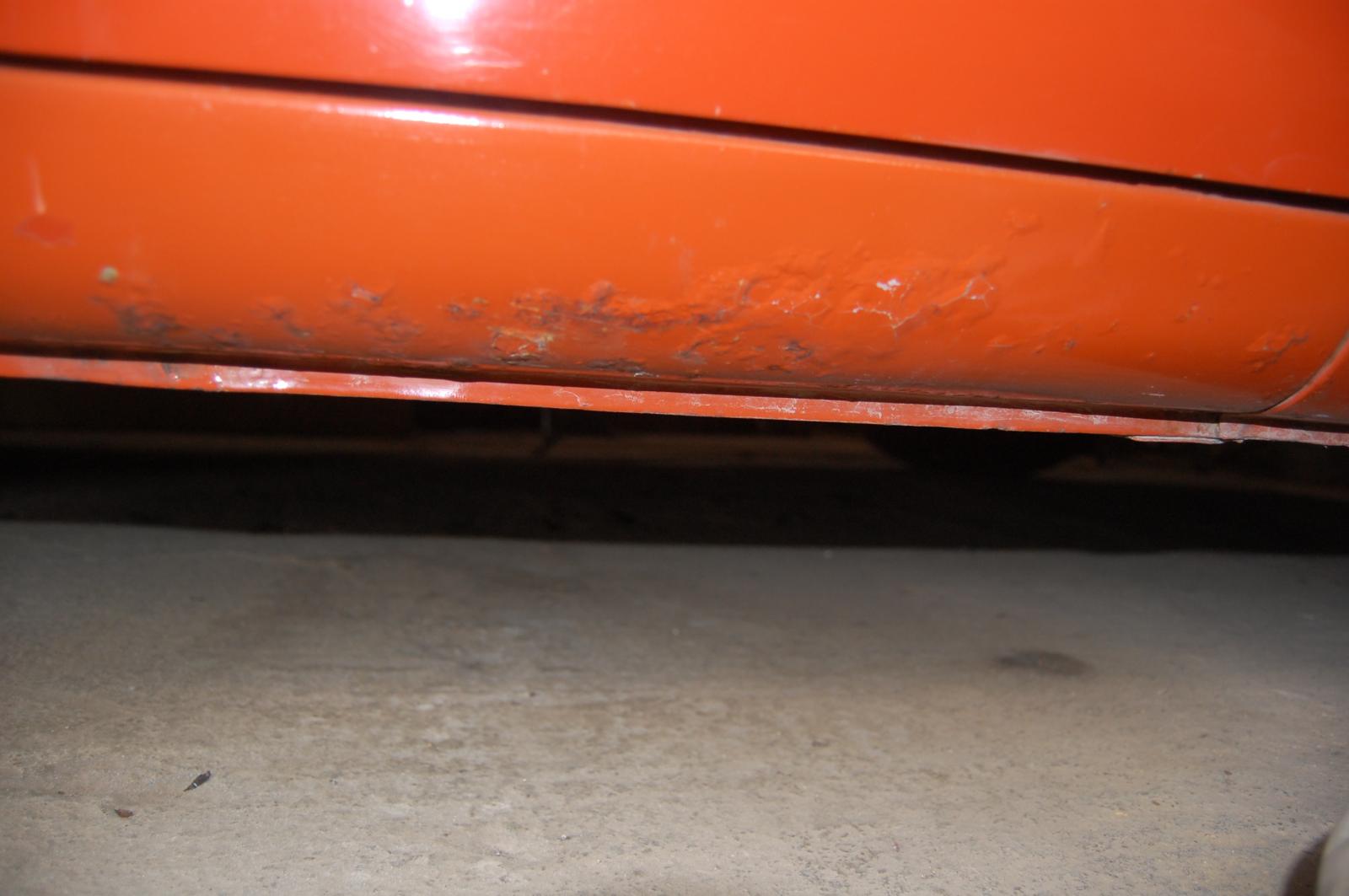

Well I suppose I should hello first really! I've been posting here for a while now, mainly in the bay bus forum as my 71 camper has been the focus of most of my attention until recently. Anyway, I thought I'd share some pics and thoughts on the heater channel/rocker/qtr panel replacement I'm currently undertaking on my 69 ghia coupe. I know there's several body off resto threads (paticularly 'verts) that have included pics and notes on repairing this region but I couldn't find much in the way of body-on-pan channel replacement pictures or many close ups of how the channel & rocker assembly mates with the pillars. So, for your viewing pleasure, I've included as many relevant pictures as possible of the work I've done so far which hopefully will be helpful to anyone who's contemplating such a repair themselves. Please note, this is not intended as a 'how to' on channels, only as a record of what I found and how I tackled it. I'm not a pro, but I have been around A/C VW's for about 15 years and in that time I've had the pleasure of tackling many unpleasant jobs, including beetle heater channels and a host of bay window panels so I knew what I was letting myself in for.
A little background on the car...
California car until 91, in the UK after that, owned for 5 years, my daily drive for 4 years, very few body repairs until now, just a couple of small patches here and there. I'd noticed the paint on the RH rocker starting to bubble quite extensively after the winter this year and had a peek underneath and saw the inner side of the channel had started to flake away in the middle too so I knew I had to do some investigating...
Time went by, the MOT expired, the tyres on the Riv's went flat and a thick layer of dust gathered on the cover...
I ordered an outer rocker panel and an outer rear quarter and set aside a weekend to start some repairs. I figured I'd cut what I needed from the repair panels and graft them onto the existing bodywork. The inner channels as viewed from inside the car looked perfect and (amazingly) the car wasn't leaking water into the floorpan even driving in heavy rain, should be a quick job, just trim these bubbly bits off and away we go!
Uh oh...
That explains why only the faintest wisps of warm air ever reached the windscreen...
You'll notice how I even optimistically started to drill out the spot welds along the lower lip, there really was no need, the entire thing came away in my hands.
