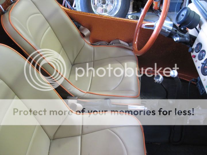

jsturtlebuggy
Joined: August 24, 2005
Posts: 4627
jsturtlebuggy is offline
PostPosted: Thu Mar 03, 2011 10:02 am    Post subject: Reply with quote
This is my buggy with a CNC steering brake mounted just in front and to the right side of shifter.
I did have to weld tabs on to outside of tunnel to support it and used 1/4"
nutserts/rivet nuts in tunnel to mount to.
When I mock it up I made sure that it cleared the shifter when in 3rd gear.
To me this a very comfortable position to be able to use the steering brake.
