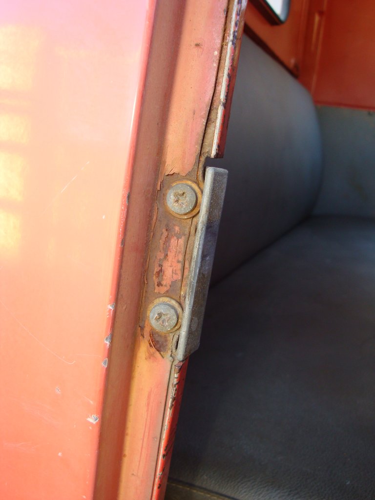

Nice looking truck, glad you got it back safely.
http://www.thesamba.com/vw/forum/album_page.php?pic_id=518980
http://www.thesamba.com/vw/forum/album_page.php?pic_id=518981
I don't have a pic of it removed but I can do that if necessary.
You can find the part # in the online parts list at:
http://oacdp.com/5867part.html
#3 here
Part # 265 841 771

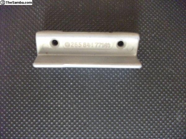

PostPosted: Wed Dec 31, 2014 10:09 am    Post subject: 265841771 Reply with quote
If this is the part... maybe will help someone find one someday.
265841771
I think the text translates to door closing wedge. (Part # page is missing from oacdp.org)

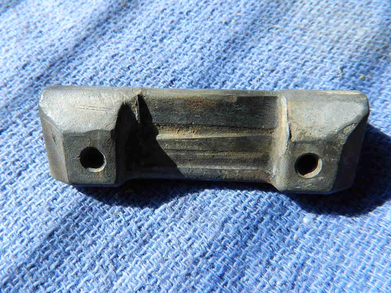

PostPosted: Wed Dec 31, 2014 10:30 am    Post subject: Reply with quote
Here is one I found in an old classified ad and added to the gallery. I purchased one from campingbox awhile back that has a different part number, but otherwise is identical. I'll post a pic when I get home from work.

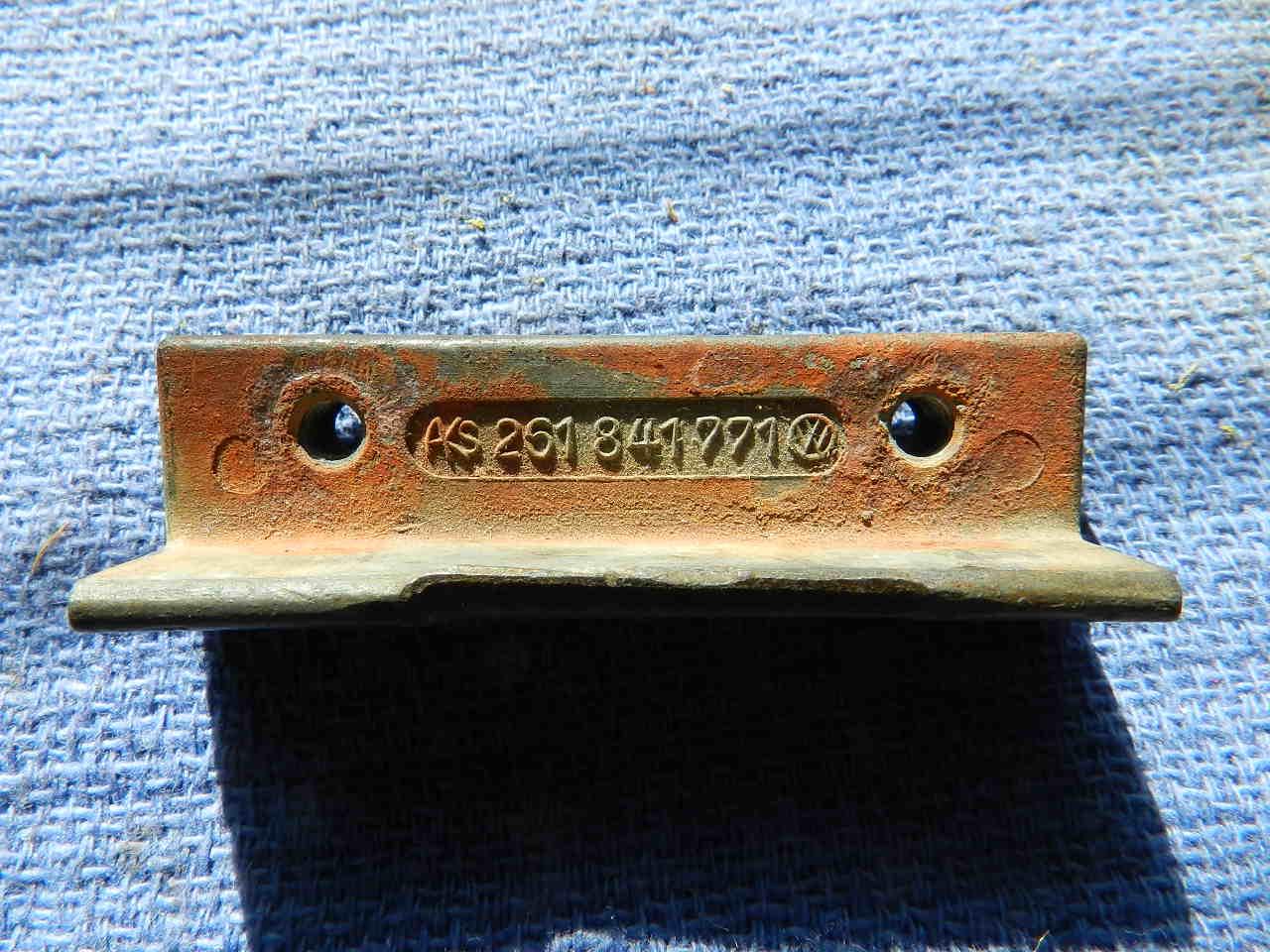

PostPosted: Thu Jan 01, 2015 6:08 pm    Post subject: Reply with quote
Here is a DC rear door striker with an oddball part number...other than 261 (Single Cab) prefix it is identical to a 265 841 771 striker. Any clue as to where this part number originated?
