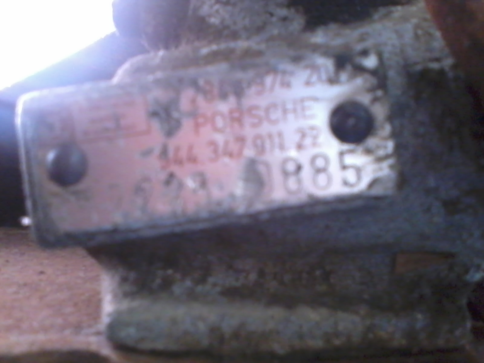

PostPosted: Sat Feb 18, 2012 2:31 pm    Post subject: Porsche steering box in a Thing Reply with quote
I have gone through three steering boxes in the Thingster. Maybe it is the 235x75 15 tyres on the front combined with off-roading, but I had a chat with Ronnie of OldVolks in Lake Havasu City, AZ. He showed me a Porsche 356 steering box, that is meant to be much stronger and fit with no mods., I have not heard of this before, anyone out there got a Porsche steering box in their Thing? I am told they are $400 used but that is cheap if it lasts!

Another option is the early (mid 50s) type 1 steering box, it has a larger main shaft and is all around stronger. The trouble is finding one in good shape.

i have a porshe 356 steariing box in my thing!! Very Happy Very Happy Very Happy Very Happy

PostPosted: Sat Feb 25, 2012 5:49 am    Post subject: Reply with quote
[/img]
