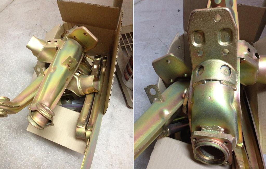

as well as suspension parts:
We even had the suspension parts plated with Zinc Chromate, and they look awesome:

My new plan, starting with the beautiful doors from the 1973 parts car is to use very minimal bead blasting only at the tiny rusty spot in the weatherstrip track at the bottom of the door. The the rest of the paint prep will be done using sanding or scuffing. Lesson learned.
I will need to deal with the miscellaneous suspension parts that are already zinc chromate plated. As skills points out, there may be some challenges getting paint to adhere to them. These threads back him up:
http://www.finishing.com/2400-2599/2444.shtml
http://www.finishing.com/150/46.shtml
On the other hand, these pages indicates that yellow zinc chromate is a good base for paint:
http://www.infinitechfinishing.com/Articles/Article7.htm
http://www.allegiscorp.com/docs/materialFinishGuide.pdf
I guess you can find backup for any argument on the intarwebs.
My plan was to paint the zinc chromate plated pieces with the KBS RustSeal system (de-greaser, etcher, then paint). I guess I will use that approach on a disposable part then destructively test the finish adhesion.
I know that a lot of replacement automotive parts are shipped in yellow-zinc chromate, if you needed to paint one of those, how would you approach it?

Damn. I thought they tasted funky! Smile I realize you do not have malice, and hope to learn from your experience. Thanks for your continued input.
skills@eurocarsplus wrote:
. . . i did an experiment with . . .
I have been working up an experiment of my own. Since I planned to use KBS RustSeal over the zinc plating on the suspension parts, and I already have material on hand, I will set up the following samples:
    1) Bare metal (no plating) paint removed by wire brush (KBS acid wash "Rust Blast" used)
    2) Bare metal (no plating) paint removed by bead blasting (KBS acid wash "Rust Blast" used)
    3) Zinc Chromate as received from the plating shop (NO special wash)
    4) Zinc Chromate cleaned (KBS acid wash "Rust Blast" used)
My thinking is to use the paint to lay some strip of nylon cloth tape to the metal, then use a spring scale to see how hard the tape is to remove, pulling normal to the surface.
. . . the minute that pan was done, it should have been epoxied . . .
I realize I have the cart before the horse here. I have just have resigned myself to going over the pan one more time with fine glass beads. It will not take too long. Then it will be right to the paint shop for 2K.
. . . shame on the plating company . . .
I went in with eyes open. I am treating this whole mess as an experiment. If I learn something it will all be worth it. Somehow I had it in my head that Zinc Chromate would not give a paint adhesion problem, and I loved the idea of laying a real coat of metallic zinc on the part. As far as cost, they charge $60 per batch, and all those parts fit handily in two batches, so the expense is not so great.
My plan now it to experiment with finding a paint that will adhere to the Zinc Chromate. If I can find something I am home free. If not, I can re-blast the zinc chromate parts back to bare steel and use 2K.

PostPosted: Fri Dec 28, 2012 9:42 pm    Post subject: Reply with quote
you might try sanding the ZC and then hitting it with a product called Bulldog Adhesion Promoter. it sticks to chrome, and other plating. it smells worse that a dogfart, but seems to work. you can buy a rattle can to test, if it works, buy a quart and spray i on
View user's profile Send private message Send e-mail Visit poster's website Facebook Instagram Classifieds Feedback

The folks over at KBS think that their RustSeal (POR-15 similar) will stick fine to Zinc Chromate:
http://techsupport.kbs-coatings.com/threads/using-...#post-1231
You can do the KBS 3 Step System on a Zinc Chromate Finish and get excellent adhesion. That is the best way to coat a zinc chromate finish and it is fairly common application.
I still think a test would be in order.

Mike Fisher wrote:
Master Series silver and/or black over the ZC would be fine for the suspension parts.
Thanks for the suggestion.
I just took a look at the Master Series site. It appears to be in the same class of moisture-cure urethane rust products that also includes POR-15 and KBS RustSeal.
I'm sure each brand has its good points and failings.
Since I have the KBS system already, I'll give that a try first.
