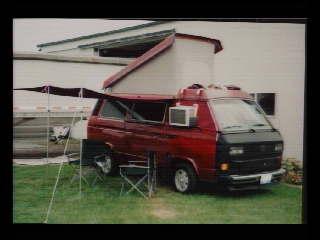

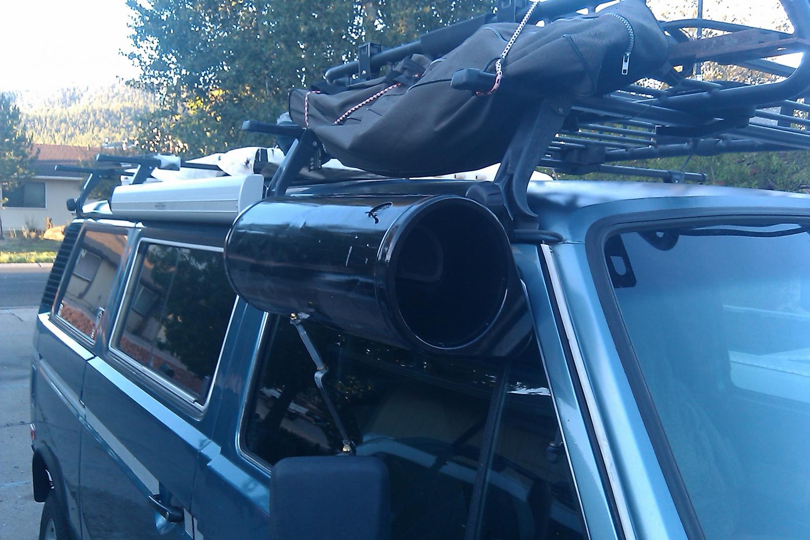

For use with shore power, quite a few vanagonners use a small window unit hung from the luggage rack:
All this fits in a single tub - easy to grab & go or leave outside the van if not needed:
Some have intalled it into the driver's side slider window, also.

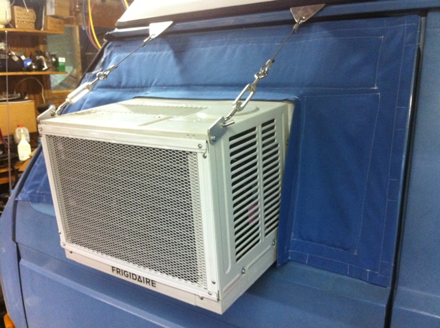

Here's the set up I manufactured first for myself & now for other Vanagon folks.
Problem is with the Eurovan--it has no drip moldings to hang the unit from, or not much of a luggage rack to bracket the AC unit down to the door window.

Might.
Problem is I don't have, or know of anyone around here that has a EuroVan Westfalia to use as a template for the luggage rack brackets to get it to hang in the window square.
It sure doesn't have any drip moundings to use to hang it from, so the luggage rack would be the way to make it fit out of the window.
