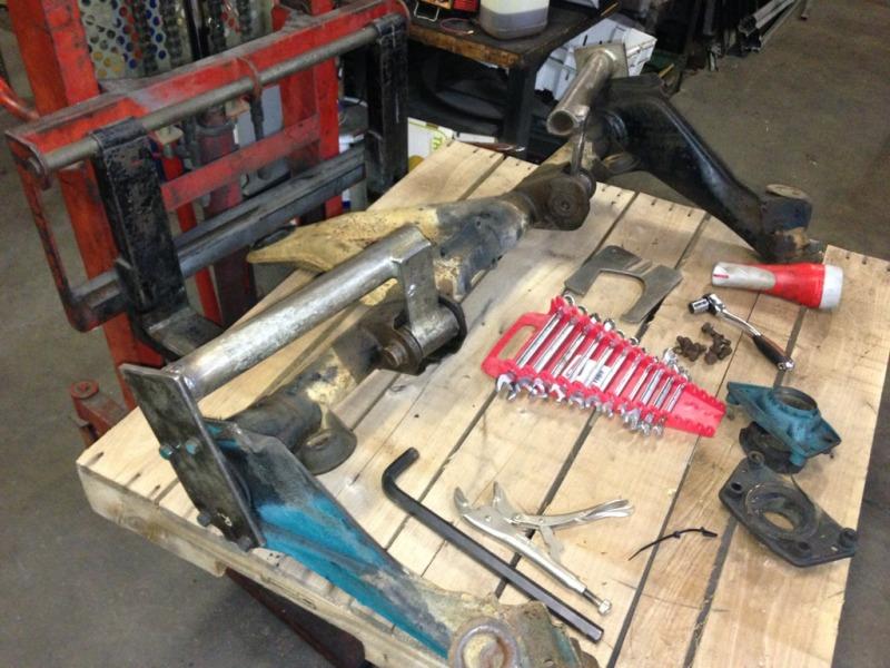

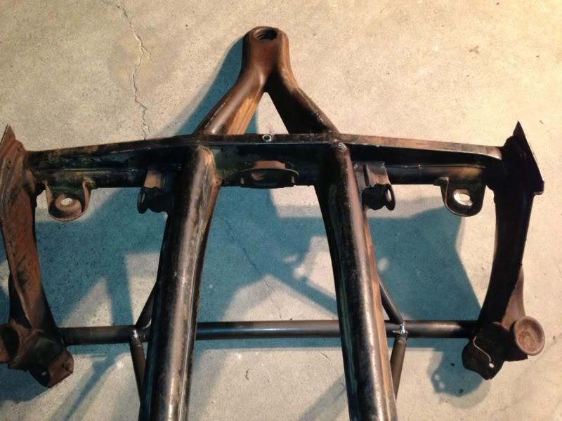

So I started with the Swing axle, (see chassis below, a lot has changed since this pic though). Got lucky and found a spare rear sub-frame from a Squareback very cheap. So I'm doing the work to that then swapping out my original one later. Keeping the original in the back shed for historic preservation. I believe the one I’m working on was from a wrecked squareback because it has some reinforcing underneath the torsion housing tube done from factory and the torsion bars are slightly thicker in diameter. (bonus). You will see it further down in the work thread.
Next, I bought a donor IRS rear end from a later model wreck. This will give me all the necessary hardware. I also bought some aftermarket pivot boxes but decided I would cut the originals off the donor susp' because I preferred the angle they met the torsion housing tube at. It meant that less metal would be cut off the frame horn using original pivot boxes and so I felt more comfortable because it looks more like a VW original design like you would find on an IRS Beetle. I will warn you though, cutting the pivot boxes and grinding them is no fun. I could not work out an easy way to do it. It's just hours of work with a grinder.
See here: Cut out the boxes with excess metal.
Now somehow hold the pivot box and grind off the excess tube section from BEHIND the tube section being sure to only grind the tube off and leave all the original pivot box metal intact so that it will fit snugly against the new torsion bar housing with no-gap to fill with weld. (I held the pivot boxes on a bench vice using the IRS jig)
Grind, grind, grind, repeat for hours ….. (Note: I did not use the die grinder in the background for the bulk grinding. I used an angle grinder. The die grinder was merely used to chamfer the edges in tight areas to accept the weld better.

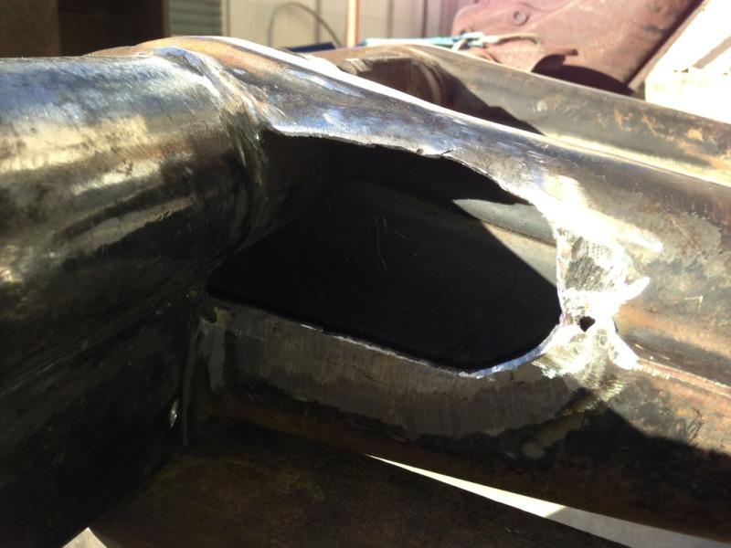

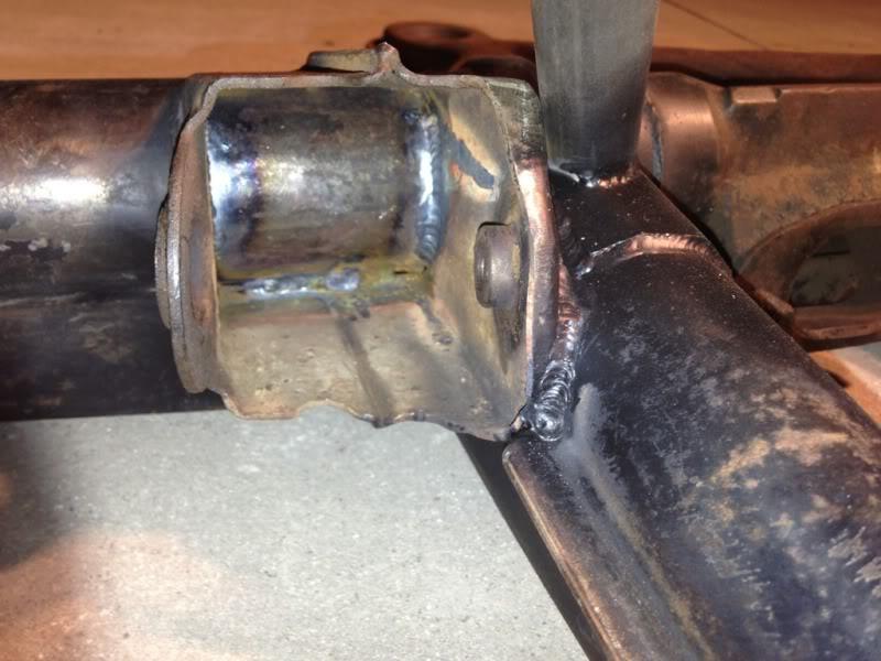

Now for some notching.
THIS PART IS IN CAPS (NOT BECAUSE I AM SHOUTING BUT) BECAUSE IT IS IMPORTANT. GET EVERYTHING UP OFF THE GROUND BEFORE YOU START CUTTING. YOU NEED TO BE WORKING AT A COMFORTABLE HEIGHT SO THAT YOU CAN GET A LOOK FROM ALL ANGLES when the pivot box is touching the frame horn.

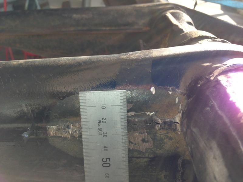

Measure about 100mm, (verify all my measurements yourself please.) cut the inner join off back to the torsion tube up to the front of where the pivot box.
Check the pics. The notched-out hole in the side of the frame horn for original pivot boxes will be a lot smaller than if you were installing aftermarket pivot boxes. You need to cut a bit then test fit the jig with the pivot box bolted in. Leave the pivot bolt just a bit loose so the pivot box can rotate into the natural position when it hits the tube.
Important: USE A RECIPROCATING AIR SAW OR SIMILAR TO DO THE DETAILED CUT. NOTHING ELSE WORKED FOR ME.
Estimate where you need to cut then make a smaller hole than that estimation. The closer you get to a perfect fit the smaller your cuts need to be. When you get real close use a sanding disk on a grinder to give you the ability to trim a very small amount at a time. Remember, welding big gaps is not ideal. 1-2mm gaps are ok for tig welding but more than that is not ideal because bigger welds require more heat and that can lead to cracking at a later time.
TIP: Put a few washers on the outside bolts where you will attach the jigs to the torsion housing. You will be inserting these bolts and removing them a lot over the course of this exercise so lube them up and make life easier.
Once the first side is perfect, (expect anywhere from 1 to three hours work) ensure that it fits neatly without any forcing any of the bolts holding the jig in position. You can opt to tap the metal surrounding the hole in the framehorn with a hammer to push it inward if you are close and could not be bothered cutting it to perfection but I opted to sand the metal down till it was near perfect.
Note: The area on the top frame horn metal near the pivot bolt exposes the pivot bolt a little and needs to be raised so that you don't inadvertently weld the pivot bolt in the process. A little massage with some pliers and a hammer. Note: The top of the frame horn is thinner metal to the bottom half of the frame horn. I'm guessing that's because the top is in tension with the weight of the motor so it doesn't need to be as heavy gauge.
To do the second side we take a template from the first side and spray the outline with any old paint to get the shape. Don’t assume the hole is going to be exactly the same size. Cut it a tad smaller then do same as the other side. Cut and test fit till you get it perfect.
Here’s some pics. Metric rule used but only as a rough guide. Confirm your own measurements please.
Final pic is where I bolted pivot boxes on and it’s ready for welding.

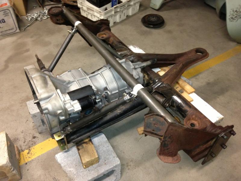

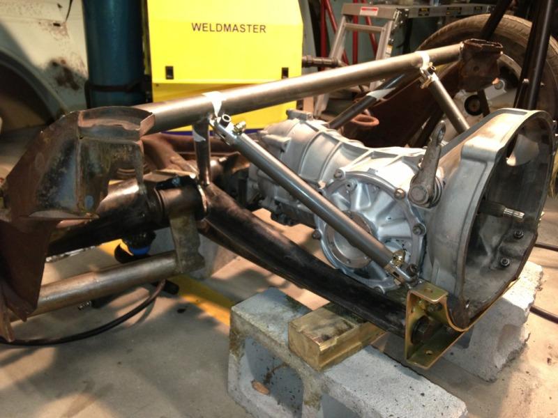

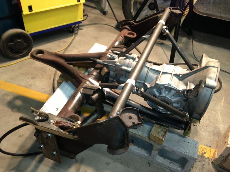

KAFER bar construction:
At this point I’m going to construct a Kafer bar support truss to stabilize the frame horn tips. I figure that since I’m going to get the pivot boxes professionally welded I might as well get the Kafer bar setup tack welded myself now with the MIG and then give it to the professional TIG welder as a complete job.
First I sourced 1.5” chromoly tubing for the cross bar and 1” Chromoly for the diagonals. Also 4 clevis joints for the 1 “ tube. The rear diagonals will be removable. The rest will be welded.
Source a Heavy Duty rear trans mount to weld the tabs for the clevis joints. I chose an Empi one but will be welding it the entire way round
Bolt the engine up to the trans (My old engine finally comes in handy for something.) This will give you ability to see where the Heater boxes and the starter motor are positioned so you can miss them. This is also the reason why I opted to make my own. I want to retain heating and I was unsure if the ready-made kafer bar setups would work. It’s also a lot cheaper to make since I’m already paying a professional welder to do the work on the pivot boxes.
Weld in the cross bar. I chose to sit it on the shoulder of the shock tower. Much like the pivot boxes you need to be obsessive about maintaining little to no gap when cutting the Kafer bar tubes.
Final note. The front diagonals are not tacked in position yet. Deliberately left them loose for the welder to weld the pivot boxes first. Since the welder is a custom racecar frame builder he also recommended that we weld a plate next to the pivot box where the diagonal connects to the top of the frame horn. I beleive they call this a 'foot' for the tube. The metal on the top of the frame horn is relatively thin so it will spread the loadand tension of the Kafer bar diagonal brace.
The Subframe is currently at the welder. I will edit with finished pics very soon. (just got the call that it's ready so should have a few pics up tomorrow.)

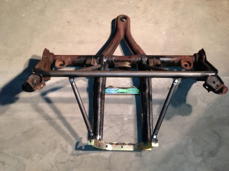

Update.
Picked up the rear sub-frame from the welder. See pics below.
5.5 hrs worth of welding and fabrication in addition to all the prep work I did. It's really a far better welding job than I could have done.
I am very pleased with the results. The reinforcing plates next to the pivot boxes where the diagonal meets the frame horn were an addition.
So was the additional welding of the Empi HD rear trans mount. Although it's heavier guage steel it was a little light on welds we thought.
Here's the pics. The Mohr mid mount is just placed under the frame in pics below. They don't require any welding. Was going to use a Berg mid mount but to be honest I like the simplicity of the Mohr style one.

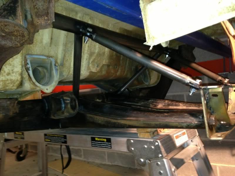

Update.
I panicked a little tonight second guessing my measurements so I had to test fit it under the car to ease my mind.
Notice in the last pic - the right side front diagonal bar touches the small cylindrical electrical component next to the right side hot air flange.
Can anyone tell me what that component does? I can't remember how that was wired and couldn't find a reference pic in the manual. Just looks like a junction to me but I don't know. Power to the starter motor perhaps? I'm just guessing. Whatever it is I can only make out the marking 6V and SS-610.
Looked like it was screwed in an arbitrary spot with sheet metal screws so should be no trouble relocating it. Anyhow removed it and everything fit like a glove.
My heart stopped for a few minutes there cause I couldn't work out why the subframe bolt holes weren't lining up properly with the body mounts.
It's all good now. Phew.

PostPosted: Sat May 11, 2013 6:02 am    Post subject: Reply with quote
thats a external solenoid for starter motors, since VW don't use this bin it.
problem solved. Wink
