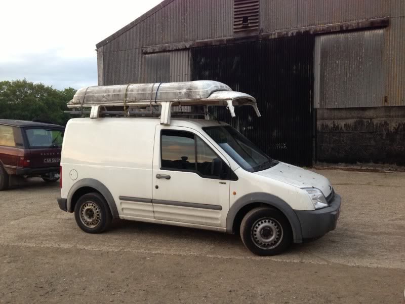

Picture of my van and the reason I need more room! lol

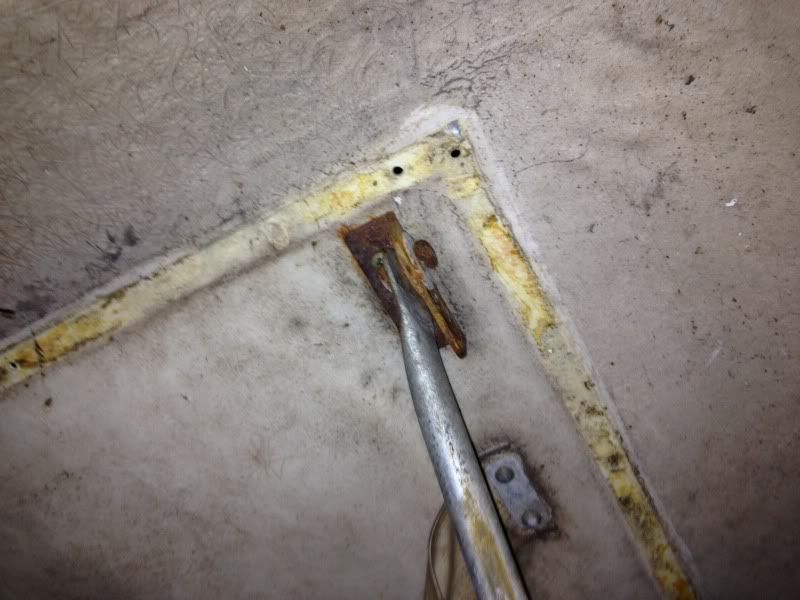

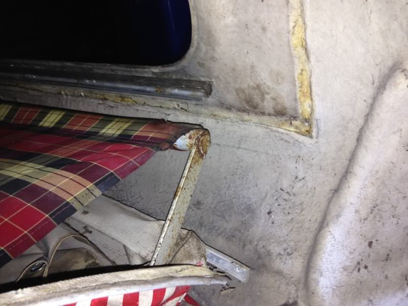

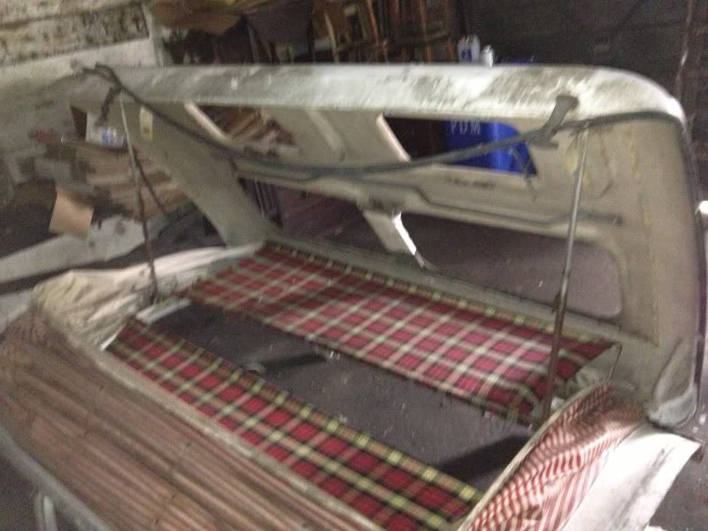

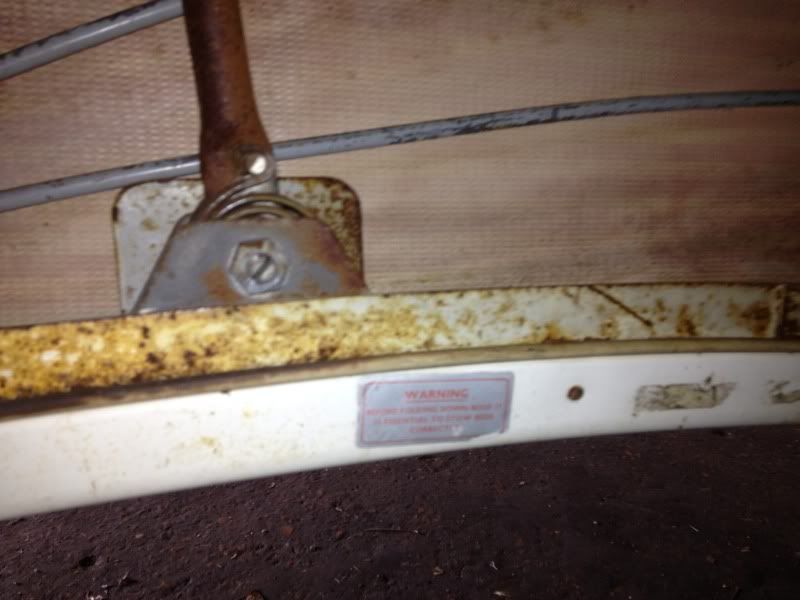

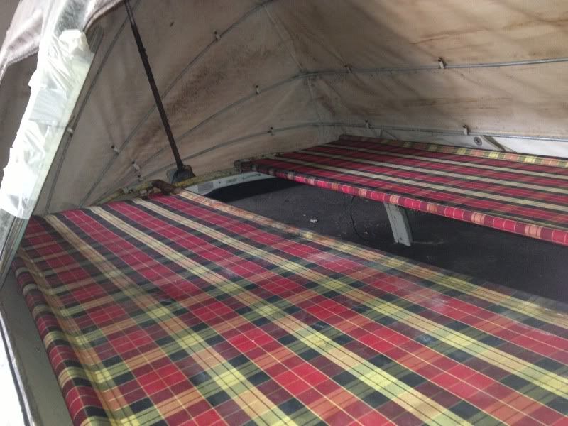

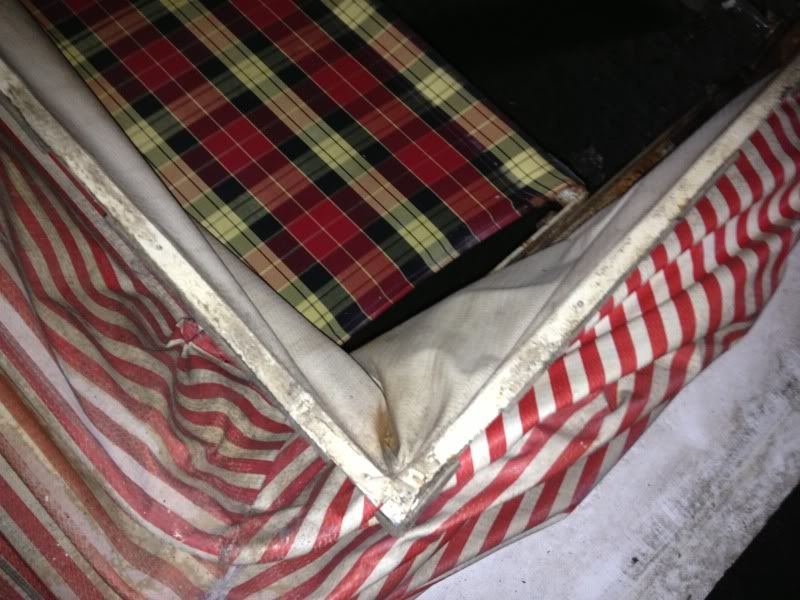

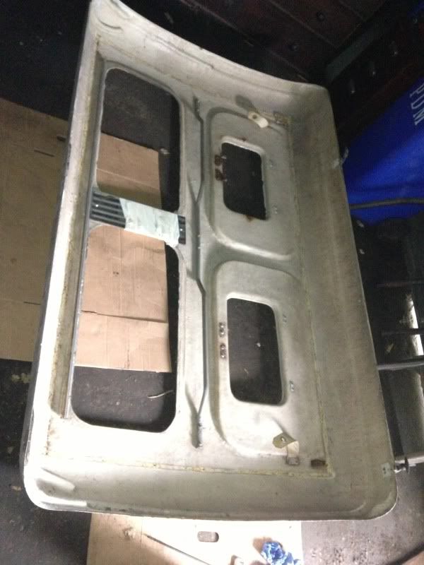

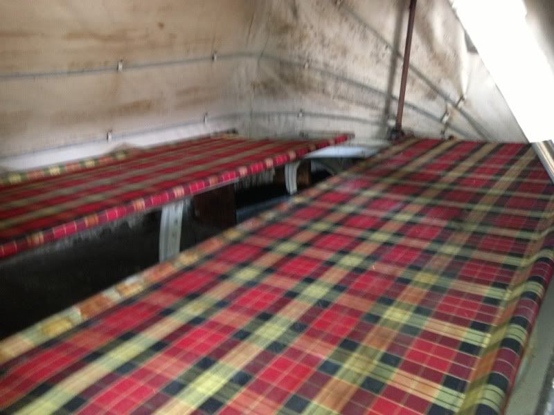

Found a few spare minutes to have a play with the new roof and inspect the damage
Roof cap need refinishing and the support where the tape is if broken so needs fibre glass repairing

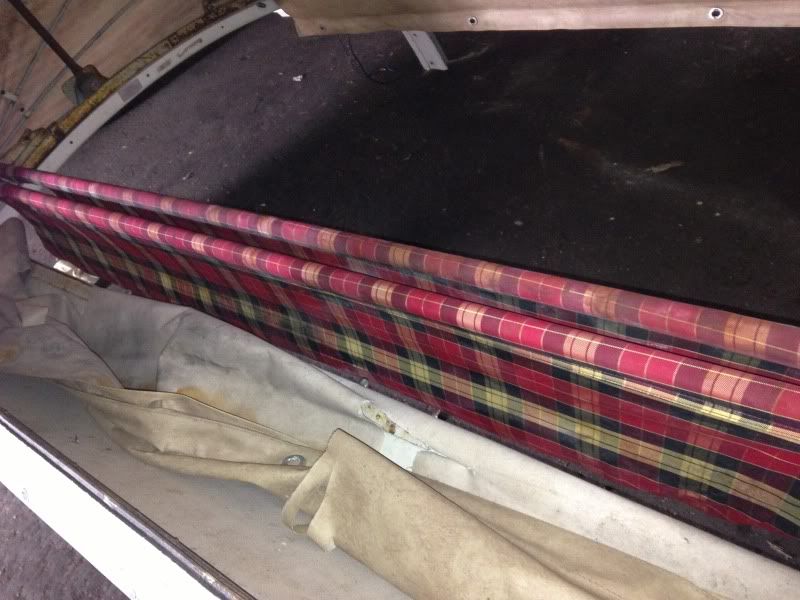

Canvas is actually ok but too ratty for me, Pretty sure I'm going to change it
Hoops look ok
Top curtain rail is missing
Put a small amount of lube on the bunks and they opened and closed fine both sides
Bunks where ok ish but too ratty again so I'll replace them too
I think one of the springs has snapped
Going to try and keep this original sticker
So next job with be dismantling the entire roof

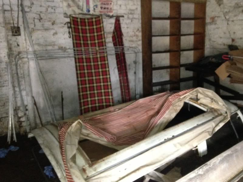

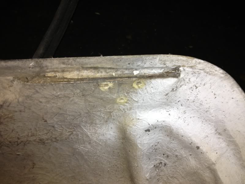

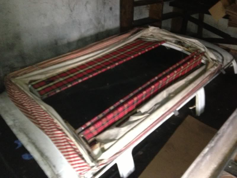

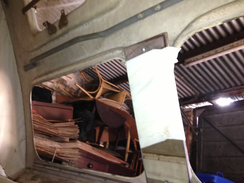

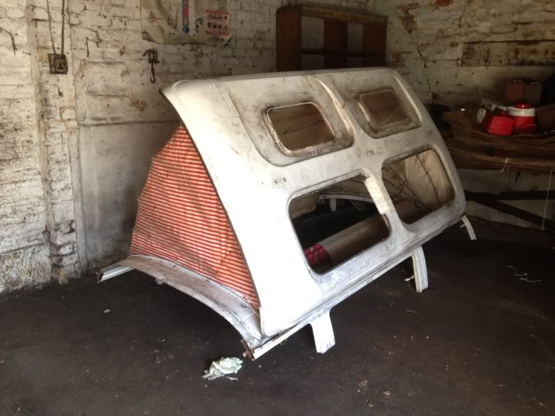

PostPosted: Sat Jun 29, 2013 9:43 am    Post subject: Reply with quote

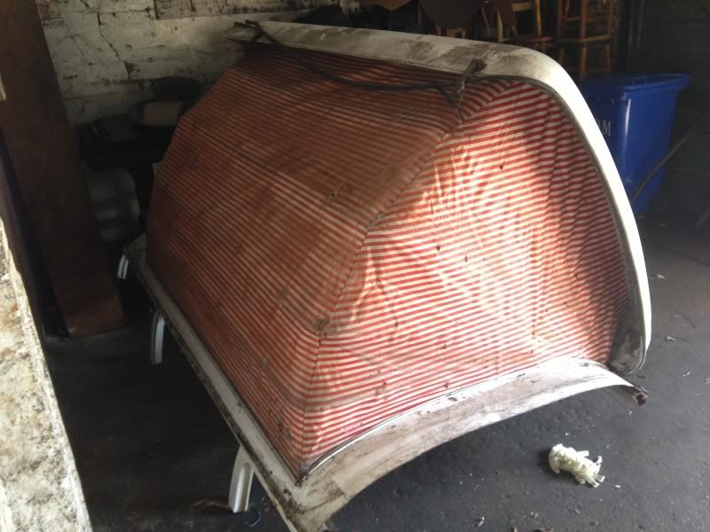

Made a bit more progress with the roof, some of the screws are rusted badly and where a bugger to undo.
Sorry for the bad quality pics they looked better on the phone at the time.. must have been the dust in my eyes Laughing

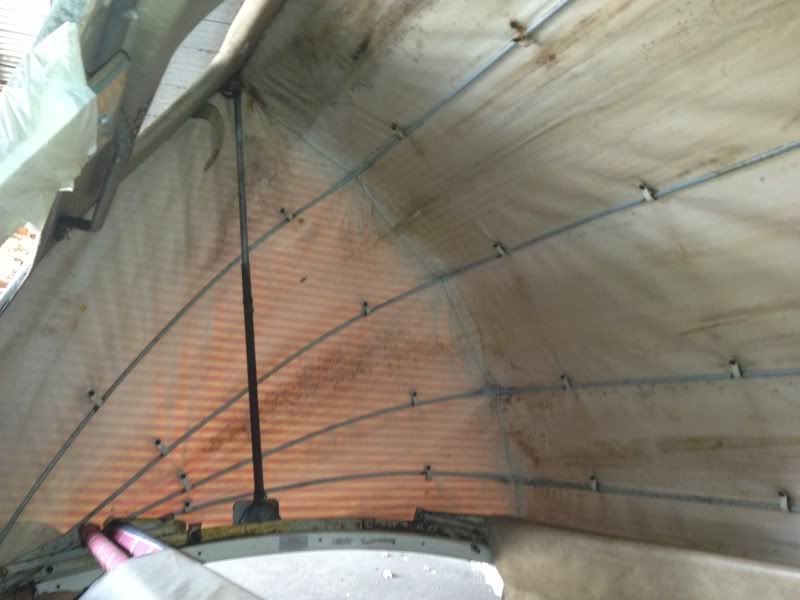

Removed the alloy frame holding the canvas on the roof cap
Roof cap off
Bunks and hoops removed

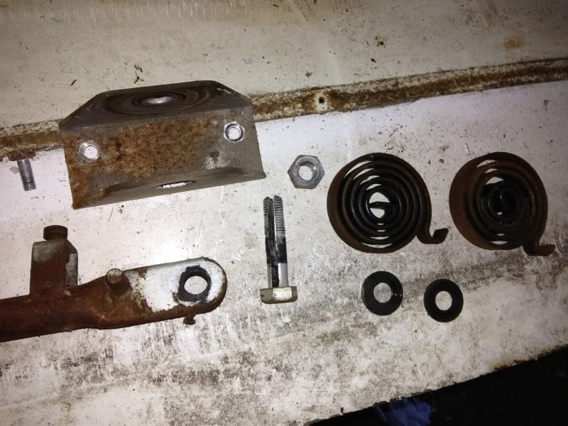

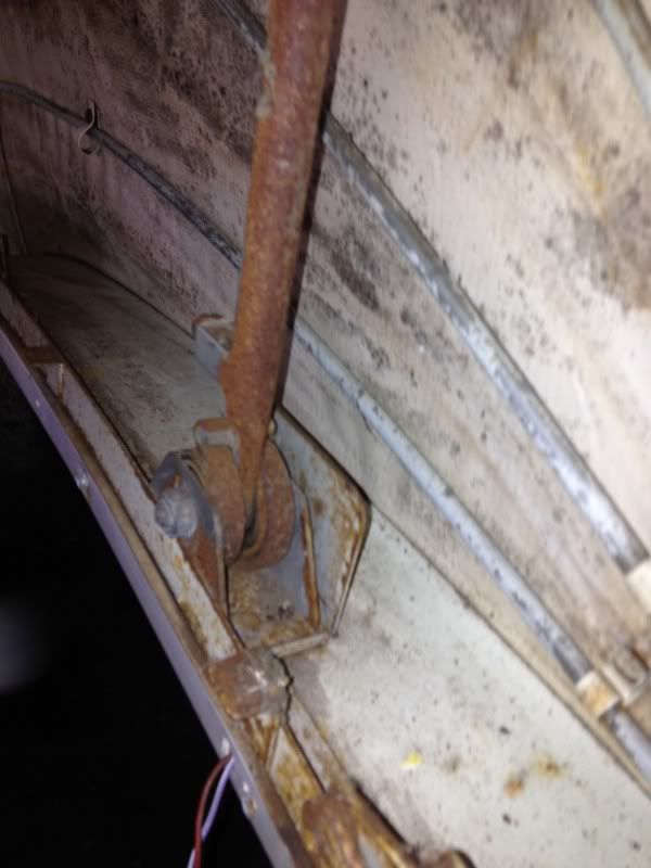

Roof cap lifting assembly, sadly one of the springs has snapped to will need replacing

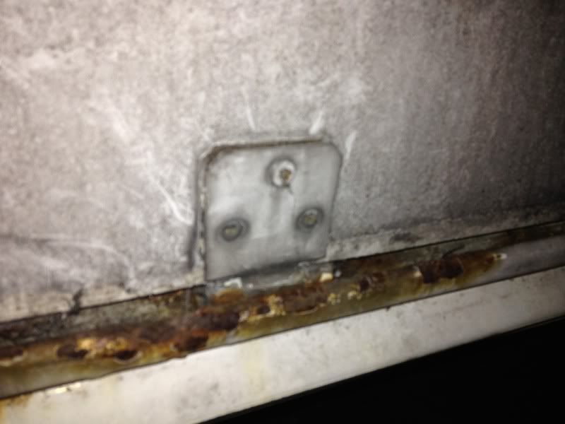

After some advise from those with Dorma roofs or that have restored one before.. do I cut the hinge mounting plates out of the roof incase they had gone rusty?
I think as I'm going for a fairly stock look I'm going to replace the canvas with 13mm Red and White Candy like what was on there

Just removed the roof on my 71 dormobile as the final stage on the refurb. One of the plates had completely rusted and the fibre glass cracked , so I took a chance and cut the fibre glass away from the other two and found they had both rusted into oblivion. I would recommend cutting the old ones out and replacing them.

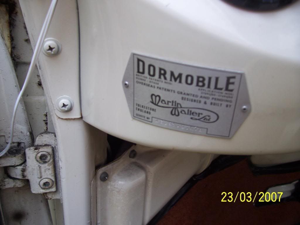

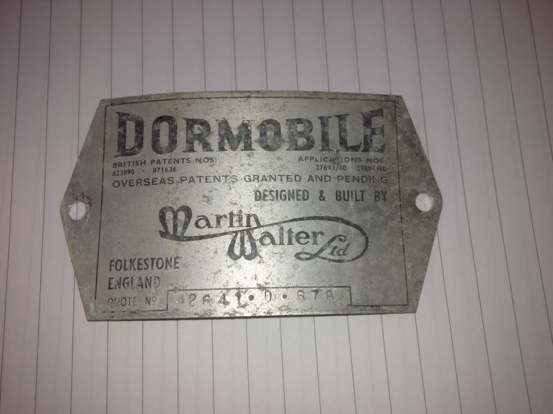

FAO of Westy/LHD Dormobile owners.. do you guys have the Dormobile Plaque like this:-
..and if so was it mounted to the right hand or left hand side of the dash board.
I have seen them on the left passenger side on the Right hand drive Dormobiles but I haven't manged to spot if and where Westy/left hand drive Dormobiles had them

I have never seen that plate before, are you sure that they were installed on Westies?

PostPosted: Sat Aug 31, 2013 1:47 am    Post subject: Reply with quote
That's what I was trying find out as I haven't seen a picture of a Westy Dorma dash to see if it has the plate.

PostPosted: Sat Aug 31, 2013 1:59 am    Post subject: Reply with quote
It seems unlikely that Westfalia would put a nameplate from a competing company anywhere on the bus.
Of course stranger things have happened.
Here in the states we have very little experience with the Dormobile, as only the top was available from Westfalia, probably as a premium priced option.
