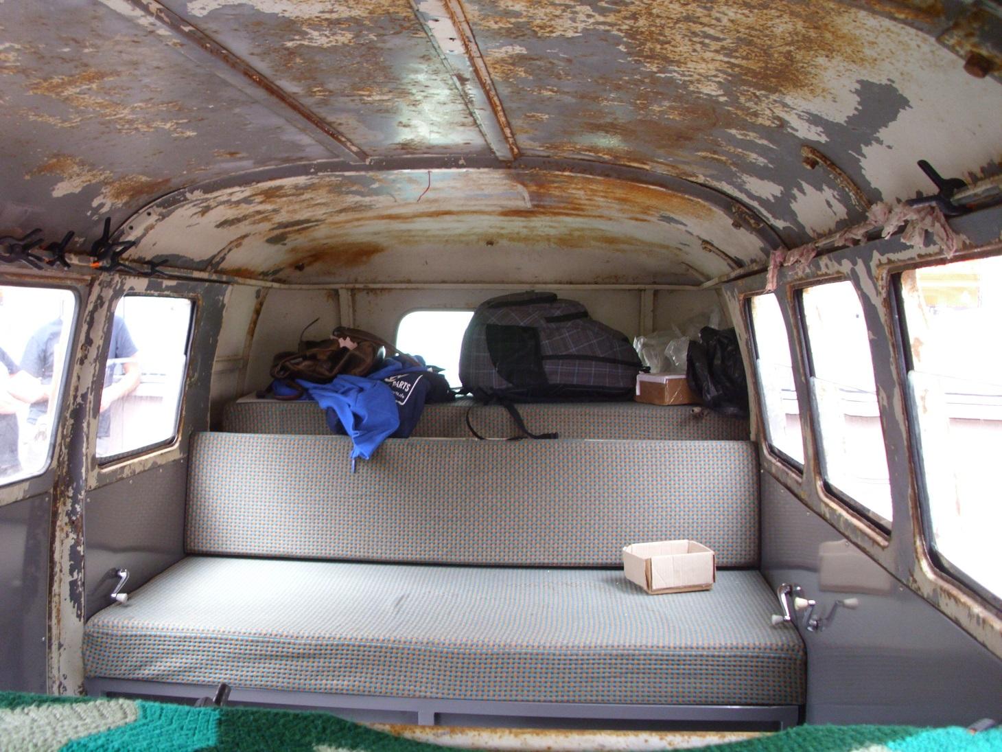

PostPosted: Wed Jul 10, 2013 2:58 am    Post subject: Reply with quote

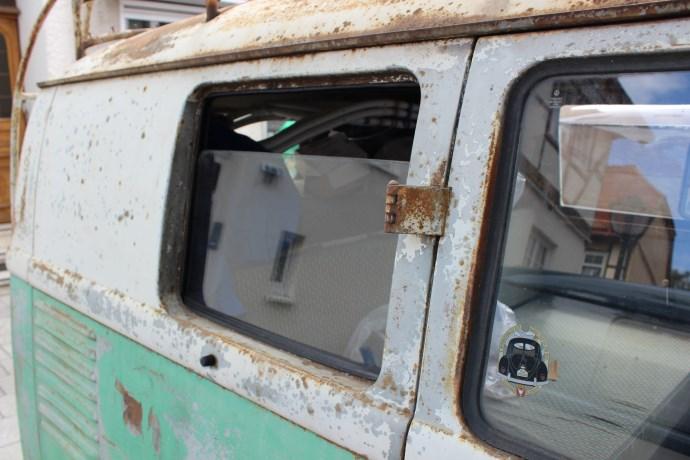

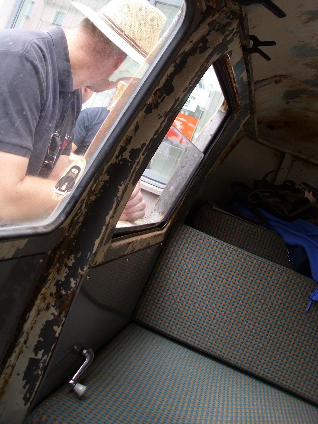

All cargo area windows wind, apart from those in the cargo doors. Pretty cool, and beats popouts!
The think the mechanisms are housed in additional boxed areas attached to the inner skin area.
I think the glass sits further back than with fixed glass - sitting behind the original aperture.
Such a neat job that it looks like it could be Wolfsburg led? Same paint pattern too.
Check out the rack fixings to the inner roof area.
Matt, got any pictures of the naked mechanisms?

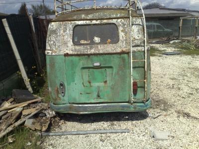

PostPosted: Wed Jul 10, 2013 3:08 am    Post subject: Reply with quote
As found?
Little more info here
http://www.ssvc.org.uk/phpbb/viewtopic.php?f=8&t=75622

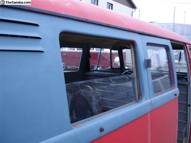

This one at Lavenham last year had 'em, at least the rear side windows were windup...

PostPosted: Thu Jul 11, 2013 12:08 am    Post subject: Reply with quote

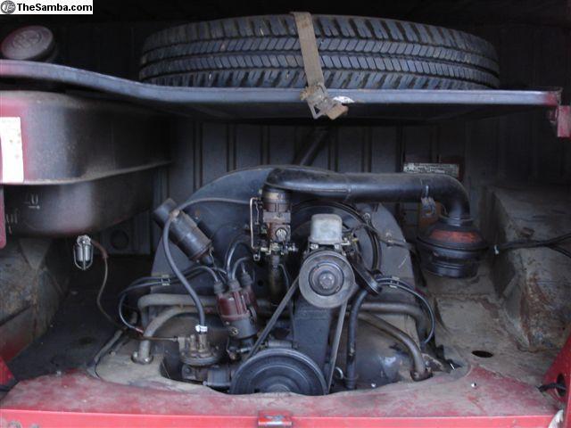

Wow !!! Shocked Shocked another Austrian-British bus !
very interesting van. obviously this was a company's firetruck in upper Austria at some point and the new owner took the paint back to doveblue in places. if that is the OG paint , this would mean the roll up modification was done without cutting or welding the outer window frame ?
Man, if this bus has OG paint and the original layer of fire red on over it, it must be SUPER solid !!! no welding/filler visible at all except for a repainted rocker panel. Funny you can see the spotwelds in the side panels exactly where the roll down window is. So either they removed the inner bracing structure or the water running down the window channel caused some rusting between the panel and the bracing, moving the parts and causing the typical 'pop in' spot welds . An inside view of the rollup mechanism and bracing would be most interesting. Whose van is this ? clean mean machine !

You can just make out the winding handle for the far rear window. Looks very similar to Matt's but is higher up.
I had a very good nosey around Matts bus when he first brought it down to Cornwall. Is supper cool in the flesh and the windup looks very factory or day one coachbuild. I'm not surprised there is another.
My question is why did they have windups?
They would be cool in a camper but the handles very much hinder the fitting of a camping interior. Confused

these windows seem to not be quite as tall as stock windows? and smaller than the other roll-up window bus.
regards
Uli
djfordmanjack
Joined: June 15, 2009
Posts: 2376
djfordmanjack is offline
PostPosted: Fri Jul 12, 2013 12:23 am    Post subject: Reply with quote
you're right !!!
also the fixed glass looks more recessed than on an original kombi, probably coachbuildt from a panel !

Just the two rear side windows wind on the converted Panel

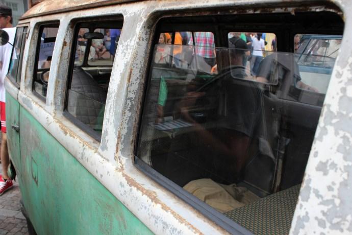

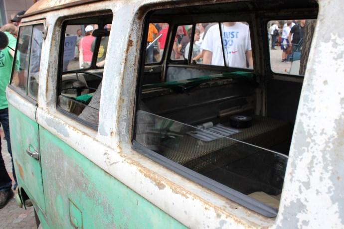

PostPosted: Sat Jul 20, 2013 3:59 am    Post subject: Reply with quote

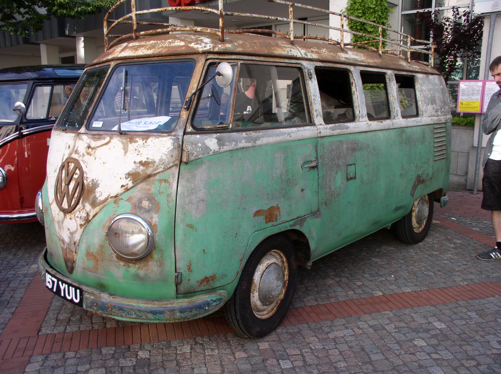

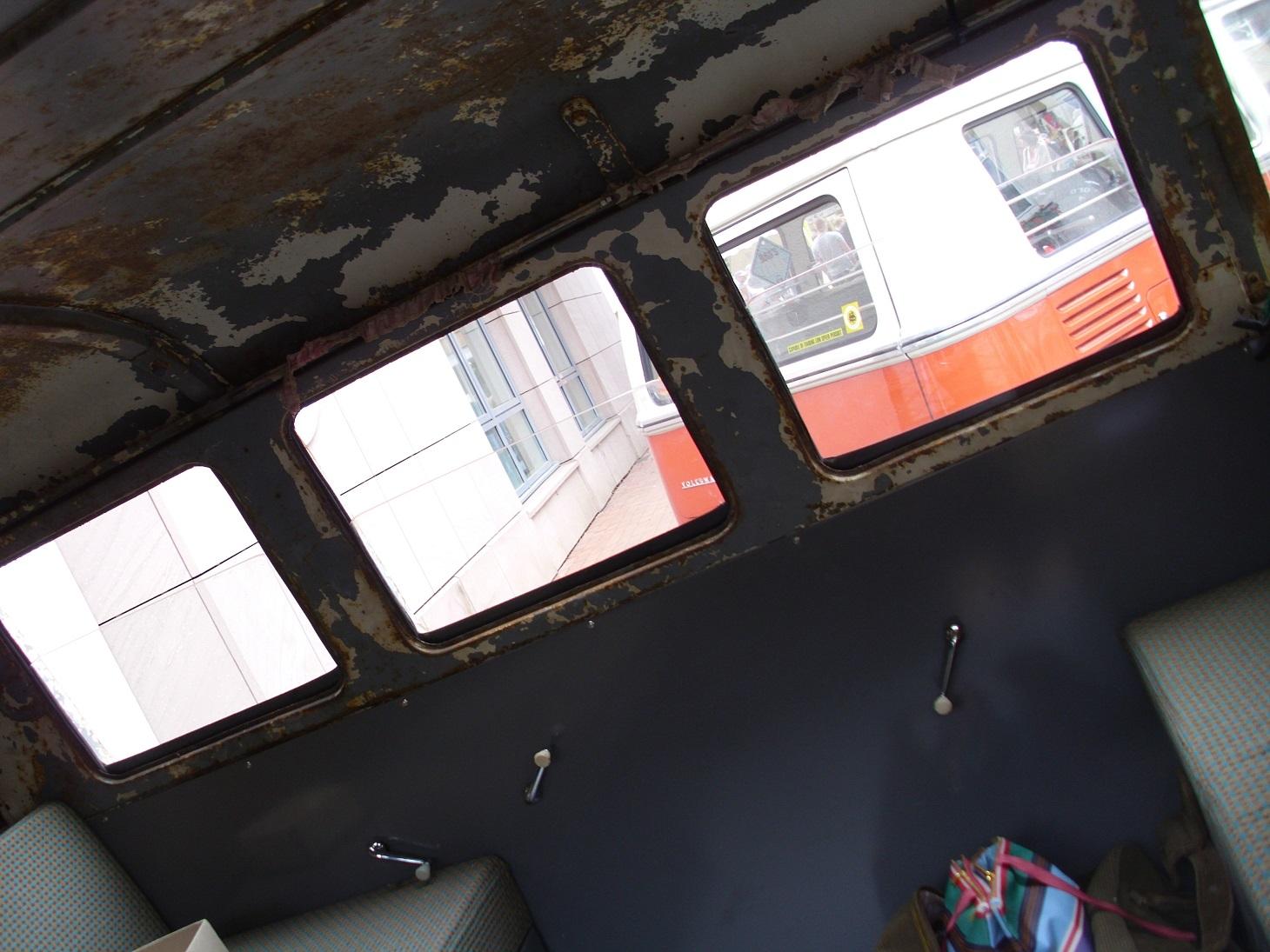

Some pictures that I took of it at HO.

PostPosted: Sat Jul 20, 2013 11:31 am    Post subject: Reply with quote
i can't think of anything that is not cool about those wind-up windows, except maybe, why did they stop and and NOT make the front sliding windows wind-up too?
Now, that would have been cool!
that would be on my list of cool customizations for split bus.
