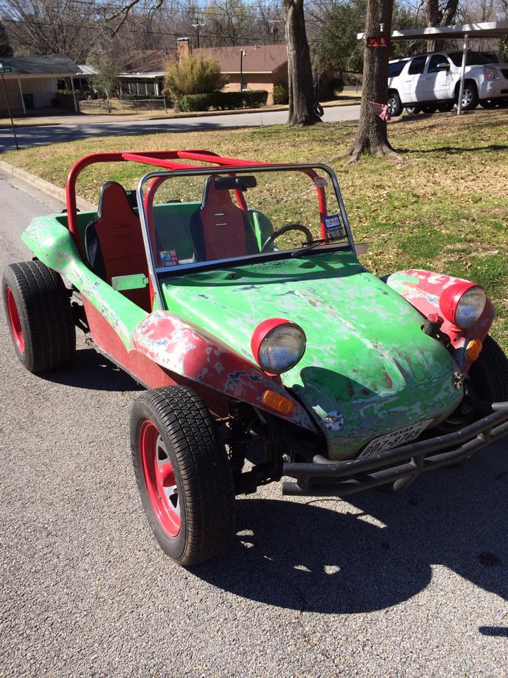

Hello all. Last night was the first time I took the new buggy on the road at night and it became immidiatly apparent the headlights were way too dim. Being entirely too lazy to check the voltage at the lights, I figured the quickest fix is to replace the lights. Which, of course, was not simple. (My buggy takes H6024 lights, fyi)
From the way I see it, there are three options:
Sealed Halogen - Direct replacement; Dims over time; ~$12 / ea
Un-Sealed Halogen - H6024 style reflector with a replaceable halogen element; More sustainable long term?; ~$18 / ea; $9 for bulbs thereafter
Non-Sealed Halogen with LEDs - These are probably more of an aesthetic choice. I like the IDEA of doing LED running lights, but I am not sure they're at home on a simple as dirt buggy. That said, they're not much more expensive than a standard non-sealed halogen...
What are you guys running? What do you think? Are sealed halogens a dying breed? Thank you!

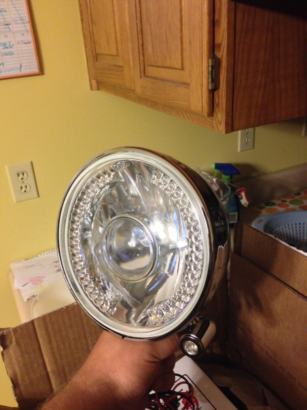

I ended up going with the LED ring option, with the understanding that I don't have to use the LEDs if I don't like them.
It looks like the wiring is 14AWG, which should be good to run 2x 100W, but not much more... I'll check the configuration, thanks for the heads up.
On the Hella H4 bulbs, I am seeing options for a 60/55 and a 100/80. My inclination is to go with the 60/55. Thoughts?
