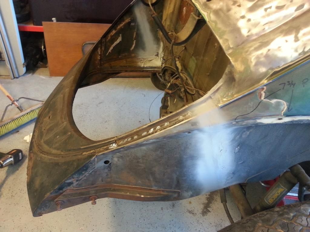

I got tired of working on that front right fender, I moved to the rears for now. Steel flared fenders, lots and lots of bondo I had to grind off, 1.5 lbs to be exact. I still need to weld up tail light holes and and put the 55 only lights in the right spot.

Back to the front... I tried fixing the Crack and kink without patching. It did not work out very well. Found that a 70s rear fender matches up pretty well. I used the driver fender to make a template of the curve.

Nice work on the fender . . . looks much better! I think you would have had problems if you had worked with that kinked-up mess instead of cutting it out.

Thanks blitz. It was far worse before I started working on it. The while section was bow'd out and stretched. Can't wait to finish this fender and be done with it. Then I can keep on going on the rears and start the driver front. Shave the bullet, and figure a way to remove the gnarly undercoating. Kinda lagging on that fender because I rather find an early semaphore fender and save a bullet.
I've tried heat and scraper on that under coating with no luck, unless I get it too hot where I'm afraid of messing with the metal. I may try mastic remover, heard that works.
