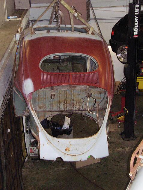

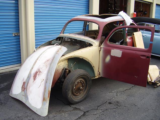

I've been meaning to do this for awhile, let's kick it off. Car is but a shell, but I have almost all the good parts, including W decklid, 4 tab hood, OG oval front fenders and bullet assemblies, original equipment Dehne fuel gauge, real nice bat wing steering wheel. It left the VW Wolfsburg factory on February 4, 1957 destined for a Seattle, WA USA delivery. Here is the Birth Certificate:
Day I bought it --
wrong aprons, but not for long!
Front and rear clips have been replaced, not sure what's up with that, prolly accidents. VERY LITTLE RUST ON THE CAR. Pinholes in both rear quarter panels, a bit in the bottom of the decklid and hood, but not much more than that. Will post more progress photos soon....ENJOY

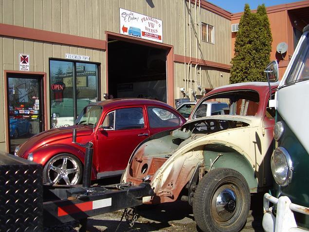

ok, here's some more -- old pans replaced by Franklin's VW Werks .... first time the body has ever been off the chasis. One pan-half was OK, but the pass side was toast under the battery.
Nice and solid WOW:

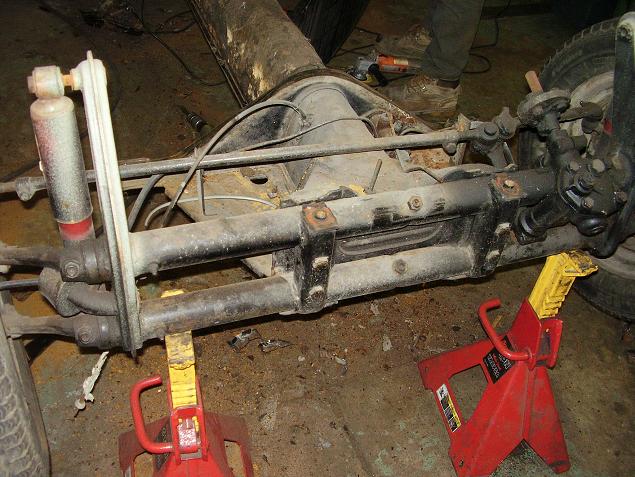

typical greasy mess after 50+ years of accumulation:
Nice Neopolitan hat. OG brakes, beam, smoothies:
More to come.....
Thanks Franklin:

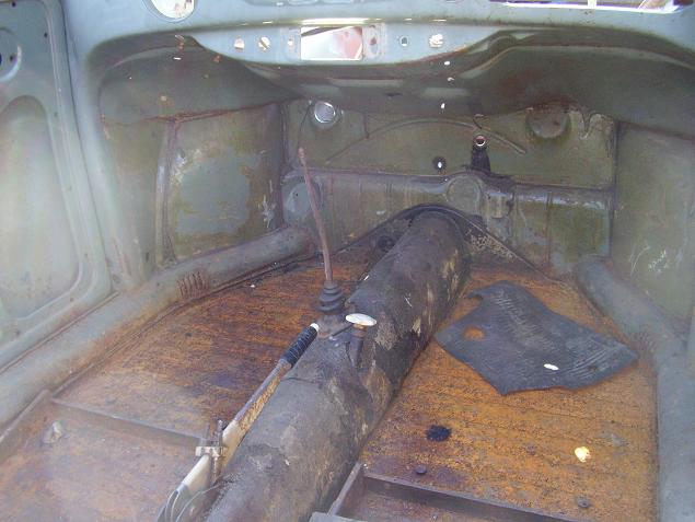

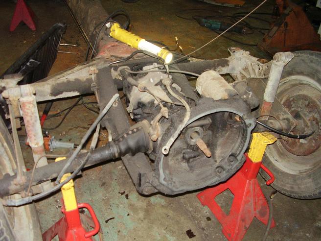

I had Franklin's replace my pans, which included drilling out several bolts that had ceased up. Here it is on their lift:
Here's the underside. Let me tell you, that undercoating saved this car's life. It's THICK under there. Was it applied at the factory do you think?
Underside of my incorrect rear apron....oily with only surface rust:
View from the top:

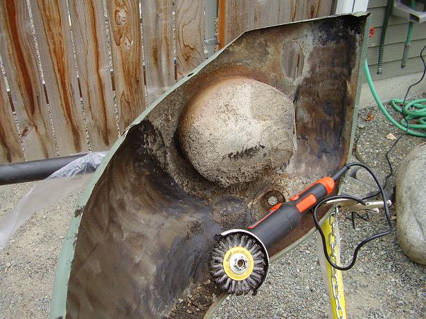

I actually removed most of the undercoating from the car, including all fenders, underside of the body and pan. Yeah, you ain't kidding, it was a biotch! I used a wire wheel for most of it. Hard work, I have gone thru one and a half DeWalt wheels with my angle grinder. Face Shield is key!

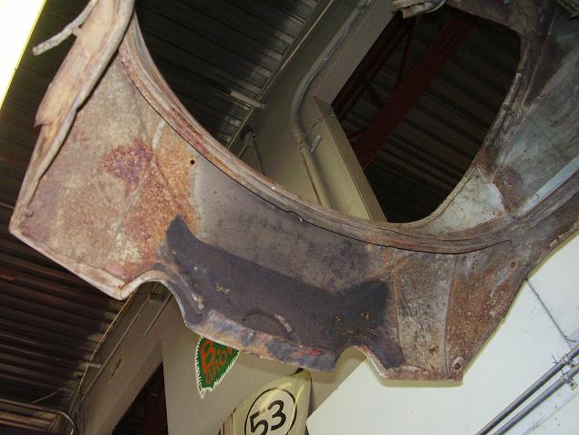

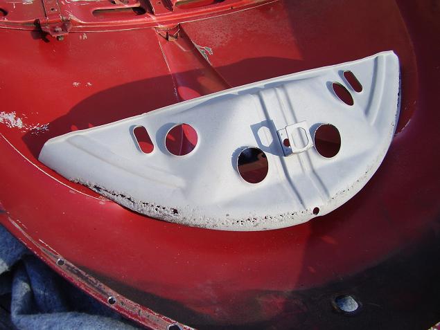

Had to do some work on the decklid. It was in very good shape considering it's age....just had a bit of rust at the very bottom edge. I drilled out the spot welds, removed the latch panel, cut out the rusty spots, replaced with fresh metal....VOILA. Ok, as many of you know, it was a bit more involved than a mere VOILA. It was very difficult and time consuming b/c I'm a newB body man and novice welder at best. Here are the early stages. The decklid was repainted red in color at some point. I have no idea if this particular decklid is original to the car, unfortunately. Crying or Very sad . Looks like under the red may have been VW coral red ? Anyway, here (like I said) I removed the inner latch panel by drilling out the spot welds. Then I sand blasted the panel. Here's an example of what it looked like after:
Here's what it looked like under there, dang that is some greasy nasty scheit. That is a couple-inch-long piece of new metal I welded in near the bottom....

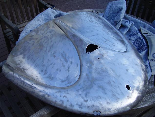

Then on the "bling" side I DA'd the paint off (used a dual action air sander). The black splotch at the bottom is a welded up pin hole:
This is just a start on the decklid. The latch panel was a bear...more pics to come....

Work continues on the decklid...had quite a bit of rust at the bottom. Looked like only pinholes, but once I removed that latch panel there was a bit of rust in there.
This is after sandblasting, check out all pinholes left over... I also primered it....
Cut out the rust, then cut a patch panel.
close up. Lots of work, mostly cuz I'm a beginner welder but slowly improving:

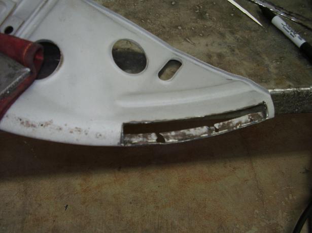

More on the decklid later, but here's some work I'm doing on a front bullet fender, grindin' off that nasty, thick ass undercoating.
Enjoy, LOTS and LOTS more to come....thanks for lookin'
