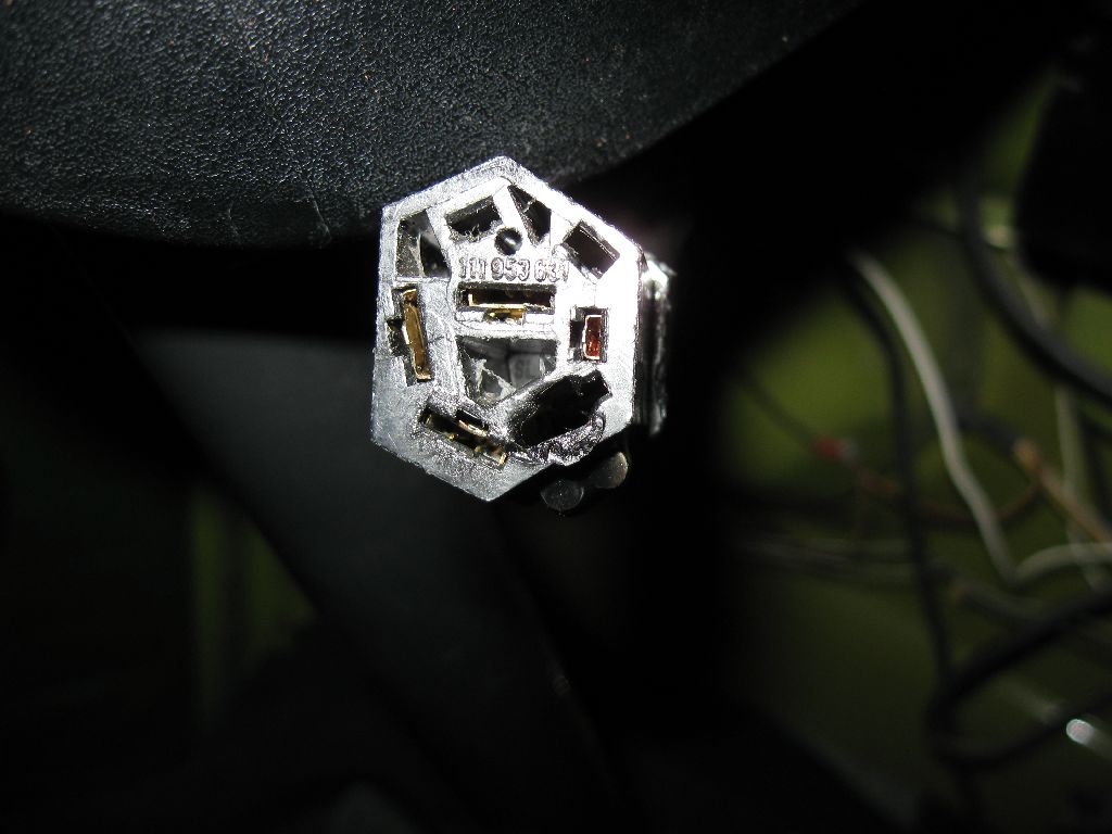

Sounds like you have an ignition switch problem. Perhaps the connection between the mechanical and electrical part. They are separate pieces.
There is an Hextagonish looking plug at the base of the steering column you can disconnect and it should kill the engine. This is what the plug looks like. This is from a bus, Thing plug looks similar.
In a Beetle, Thing similar
