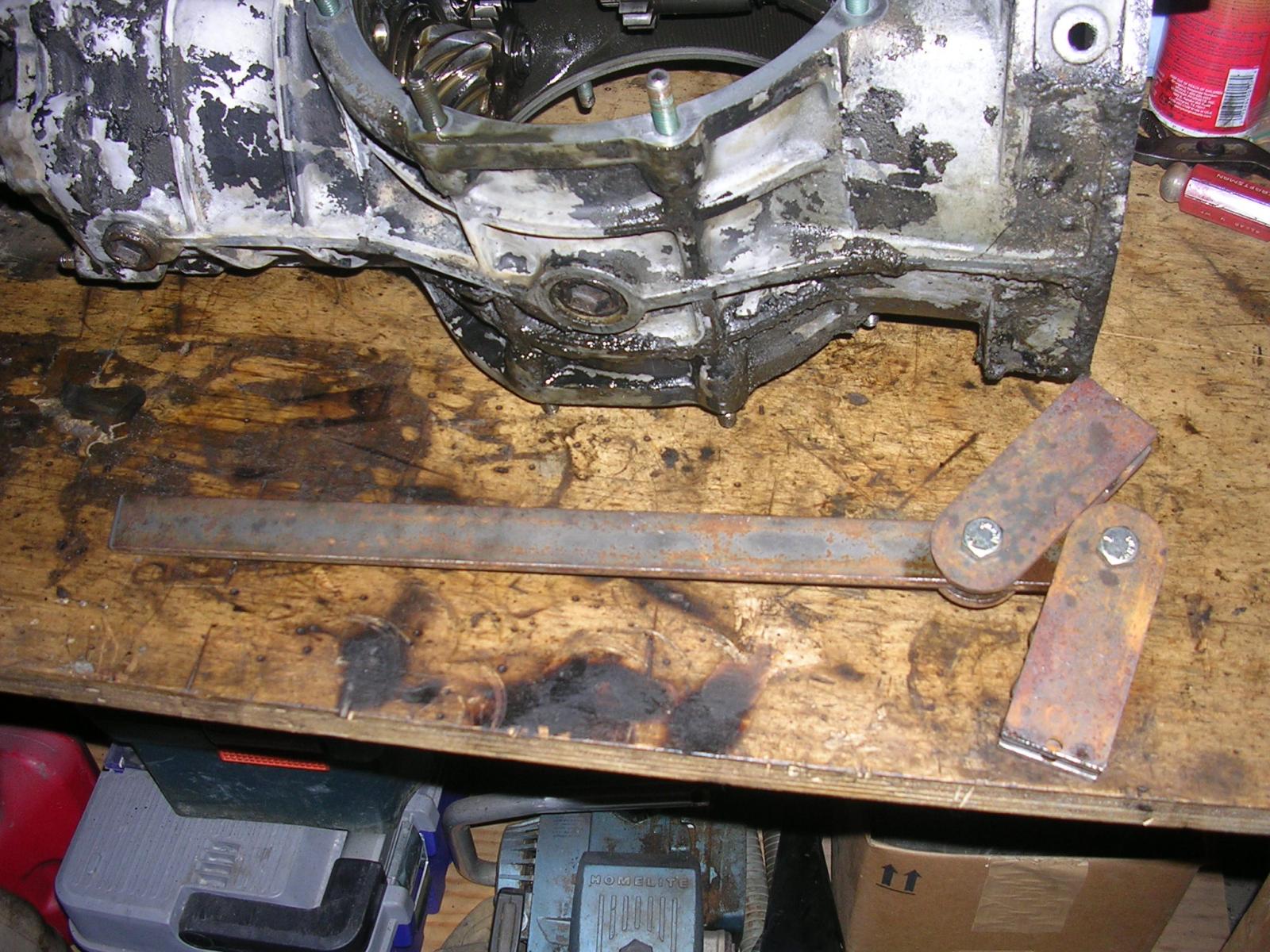

Back the the rebuild process.
After I got the engine out, I started looking at other things. The transmission was covered in thick black goo.
It looked like it had been leaking out of every seal for years. I wanted this car to be dependable, so I thought rebuilding the trans would be a good idea. I did a quick search here and somehow zeroed in on one guy (who what must have been suffering from dementia) telling everyone that these transmissions are "easy" to rebuild. Of course, I did no further research and began removing the transaxle.
Just to be clear, I didn't just fall off a turnip truck and decide that I could handle this job using a few old screwdrivers and a tack hammer from Mama's junk drawer. I've built a few transmissions, both auto and manual; engines, transfer cases and installed R&P sets. But those were mostly from older domestic cars and trucks. And actually, it is a fairly simple transmission. Rebuilding it would also be simple if you have all of those expensive tools, or if you have an extra transmission case to make a jig out of. I had neither of those.
I should have known something was up when I couldn't easily find a rebuild kit, you know, a collection of all the typical wear items and a set of all new bearings, conveniently packaged and readily available. I did find something eventually. Long Enterprises sells a "rebuild kit" that is a set of gaskets, a bearing, and new synchros. I think they put it together to punish noobs like me, as I later found everything separately for a fraction of what I paid. Ok, fine. Lesson learned.
I also got their rebuild DVD, not expecting it to be just a bunch of still shots of the process. But after watching a YouTube rebuild video that started out with the guy beating the transmission apart with a hammer, I decided that the picture DVD was the right way to go. And actually, it did help a lot.
Now about those special tools...

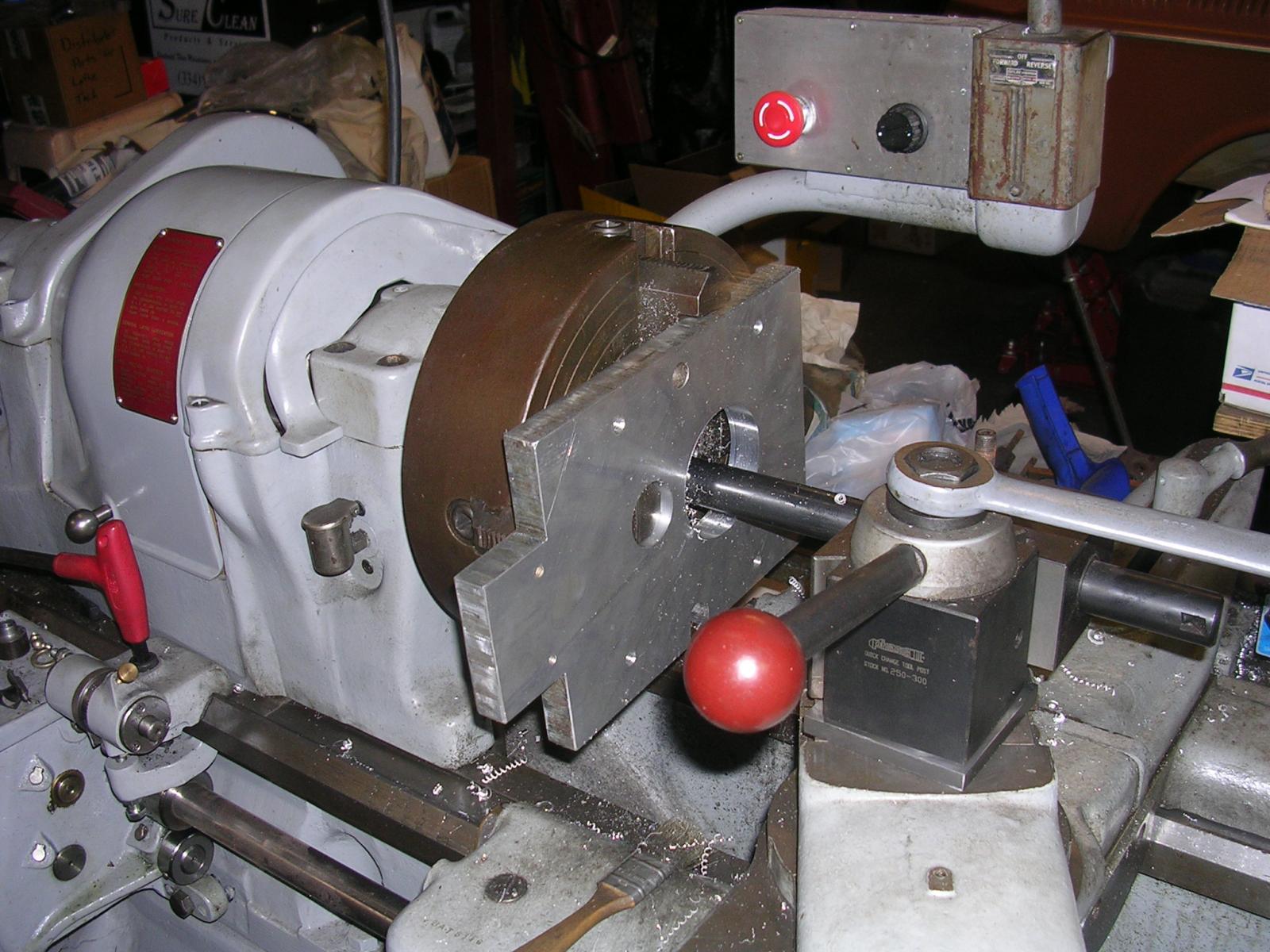

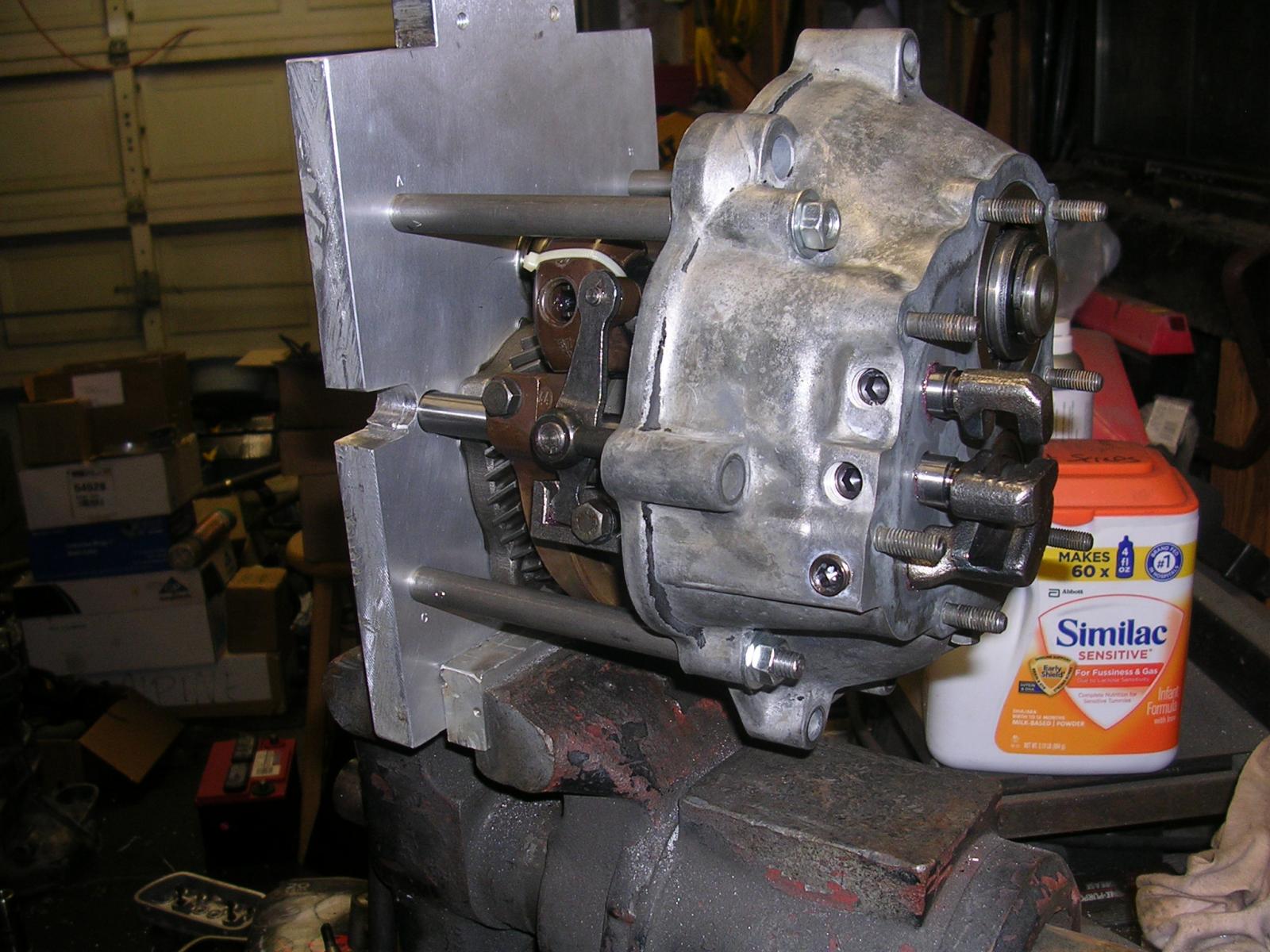

I had the parts, I saw the pictures, then realized I really did need that jig. Thanks goodness I didn't need that funky socket for the pinion nut, I'd have had no choice on that one. But after looking at that jig, and figuring out what I needed to do, I decided to build one. I found a chunk of aluminum, took some measurements, and started boring some holes:
I made some standoffs with threaded ends. Don't tell anyone, but the threads are SAE, not metric. Shhhh.
Guys who have done this before will notice that I messed up. I didn't realize it until I had made it to this point:
I could have fixed my jig, but I was tired of messing with the transmission and really wanted to finish it. I just eyeballed it, and called it good. We'll soon find out if it works or eats itself. I doubt the world will end.
Nonetheless, I was glad I pulled it apart. It was filthy. It also had a bunch of water in it, I guess. If you don't believe it gets cold in Alabama, tell it to the chunks of ice that came out of the final drive area:
I stared at that thick, milky-looking, solid below the ring gear for 20 minutes trying to figure out if it was part of the case or not.
And no, I did not adjust backlash or bearing preload at the differential. One look at that funky pinion depth tool and I decided that if I wanted new gears, they would come with a rebuilt trans. I just carefully put it all back together with the original shims. Again, it may work fine, or it may lock up going down the road. I've experienced both, so I should have no problems identifying either situation.

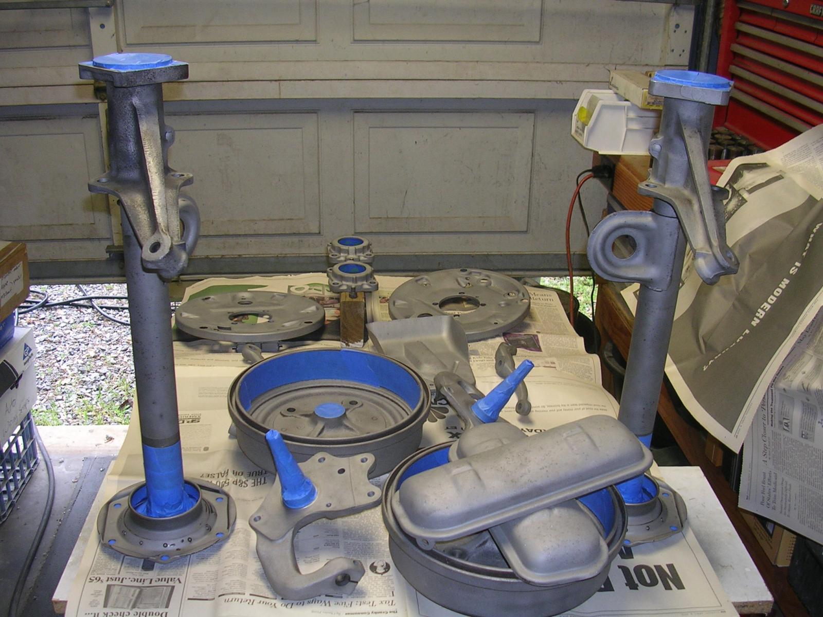

I did build one other tool, to keep me from having to beat it with a hammer:
Ok, kids! Who can find the parts that don't belong in this picture:
With paint:
And finished:
