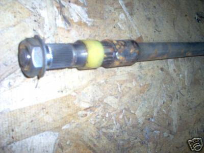

Disassemble all parts to adjust the steering shaft play on my SB 1973, I have new bearing, seating ring and plastic bushing, now need reassembling the steering column, but I have four important questions:
1.-I have the same parts as shown in the photo, important parts are missing?
2.-bearing is inserted into the steering head, but has only one position or reversible?
3.-seating ring is inserted to the bottom of the steering shaft, but in which position?
4.-plastic bushing is inserted at the end of the metal bushing to adjust the shaft play?
I just hope they can help to avoid mistakes and finally eliminate the shaft play.

I appreciate your help baxsie, I have experience in mechanics, rebuilt my engine and all the rest of the car myself, but my problem is can not find information on the web for steering column ...... If anyone has a link that shows the detail of the parts would be great.
I also know that there are two or more types of bearing system in the steering column of one of the old type (also Brazil) that uses a spring to pull the bearing and parts for eliminate the slack.
Unlike in superbeetle (also beetle 70 approx) I think the spring was removed, only uses a plastic bushing that fits the slack.
The pictures show my actual parts.....but the position of the seating ring (photo) and plastic bushing is correct?? not missing anything?
I hope those who have more experience in the same type of steering column can contribute their ideas.

In my car, a '74 standard, the assembly went together like this.
1: The little bushing on the far right (split in the picture) goes on the steering shaft first, with the raised shoulder against the steel block on the shaft.
2: The bearing fits over the bushing snugly, taking up any up/down/side/side slack.
3: The plastic bushing (second from right in photo) went over the bearing and held the bearing tight on the shaft. It takes a bit of force to set this bushing.
4: Insert the steering shaft into "steering wheel end" of the column. The steering shaft should have the bearing installed on it and the bearing should slip into its recess in the ignition housing without any fuss.
5: The circlip (bigger than the one in the photo, about the same outer diameter as the bearing) was an expanding type clip that fit into a groove in the ignition/bearing housing. Once the steering bearing is in place, the circlip snapped in over it and held it snug in the housing.
6: The turn signal/wiper switch assembly and lock cylinder/trim plate can be installed now.
7: Put the steering wheel on, then the washer and the nut. Don't torque them down yet, because you'll likely move the steering wheel around on the splines to get the steering wheel centered with the wheels again.
Hope this helps!
-Austin

Thank you 19-VW-74,
then according to the picture the pieces are in place? without springs?....
The strange thing is that the plastic bushing quite loose to try to lower it to the bottom (bearing), and according to your description "It takes a bit of force to set this bushing".... purportedly is mounted on the upper little bushing steel ring to abut the bearing??... explain better please?
