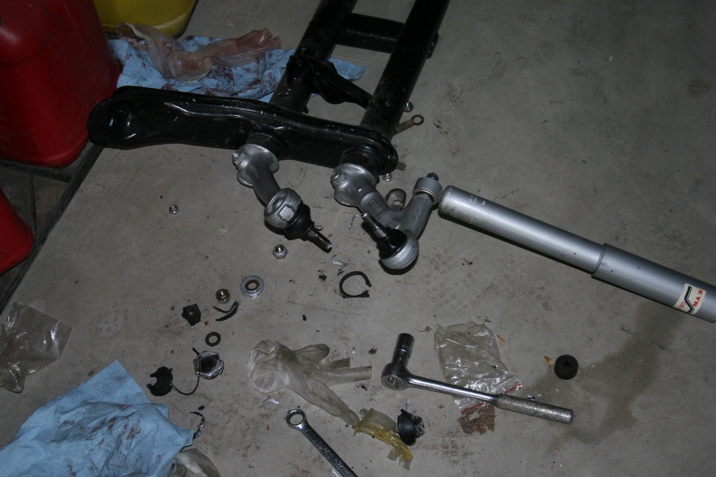

So I bought a "rebuilt" beam from Mofoco in 2008 for the decent price of $230. It took about a month to get to my house in WA from southern CA... apparently they were out of stock at the time that I paid for it, but it was still available on the site... (why is that so common these days?) Anyways, after a month and several phone calls, it arrived. I pulled it into my garage and started pulling it apart and inspecting it. It had a sticker on it that said "Remanufactured in Brazil"... but this "remanufactured" beam left much to be desired. It had two shot ball joints, 4 shot ball joint boots, torsion arm seals made out of a rubber hose, bare metal in several spots, and the disc brake spindles had been so beat that the lock-nut threads were shot and the bearing seats were uneven. Needless to say, I had to re"rebuild" it Rolling Eyes .
So What I did was replace the torsion seals with genuine VW, press out the two shot ball joints and press in new ones, and replace the other two shot boots with the CIP1 ball joint boot kit. I also bought a complete disc brake conversion kit on ebay for a steal: $185. I used the spindles in the kit because they were in better condition than the ones on the Mofoco beam.
Here are some pics of the installation of the CIP1 boot kit:
In the second pic you can see the shot boot on the upper torsion arm and the new CIP1 boot on the bottom torsion arm. I don't recommend the CIP1 ball joint boot kit... it cost me $23 for 4 boots w/clips, but in a month all of the boots were completely split and leaking grease. The car hadn't even moved yet. The boots disintegrated while just sitting on a parked car in my garage in the heat of the summer. For $23 I could have bought two high quality ball joints and never have had this problem... you live, you learn. Rolling Eyes
-Austin

Looking at the (new) bug in my driveway makes me sad as my last one had to be parted out (as in SOLD) because I got in over my head and lost motivation. Sad
Thanks for the feedback, man I appreciate it! I can't back down now though... I just dumped over two grand in parts this week. The body is in for paint right now and the chassis is almost done so I'm ordering all the parts for the fun part - reassembly. Cool
