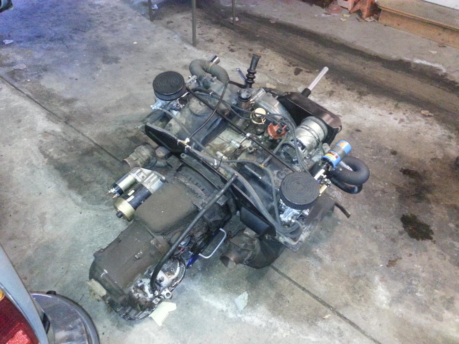

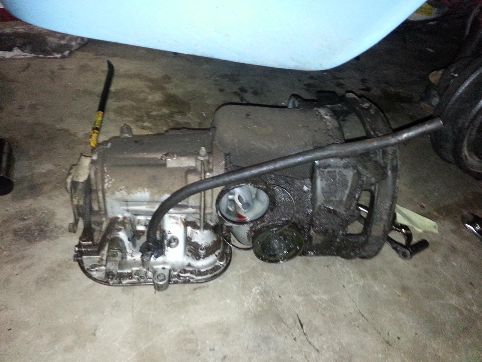

PostPosted: Thu Dec 12, 2013 5:32 pm    Post subject: Reply with quote
Got everything removed this afternoon. Only took an hour and a half. Pretty easy job. Thanks for the tips of just removing the motor and tranny together. It was easy as pie. Now I just need to figure out which transmission to go with....I found a guy in town with 5 auto units, but he wants a mint for them.
I have a lead on a couple of others too. I just have to get one sorted out and I will be good to go.
Here are a few pictures for the fun of it.

PostPosted: Fri Dec 13, 2013 7:36 am    Post subject: Reply with quote
one4house wrote:
I should be dropping the motor and transmission today. I keep hearing talk about "early" vs "late" automatic transmissions. How do I tell the two apart? What numbers am I looking for on the unit I am going to buy this weekend? Are there any auto units I should avoid?
I also heard that the units out of squarebacks were different than the units in fast and notch. How do I tell this? I have a lot of questions.........
Here is a reply on the type 3 mailing list that Jim put up for me.
All credit on this goes to Jim A. I don't know if he is Samba or not.
"> I keep hearing of "early" vs "late" units. How do I identify one vs
> the other? What part numbers am I looking for? Where are the part
> numbers located?
There are actually 3 generations:
'68-9 had 5-bolt flanges around the output shafts. These were
eliminated in '70, making the construction slightly simpler, less
leaky, and more reliable. Very early ones came with torque converters
that had fewer, larger cooling fins. Those are less desirable, but
the later TCs are an exact replacement.
'70-1 lacks the 5-bolt output flanges and has a vacuum modulator with
a diaphram section (the large diameter part) that's less than 1/2"
thick. These are the best units in my opinion, but that's based on
very little data. If your car is a '69-71, this is the style you'd
hope to find.
'72-3 looks just like the '70-1 except that the vacuum modulator has
a diaphram section that's more than 1/2" thick. If your car is a
'72-3, I hope you find one of these.
On ALL of these ATs, it's important to know that the vacuum modulator
is located in a place that's very vulnerable if the AT is sitting on
the ground. If the VM gets bent, you may be able to straighten it,
but it's likely that it will have to be replaced. And if you have to
replace it, it MUST be adjusted, which is a fair bit of work.
> I also hear that the automatic unit out of a Squareback is unique.
> What is the difference? Again, what am I looking for?
Fastback and Squareback ATs are the same, but they are different from
all other VW ATs. Don't try to make do with a different version.
> Any words of caution anyone has? I am pretty much stuck with this
> unit, but I want to know what I am getting. It can help on the price
> negotiation if I have more knowledge.
If it's been dragged around on the ground the VM is toast. The late
VM is expensive, and you can't replace it with the early one. Try to
get it with the TC, but pull the TC off to check the snout on the
tranny for wear where the seal seals. Polish that snout before you
reinstall.
There is a dome cover on the upper left side that is sealed with an
O-ring. Replace that O-ring before you install the AT. It's just easy
to get to then, and that O-ring always needs to be replaced. I have
the O-rings or you may still be able to get them at a VW dealer.
In general, our ATs have been very reliable. The most common problem
is that leaky o-ring and leaks around the output shafts that leave
the final drive dry and ruin the differential gears. Note that this
unit takes both ATF and GL-5, so make sure to drain and fill both.
If you take off the AT pan to check it out and drain the fluid. Don't
overtighten the pan bolts. Tighten to the spec torque, wait 5
minutes, tighten again, wait 5 minutes, tighten again. I STRONGLY
recommend a set of Belleville washers here to replace the split ring
lockwashers that VW used. The Belleville washers will prevent
deformation of the pan, as long as you don't overtighten the bolts.
It's a bit of extra work, but you might be wise to remove the output
flanges and replace the output seals before you install an old unit.
If it's been sitting a long time, there could be rust there that
would quickly destroy the seals and lead to oil loss and failure of
the final drive.
When you go to install it, pull the TC off and check the inner shaft.
It will pull out and you'll want to spin it in your fingers as you
install it to make SURE it's all the way in. Then install the TC. The
TC isn't in correctly until the stump in its middle is flush with the
mating face of the tranny. Check it with a straightedge. Make SURE
this is correct BEFORE you mate it to the engine."
I just wanted to add this in case anyone else was wondering the same thing I did.

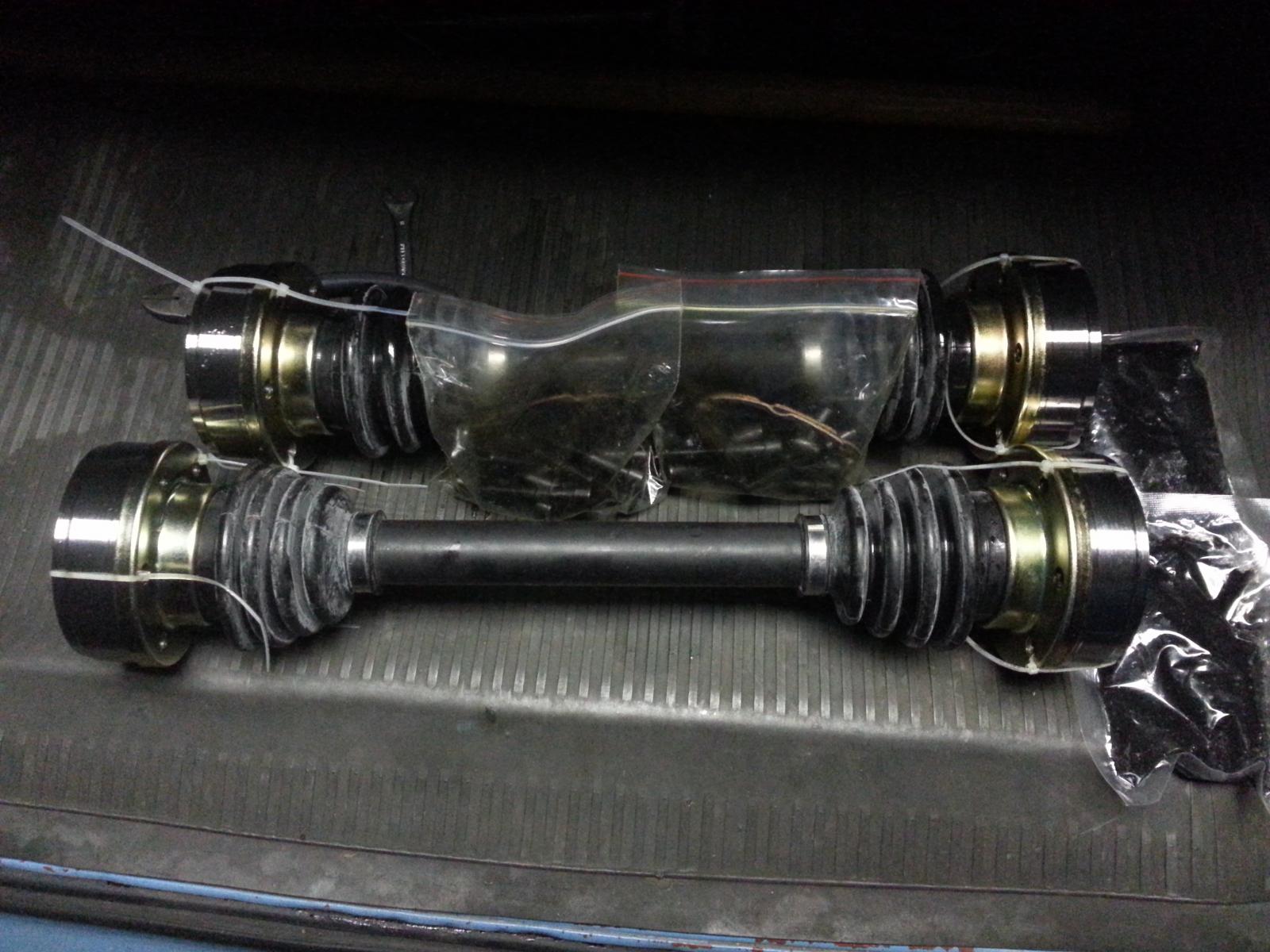

PostPosted: Thu Dec 19, 2013 6:27 pm    Post subject: Reply with quote
Since I pride myself on "learn from experience and take note of advice" I decided to go ahead with the "cheap Chinese cv shafts."
I will save my stock CV shafts and rebuild them. They can be a shelf item if needed in the future or something I sell if these work out like I hope they do. Here are another sets of pictures for prosperity sake.
https://www.thesamba.com/vw/gallery/pix/1148636.jpg
Now if I could just find a transmission to connect them to.
So they had the short axle in stock? Good to know IF I ever decide to narrow the rear of my MT IRS car. Twisted Evil
Bob 65 Notch S with Sunroof

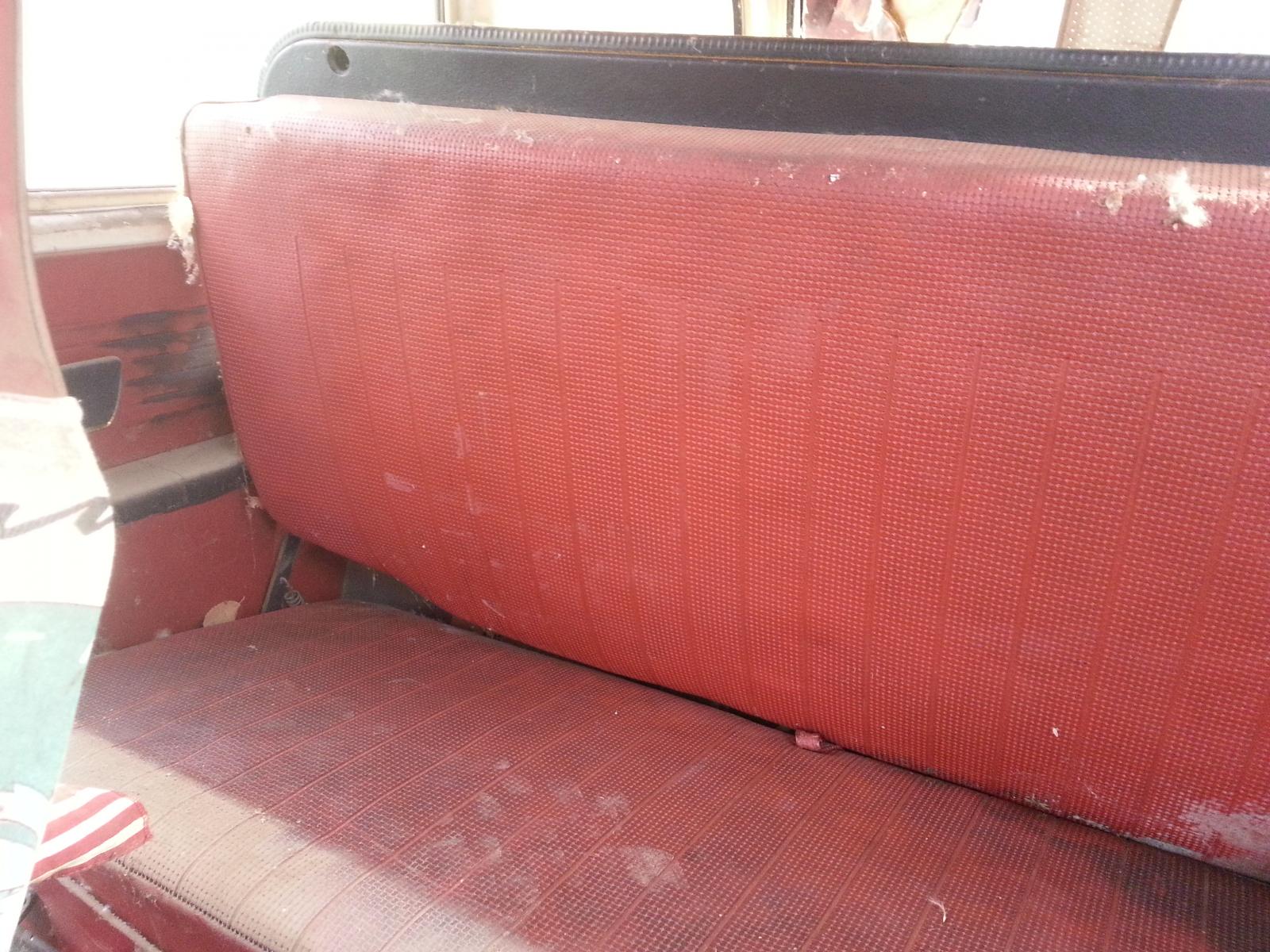

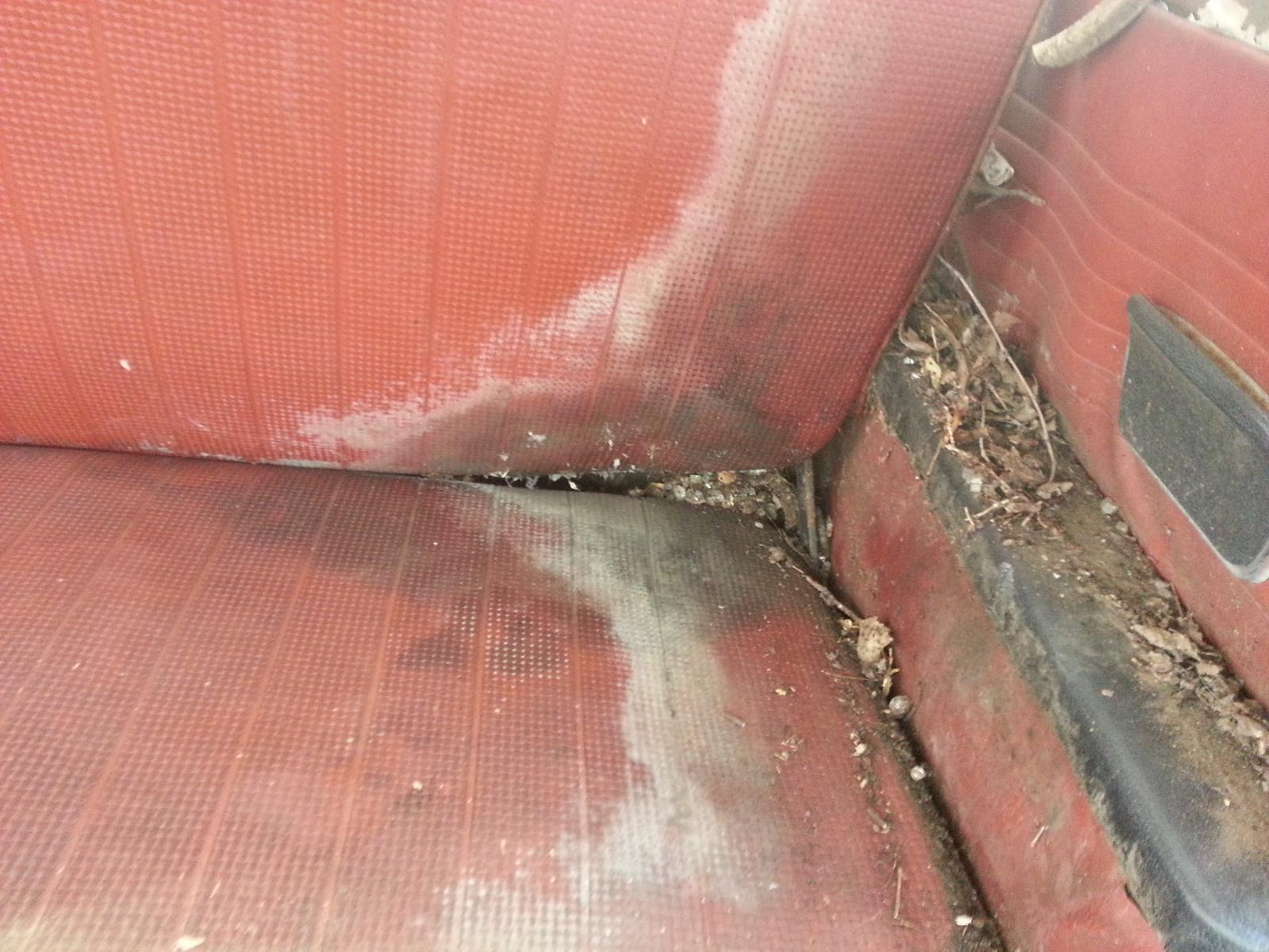

Who out there knows the tricks to restoring seats?
I found a seat that had some issues and I want to know if there is a chance to fix them. One of the Windows was knocked out and they're are some mold issues. What do you think?

PostPosted: Sat Dec 28, 2013 4:38 pm    Post subject: Reply with quote
Use rubbing alcohol to kill mould.
