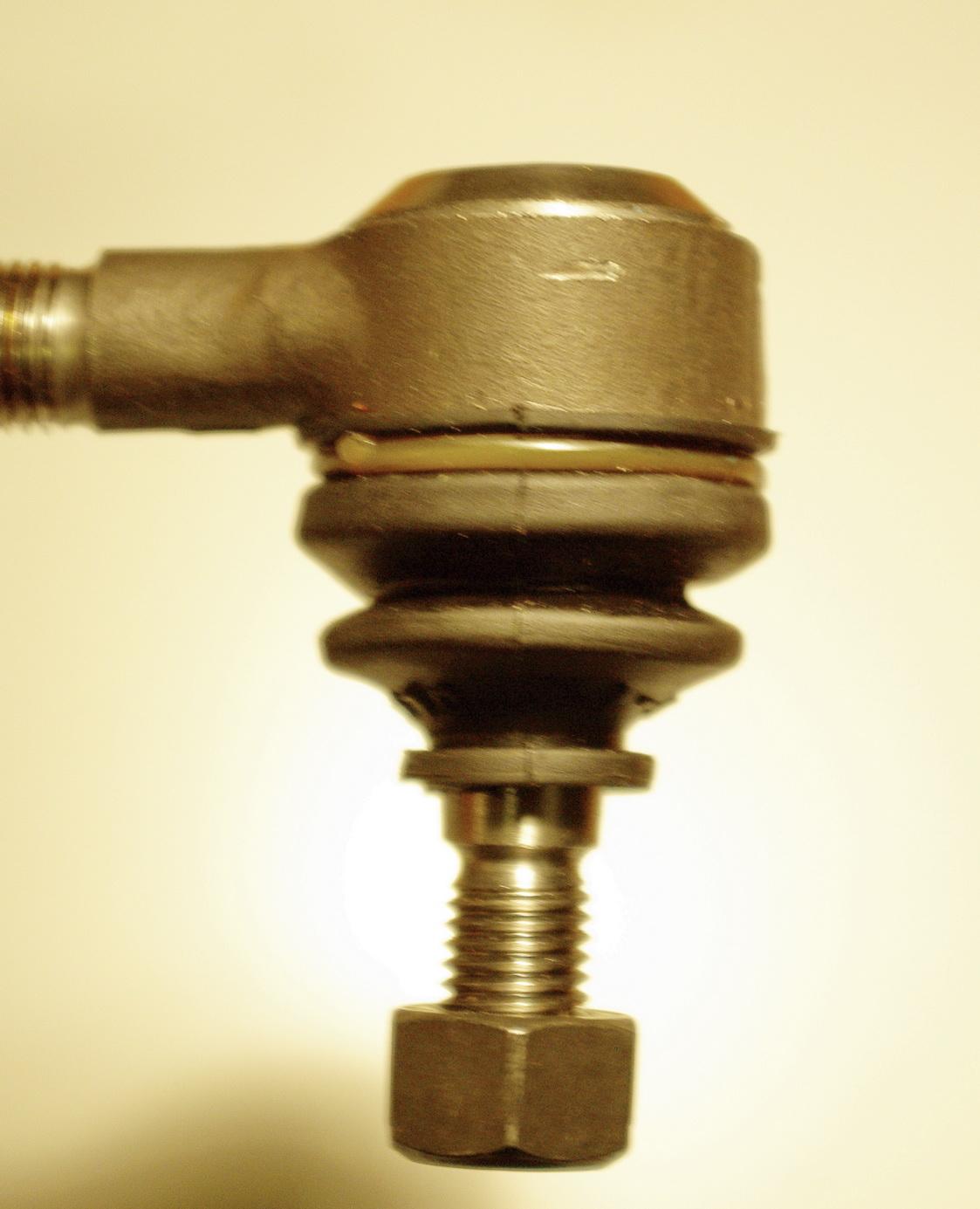

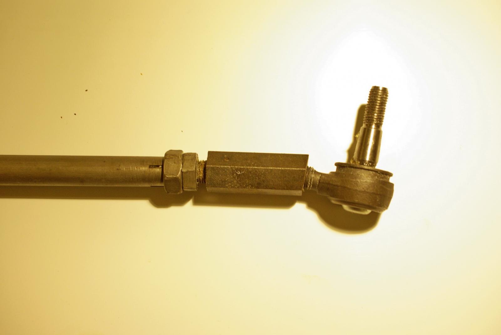

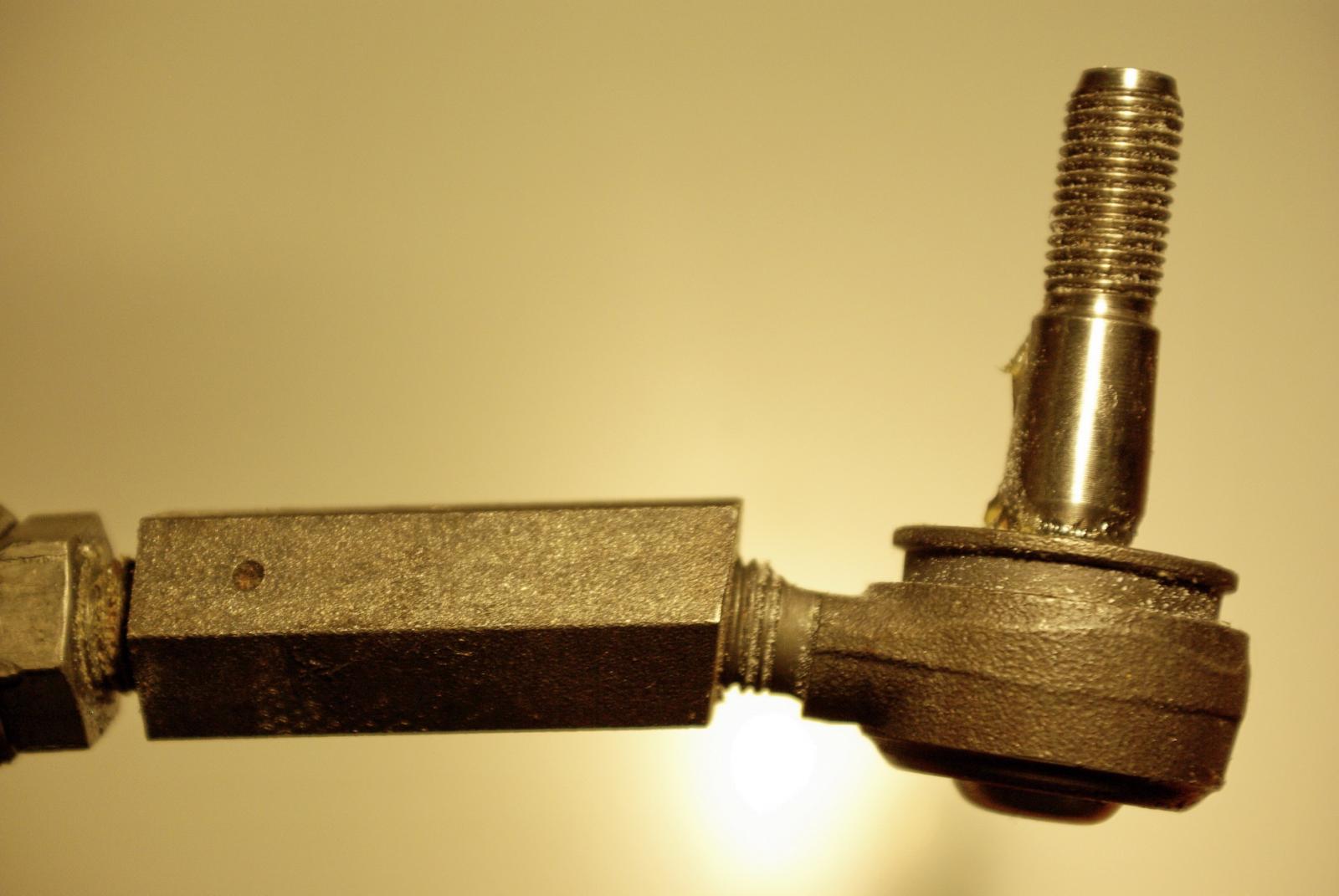

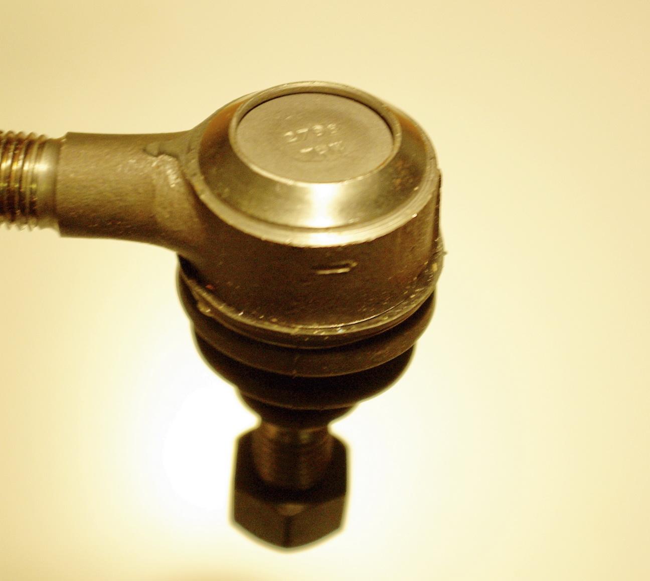

Here are a few pictures of an alternative way of getting the 9 degree tie rod end. This could easily be used for the T-34 and Porsche 912 20 degree tie rod end but you would probably go to 7/8"-1" hex bar.
The complete tie rod with adapter:
End detail
the inner end on here right now is just the Flennor for fit. It has not been pinned yet
Back cap construction detail of the superb NOS TRW tie rod ends I have for both ends of these rods
Side detail with boot. Nice boot.
Sorry for the crappy pics. My lighting set up and photo backdrop space is busy right now so I just snapped these on the fly. Ray

raygreenwood
Joined: November 24, 2008
Posts: 23497
Location: Oklahoma City
raygreenwood is offline
PostPosted: Fri Oct 17, 2014 6:38 am    Post subject: Reply with quote
Thank you. Did you buy any of the 9° bent ones....or just the straight ones?
Quality on every company's joints is going up and down. The Meyles....I dont have a real grip on for current quality. I hear excellent and not so good from all over the place. If you could post a couple of detail pics it would be nice.
I am slowly putting together a tie-rod and balljoint "quality" and identification chart in pictures.
Ray

Ray, nice job on the adapter, very well done. Applause

raygreenwood
Posts: 23497
PostPosted: Fri Oct 17, 2014 7:42 am    Post subject: Reply with quote
Thank you! Some....I figure think its stupid and unecessary....but being that I have a car that no longer has shocks, struts or ball joints manufactured for it and quality and tightness of joints makes a huge difference on this car.....and I have bad trouble getting quality joints at all (much less even getting 9°bent joints)....I figured it was about time.
Seiously...I keep telling vw people....especially type 3 and somewhat the bus guys....start either collecting basic parts as they are available or start looking for answers.
I wasnt so worried about tie rod ends just because I had a hard time finding a decent 9° bent inner. ......but when I started hearing from actual manufacturers that specialty inner tie rod ends like that....are no longer really on their production list......because there are virtually "0" modern cars that do not have power steering or rack and pinion.....both of which use a totally different type of joint......the warning bells went off in my head.
Outer tie rod ends should be no big deal. Even if our exact part #s dry up....the taper on the pin is pretty standard and power steering and rack and pinion use such virtually identical outers that we could probably always make something available work.
As far as quality.....thats a different thing. Aside from third world manufacturing issues, virtually all of the big names have outstanding construction and materials. However....the internal designs have changed a bit. The mfgs are starting to make everything the same type internally. The pattern is much lighter tension on springs, looser turning torque etc.....but more precision so that each joint is virtually identical. This is for the modern steering systems. Older cars like ours that need tighter joints to control vibration and movement may suffer. Ray

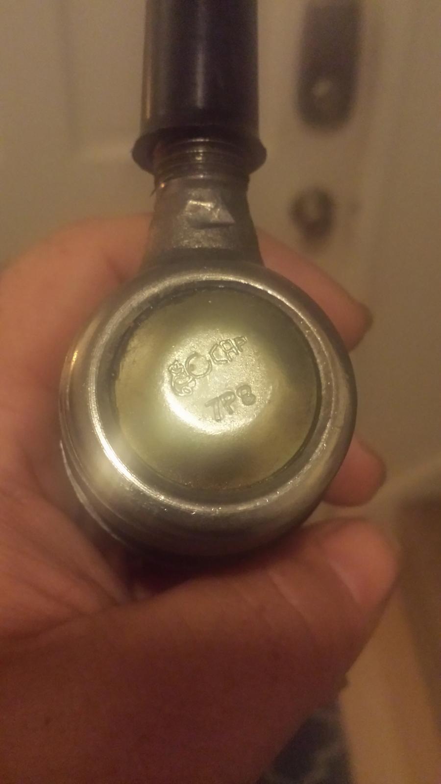

as I mentioned in my thread, I was able to score a complete NOS assembly, left tie rod and both inner and outer ends.
but look at what I took off. The end is angled the wrong way. And, this was the outer, the inner was straight (and actually in pretty good condition, the outer seen below was like playing with a rubber band it was so worn)
raygreenwood
Posts: 23497
PostPosted: Thu Dec 11, 2014 10:35 am    Post subject: Reply with quote
You should section the outer one with an angle grinder. if its like a "rubber band"...I can almost exactly tell you what you will find inside.......AND....if I am correct...its one of the reasons I would not buy NOS joints that are REALLY NOS.....meaning say.... pre-80's build or original 1960's/70's VW stamped items.
What I found inside of the original 1971, 1972 and 1973 joints from my 412 (which are the same for type 3)....is that the same incorrect nylon 6 was used that was also used in the centerlink bushings of super beetle and type 4 cars.
It absorbs moisture with age and literally turns to a mush. It can do so even on the shelf without being installed to a certain extent because it absorbs moisture and solvents from the grease inside.
If so....what you have can have a short life span. If its 80's on up it usually has nylon 12 inside and will last for eons unless you mix grease types that are incompatible and then get an oxidization reaction that can start affecting the nylon.
All of this is part of why I started getting picky recently about what quality of tie rod ends I was getting. Ray

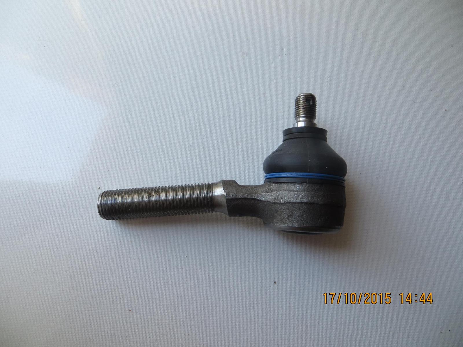

PostPosted: Wed Oct 21, 2015 1:45 pm    Post subject: Reply with quote
I have some NOS early model '62-'67 Type 3 left inner angled tie rod ends.
These are hard to find and these are original VW parts, no aftermarket.

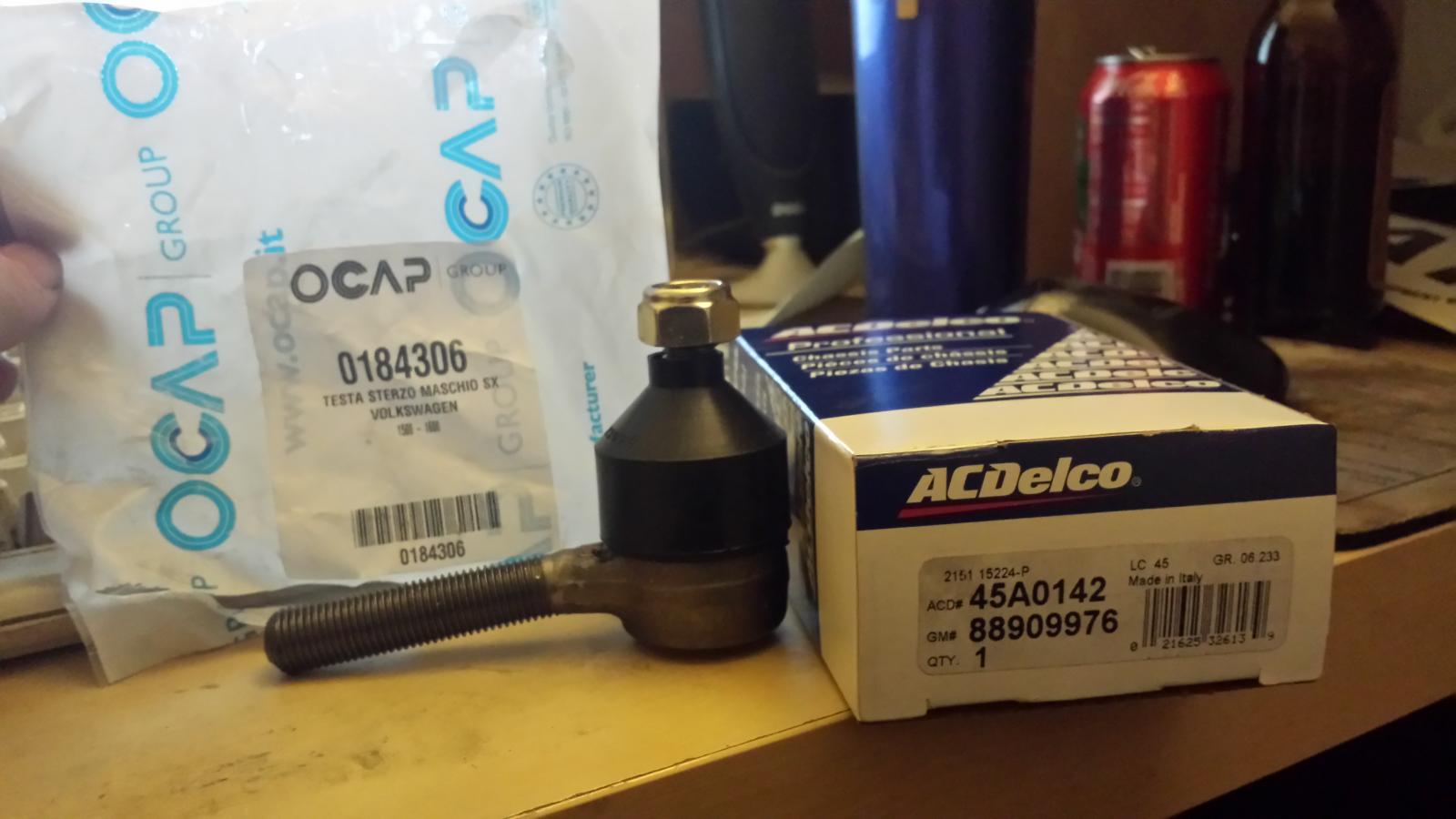

Bumping an older thread.
Just ordered a full set of suspension parts for my 1970 Type 3 from RockAuto.com.
This is what I received for the left-inner tie rod end.
Don't know if I just got lucky with a NOS part, but for what its worth...
Only paid ~$20 for this one.

PostPosted: Wed Mar 09, 2016 9:56 pm    Post subject: Re: Left inside tie rod end.... Reply with quote
Did it come in the AC Delco box or the Ocap bag?
If you`re going to do something, do it right.
raygreenwood
Posts: 23497
PostPosted: Wed Mar 09, 2016 10:23 pm    Post subject: Re: Left inside tie rod end.... Reply with quote
Yes....please.....which one......or was it ocap bag in a Delco box....not unheard of as many companies makes parts for other companies.
Nice score. It would be interesting to see how old the stock is. Virtually no one making these except special order so I am told. $20 is a good deal. Make sure the thread direction is correct. Also if you can please take a picture of the back cap. Thanks! Ray
EDIT:...... ah....I see the made in Italy on th3 Delco box.....which fairly marks it as Ocap. Question is old or new. Good part hopefully either way.

raygreenwood wrote:
Yes, precisely, it was in the Ocap bag inside the AC Delco box. I haven't checked the thread direction yet, but I will. Hoping to be able to get it on the car this weekend if the weather cooperates. I'll report back once I can confirm fitment, etc.
