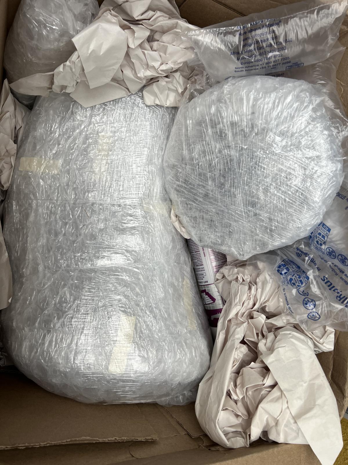

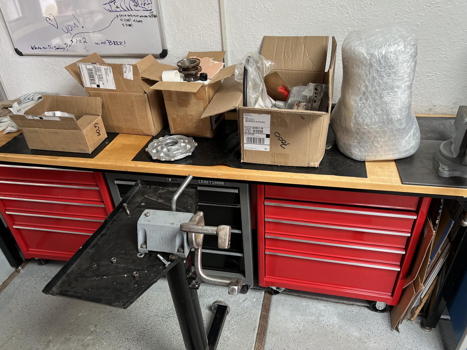

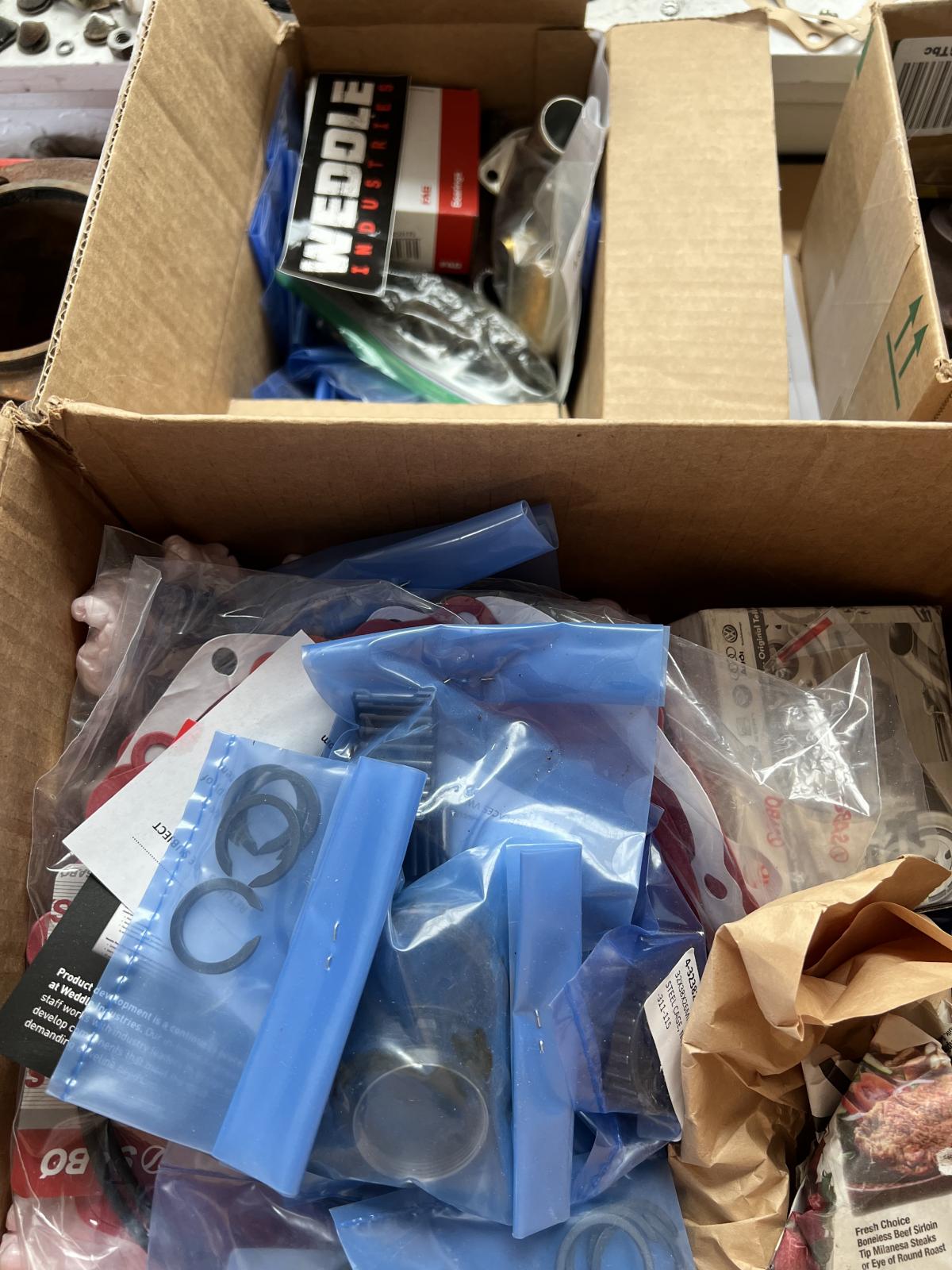

Went to Phoenix and picked up some stuff.

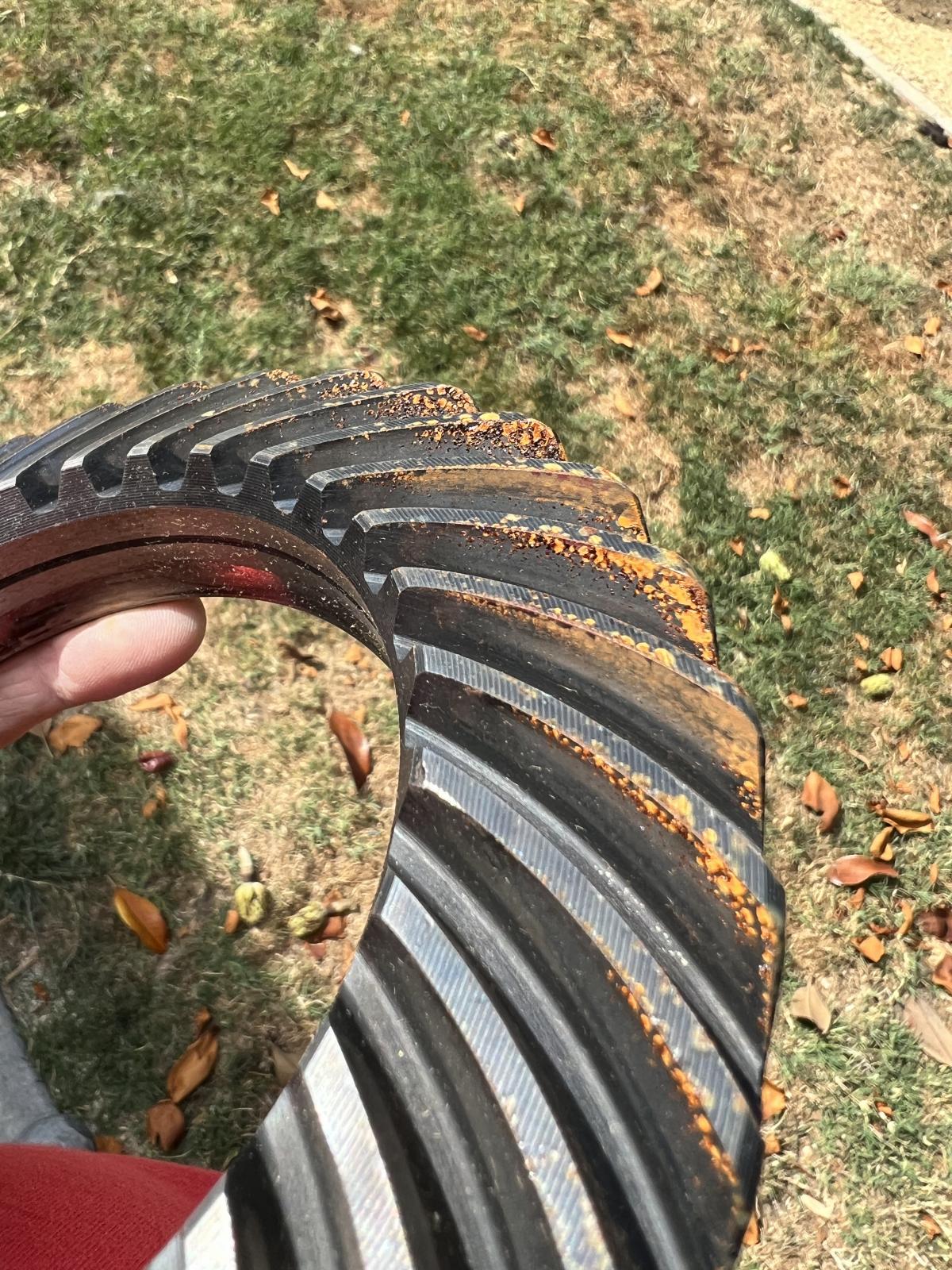

Since the ring n’ pinion is for sure a 3.88…
A Gleason in good shape to match the pinion.
Was looking a bit rusty from years of storage:
Turns out it just wiped off.
Managed to find the diamond Dremel bits shown me by the great Paul Guard:
Did a de-burring on the ring n’ pinion.
Stay away from the contact surfaces!
Finished up with a heavy glass-bead session.
De-burr the de-burring! Very Happy
