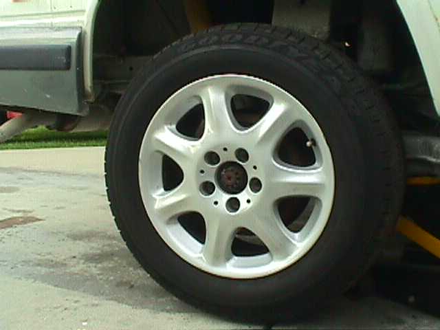

a picture of the wheels from the side i think would be something to add. I have been thinking about what wheels i want. i think this is a great idea. i was thinking of takeing the phone dials off my rabbit and putting those on my van. has anyone put dials on there vanagon?

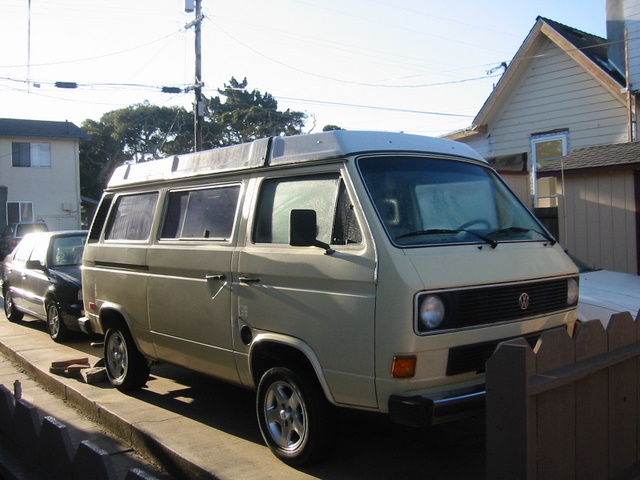

Well, you were calling out for non-stock wheels, which technically mine are not. I have the 15" South African "Carat 2" wheels that seem currently unavailable in N.A.. You could easily get the same look off an Audi A4 or something like that.
I'm sorry to say that i don't know about ETs, and the like, but fitment was a non-issue (aside from longer studs/bolts) since they are made for vanagons. I also have an almost matching spare wheel that is apparently also made for a vanagon.
Sorry for the bad picture... i'll try to update with something better later on.

PostPosted: Mon Nov 20, 2006 9:04 pm    Post subject: Mercedes S class 7.5x16 ET46 wheels Reply with quote
OK, now I have to say something! Those ET46 Mercedes are the wheels I am dealing with. (I got 5 perfect ones for FREE (thanks Klaus) and my brother has them squeezed on his single cab and I like them.) I am "this" close to finalizing what I am going to do to get them to work. I have located a few NEARBY (!!!) big wholesale vendors (makers) of spacers, adaptors and even blank center caps so I can put a VW logo on.
I am fairly sure I am going to use a 20mm adapter. Not a spacer. Spacers mean long threaded fasteners which I do not care to deal with. I read 13mm (1/2 inch) is about as much as you want for a spacer. Plus in order to keep the scrub radius right (so I am told) you want to run an ET in the mid to low 20's for those 7.5 rims. GoWesty uses ET23 on their 16x7.5. I met someone who let another custom adapter vendor make adapt\ers and they made them 3/4 inch or 19mm for this same ET46 wheel. PLUS with that, the center cap should fit. So my ET will be 26.
Where do I buy those sticky round black and silver VW emblems?????
BTW: I am going to use 215/65-16 tires on my raised Westy which sits at 18.25 inches.
Wadda ya think??????
