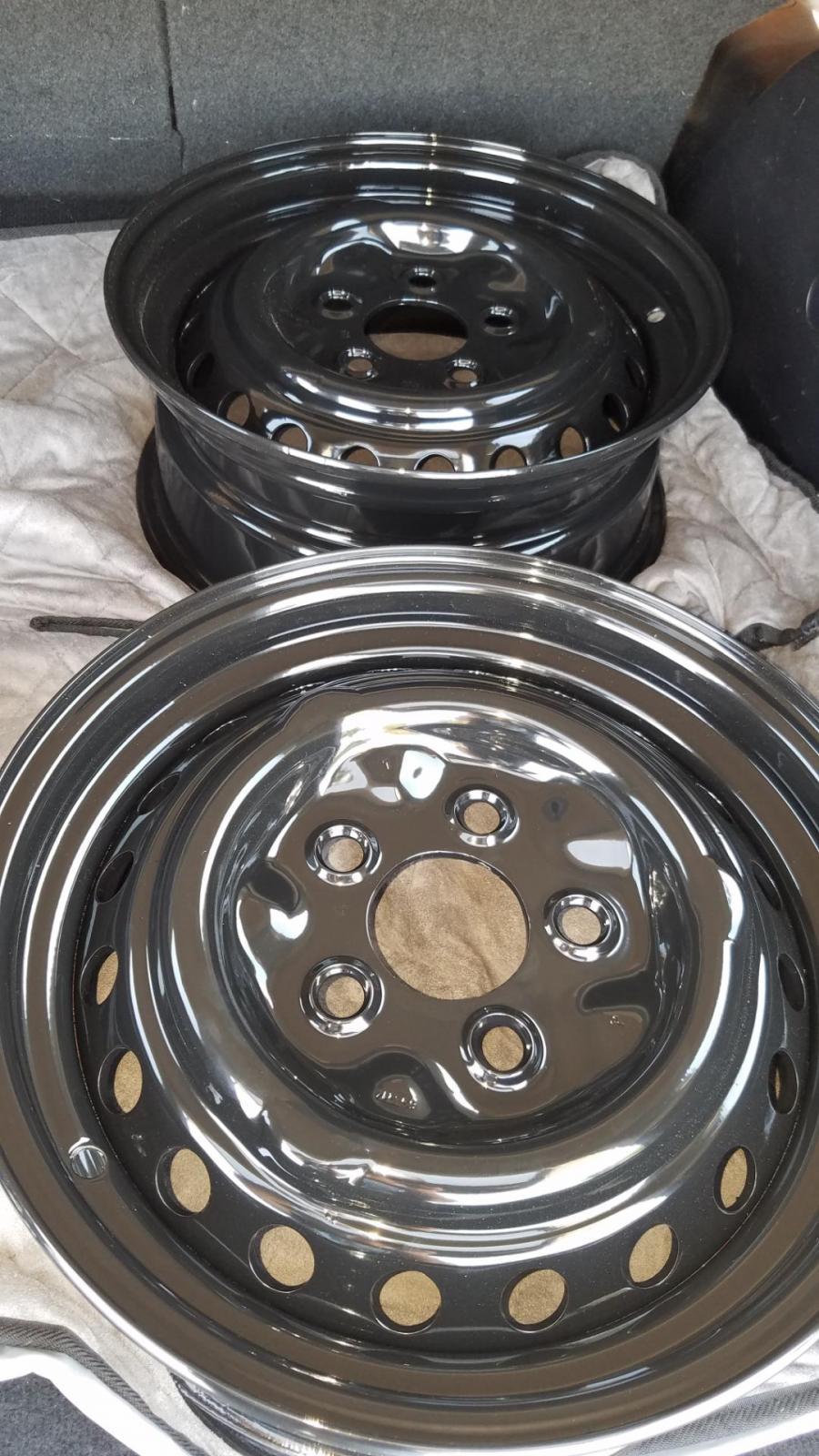

Bringing this back up. I found no pics of rims for differences.
Bus on Left. Vanagon on Right. Correct? Is there a name for that pattern?
I did not know I had 4 vanagon rims. The bus rim was in the spare tire hole. The search started and this topic popped up with no pics..

There should be a production year stamp between the holes.
I think round bore 5.5" wide rim is early 5x112 T2 rim.

Those are '71 only 14x5.5 rims. Slightly thicker then later wheels. I put a set on my '85 before I sold it.

l always thought with the round center hole, they were syncro wheels.
l had a bunch of bays in england, they ALL had the centers the same as the wheel on the right of fredybears picture,

l always thought with the round center hole, they were syncro wheels. IF they are 6" wide.

I found the stamp date.
4/77 1977 Bus?
Since Vanagons were born in 1980. Correct?
4/77 1977 Bus?
Technically you could find Vanagon and Vanagon parts with 1979 production dates if they were an early 1980 Vanagon(My '80 has a '79 production date) but yeah, 1980 was the first MODEL YEAR for the Vanagon.
Either way, if its dated '77 its a bus wheel, not Vanagon.
