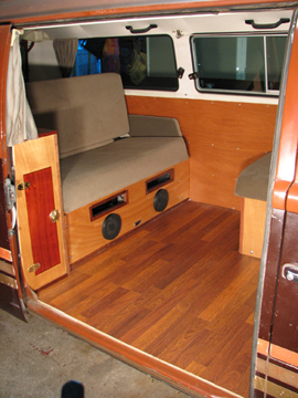

I recently put laminte flooring in my bus.
I just left the original subfloor, because it was in great shape.
Then I put down the foam padding that comes with the flooring installation kit.
And then the floor.
Then I just placed the cabinets in there correct position, drilled holes and secured them with the proper lag bolts. The weight of the cabinets and securing them to the metal underbody keeps the flooring nice and snug.
I wouldn't glue the flooring down because some day you might need to remove it.
- Ben[/img]

Here is an updated pic.
I just used the existing aluminum trim piece. Cut a little off to fit and moved it up on the edge of the floor.
Seems to do the trick.
Just need to polish it up a bit.
- Ben

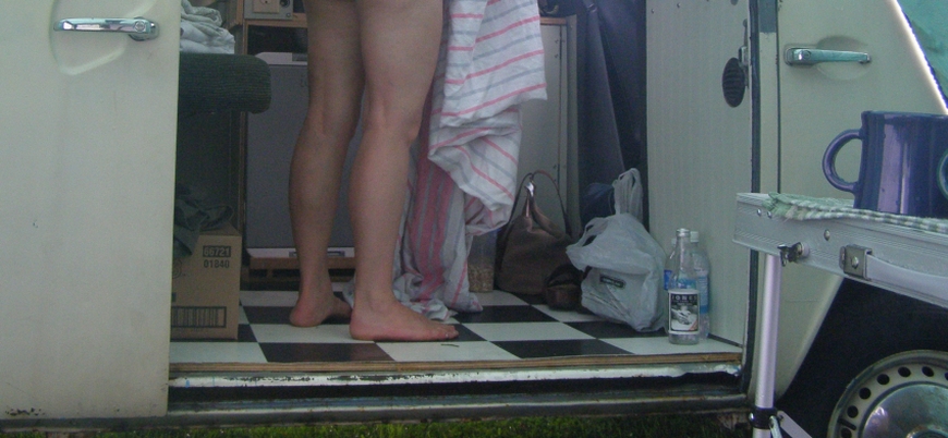

Priority one was to get the stinky, wet particle board floor out of my bus when I got it. It was wet and causing (further) rot in the floor.
After welding up the holes with the assistance of an Alan Schofield replacement panel, I have put down a layer of silver bubble insulation, then loft boards. These come in 14 inch widths and lock together, so it made fitting them in the bus WAY easier. They are however only particle board (chip board). So they needed some protection at the edge (the PO had used duct tape. mmmm nice).
Wickes is a builders merchant here in the UK and I got a length of industrial step edging and a piece of aluminium angle.
I first drilled some holes in the angle and screwed it to the edge of the board, with the angle underneath. Then I overlapped the face of the angle with the step edging after trimming it to fit nice.
I am really pleased with the result. It is extrememly durable because it was designed for a harder life than I am giving it, and it looks pretty stock. A bonus is that the vinyl tiles I laid on the floor butt perfectly up to the lip of the step edging.
Here are some pics.
You can see where I had to trim it to fit around the (left side) sliding door.
No laughing at the sills. These were the work of the PO.
Slightly blurry, but you can see the profile of the main piece (I could not find a bit of the angle to show you)
The final effect.
